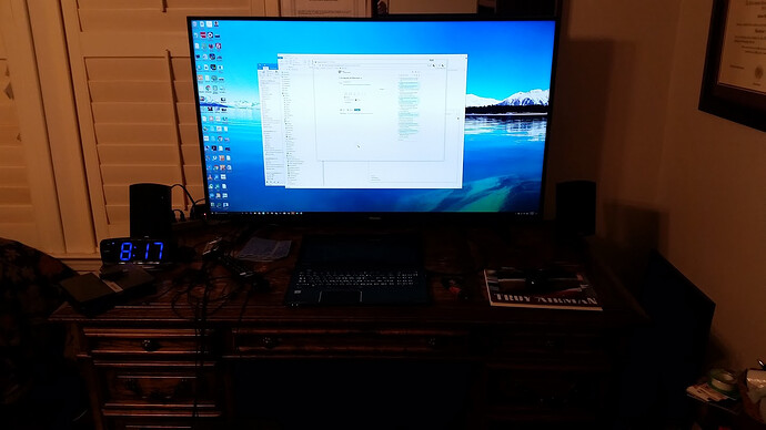

Yes, in order to utilize 4k screen in actual 4k mode, you have to have a video card which has the ability to utilized approx 4000X2000 pixel area simultaneously. I went out of my way to purchase a laptop that does this. The laptop I have was about $900 on ebay one year ago. And it has not come down in price at all, still sells for about the same. It has a 15 inch screen that has the 8 milling requred pixels, but they are so small I find myself squinting and arching my neck painfully to use them. So the 50 inch screen has allowed me to use all those pixels, although I for sure look silly with my face planted in the middle of this huge TV.

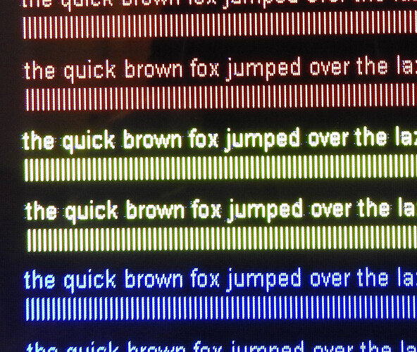

It seems you need to be careful if one of the end uses is as a computer monitor. You really want one that can do 4:4:4 Chroma. The screens that use 4:2:2 (?) do odd things at the edges of windows and to text.
I found a ‘torture image’ and tested my monitor. And yes, I can see the artifacts at edges. So I would say that the image is imperfect. If you are perfectionist beyond belief, this could a problem for you, and you will need to spend a lot of money on a monitor if you want 4k.
On the other hand, my TV, obviously doing 422 to be as cheap as it was, still shows tiny, tiny text quite nicely. I can see the artiffacts, but I can read the text just fine. And only a psychopath would have the text as tiny as I do anyhow. I mean, you never know when you will need to edit 32 Word documents in view of each other at all times…

Well guess what. I started fiddling with the TV settings, as you ahve me quite concerned. I began to wonder if there was a pass through 1:1 setting on the controller since the data from PC is HDMI, so digitally perfect. The problem comes into play when the cheaper processer board does colorspace conversion to the image for color, tint, brightness, etc. controls.
So I began to wonder if there was a pass thru mode. You know 1:1 means there is no fallout to 422. With p;ass thru, I should be able to get 444 by virtue of the fact that I am not altering the image data in any way via the processor board in my ‘smart tv’.
In fiddling with the menus, I noticed that i was in overall ‘power saving’ mode. No wonder the screen was sorta dark. I tried some of the other settings, like vivid and theater modes. They brightened things, made it look a bit different, but still no improvement in artifacts. Then I noticed ‘game’ mode. I tried it, and this time when I switched mode, the screen blanked for second or so. And would you believe it, the artifacts all went away. The torture image no longer tortures my monitor. It is now perfect.
So there is the answer for this cheap TV. Use game mode on Hisense to get 1:1 therefore no 422 conversion loss. How cool! Thanks for heads up!

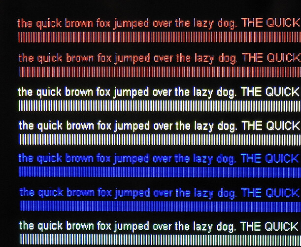

Now here is once I switched the ‘smart tv’ contoller into game mode: It is evidently 1:1 pass through with no colorspace conversion, hence minimal latency (for games!) And check out the improvement in image quality!
BTW, the extra pixel dots you see are blooming on the camera, I think. They are not real. I could get a better shot, its just that it will take a million years for me to understand all of the Nikon craziness I am looking at in the massive manual for this new camera. Christmas is cool, but results in lots of device fiddling afterward…
