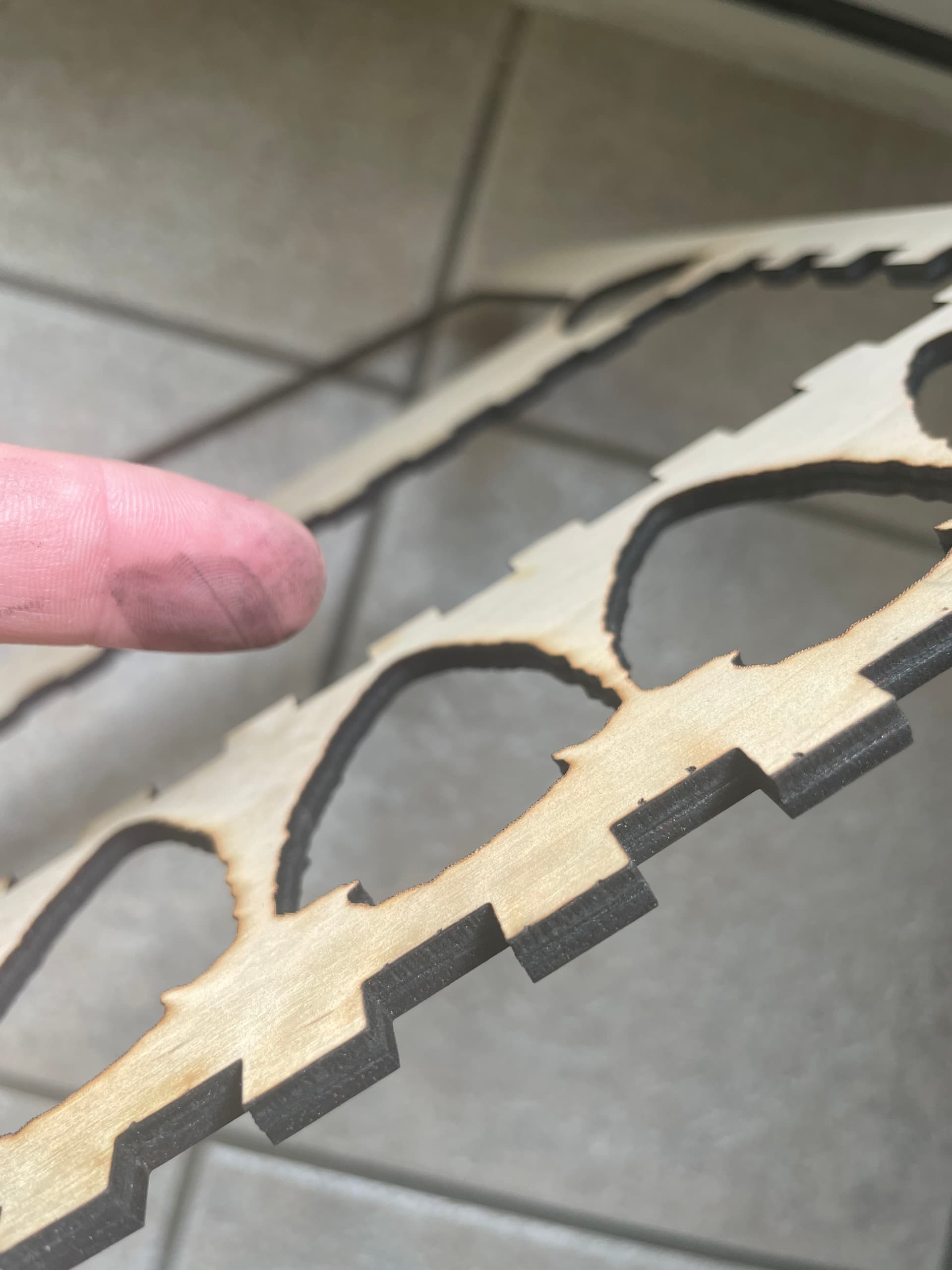

Looks like a 3 ply? I have cut on an Epilog Fusion 24 that my library has in its creator labs and got a lot more charring on the plywood edges than I originally expected. The basswood I cut was cleaner but in both cases, I did the cuts with a single pass.

My last couple of projects:
- Version 1, pre-cleanup
- Version 2, post-cleanup - brushed off then a brief application of something like 330 grit sandpaper.

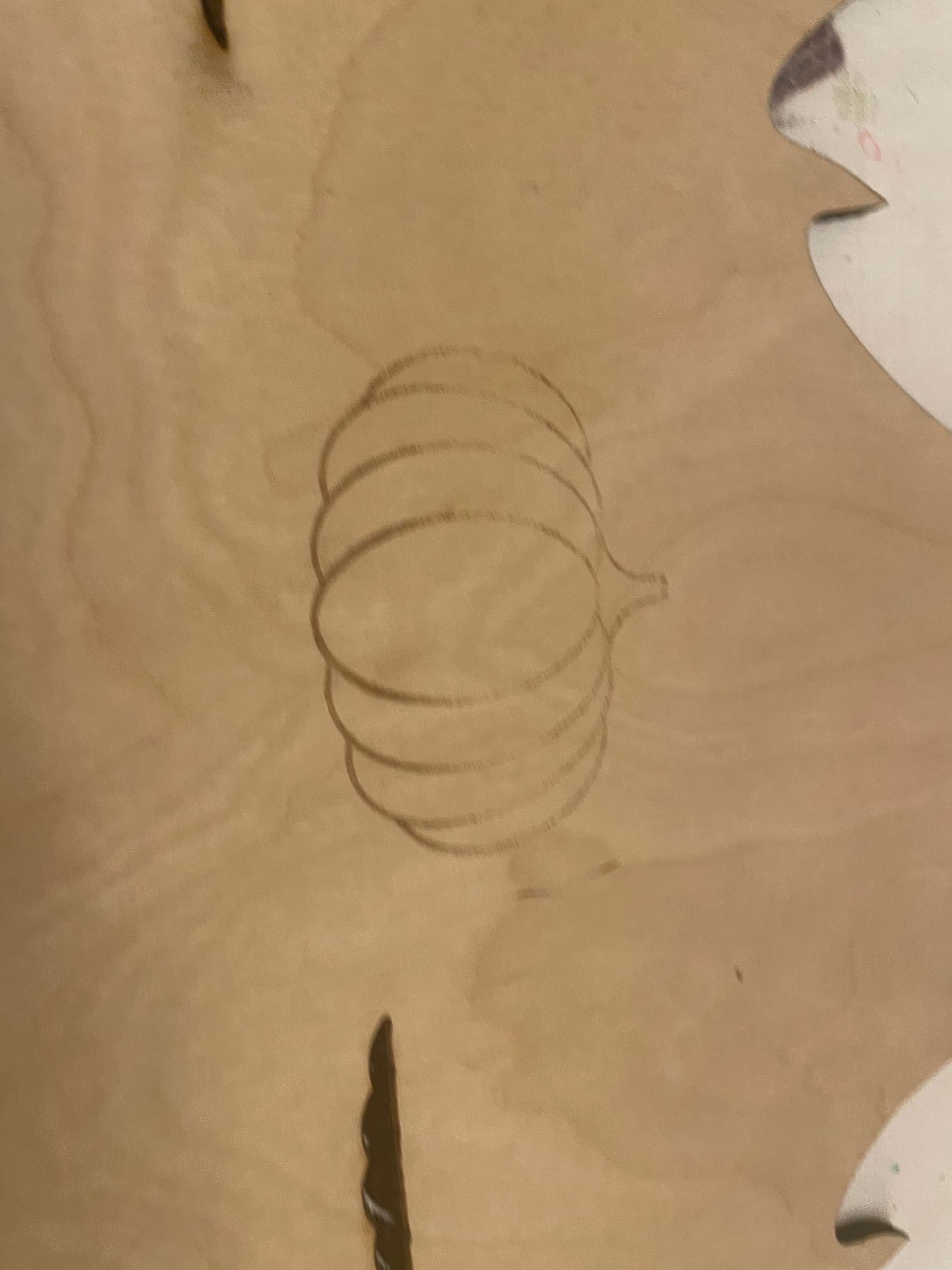

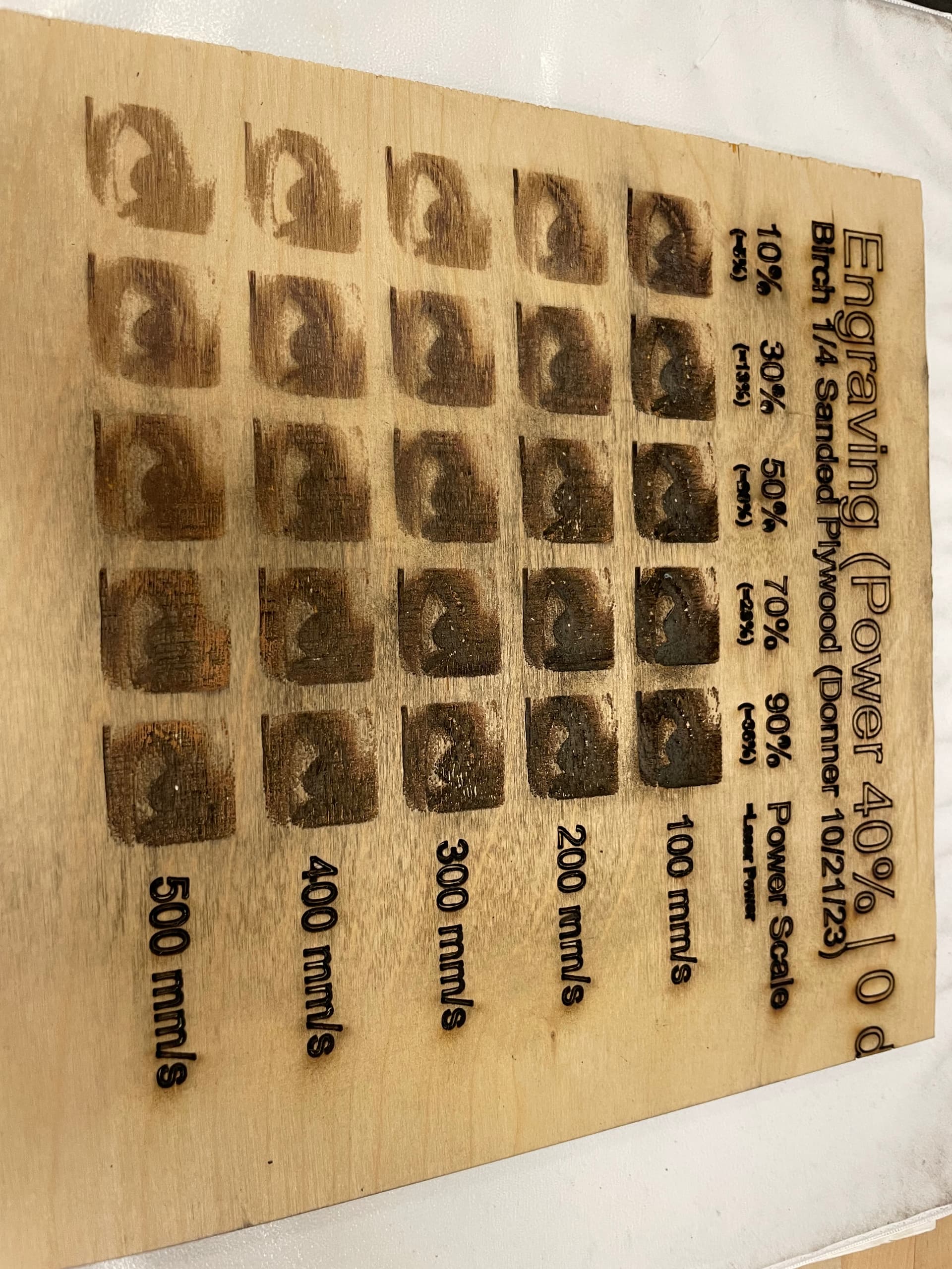

I ran the tests (gradient and the eye image) on Donner tonight to see how fine controlled I could get it. I was surprised - seems like that laser just can’t get quite as fine as the Epilog can.
I ran a stair step with max 80% and max 40% and still dug in way too much. The max 80 test burned through 1/4” sanded plywood. The only way to get fine enough detail was at the lowest end and even then it was lacking.

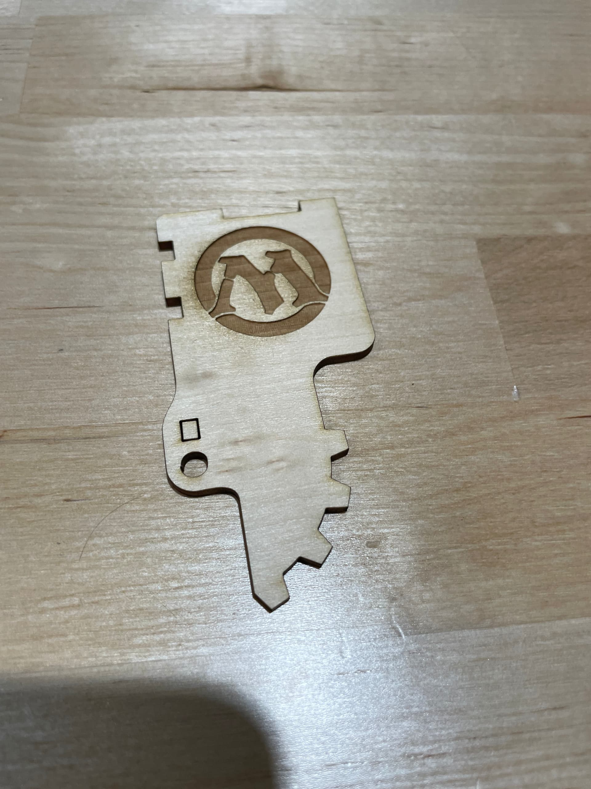

The last 2 photos I cut earlier today on my library’s Epilog for comparison. The wood was thinner but the detail difference is night and day. I guess I’ll have to wait to find someone for Epilog training before I waste any more wood.

The one time I was serious about engraving was with the Epilog Zing. Otherwise on the Thunder my engraving needs are all about lettering or some pretty basic vector graphics - is it legibile?
