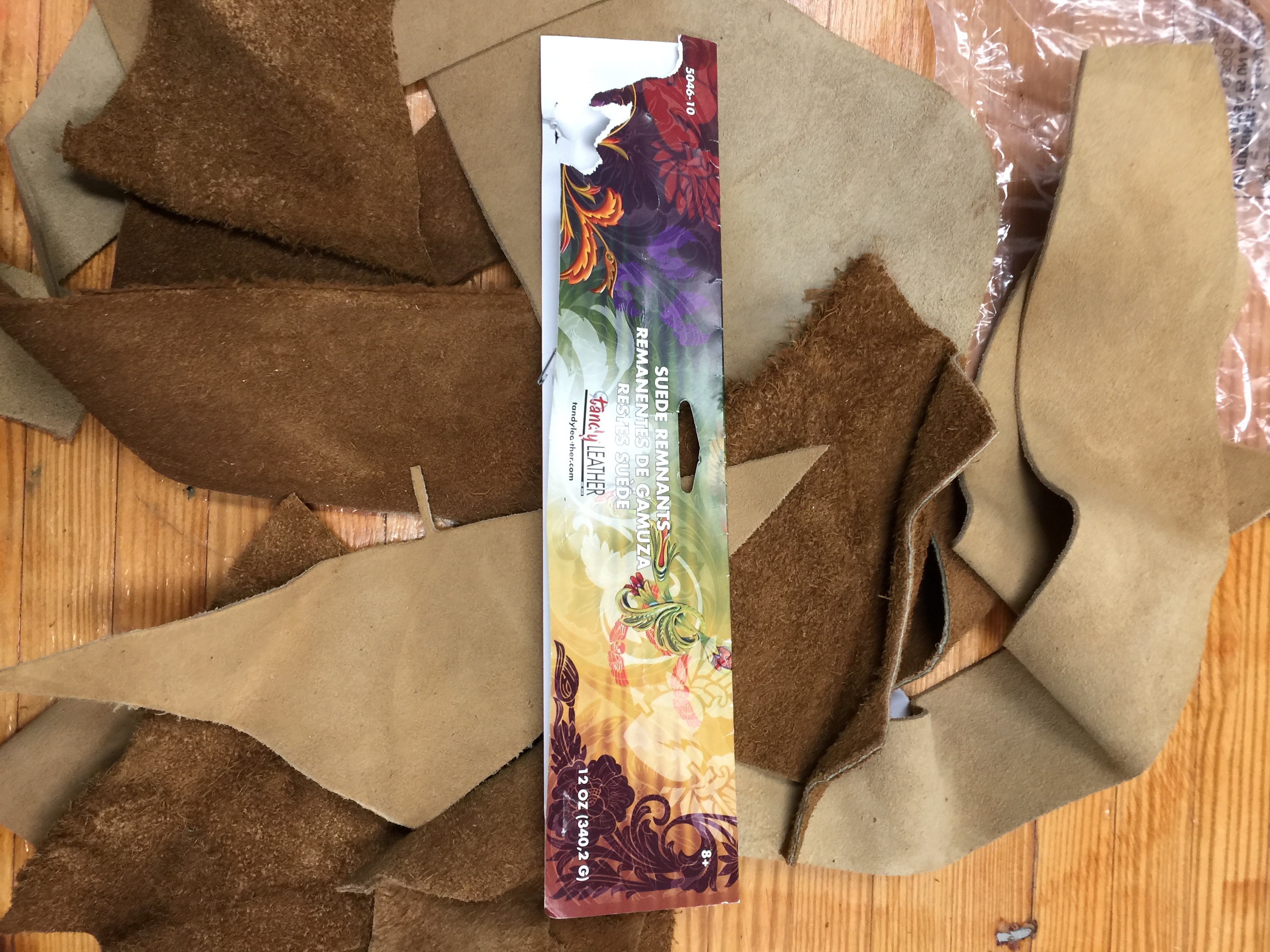

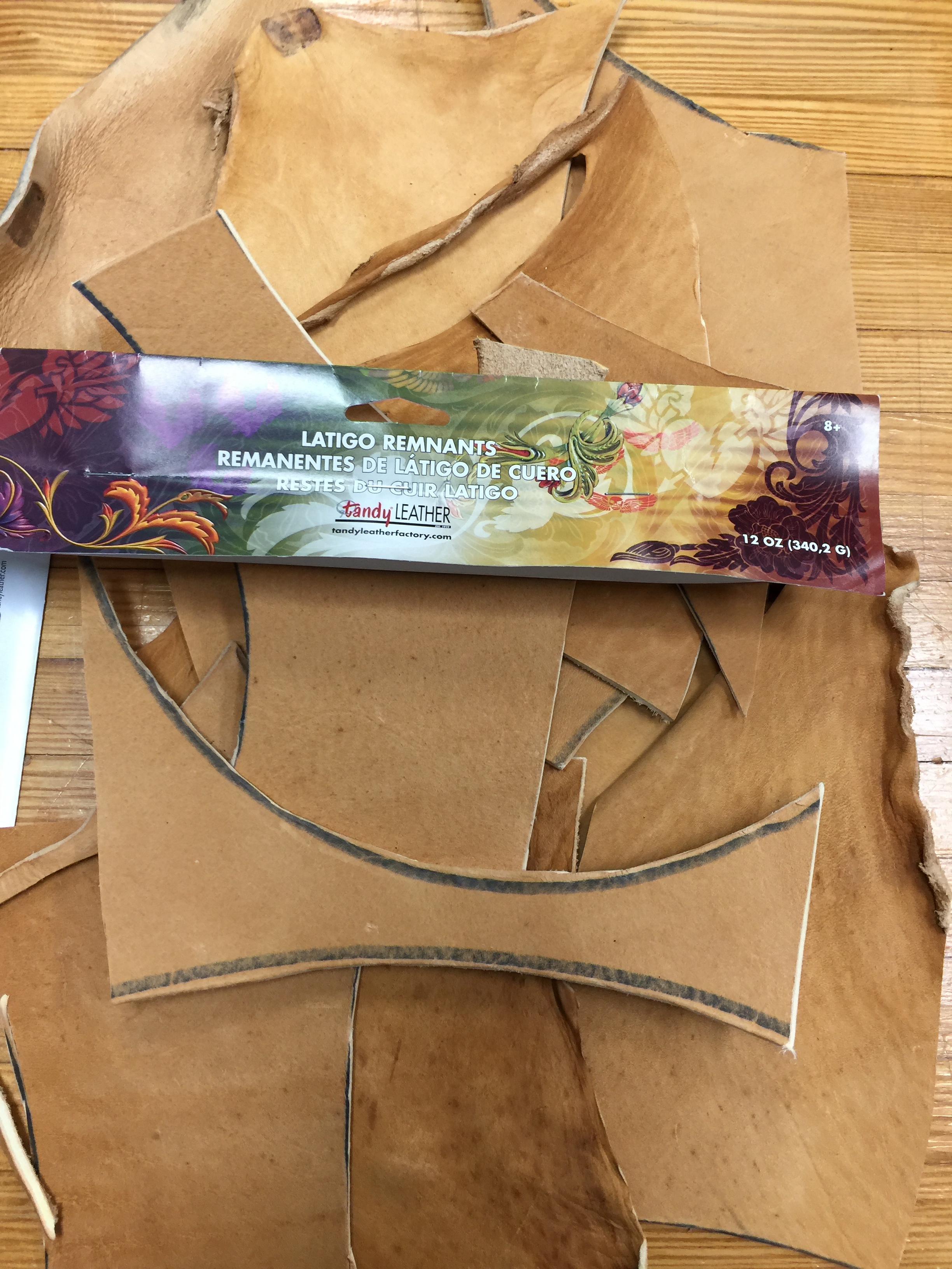

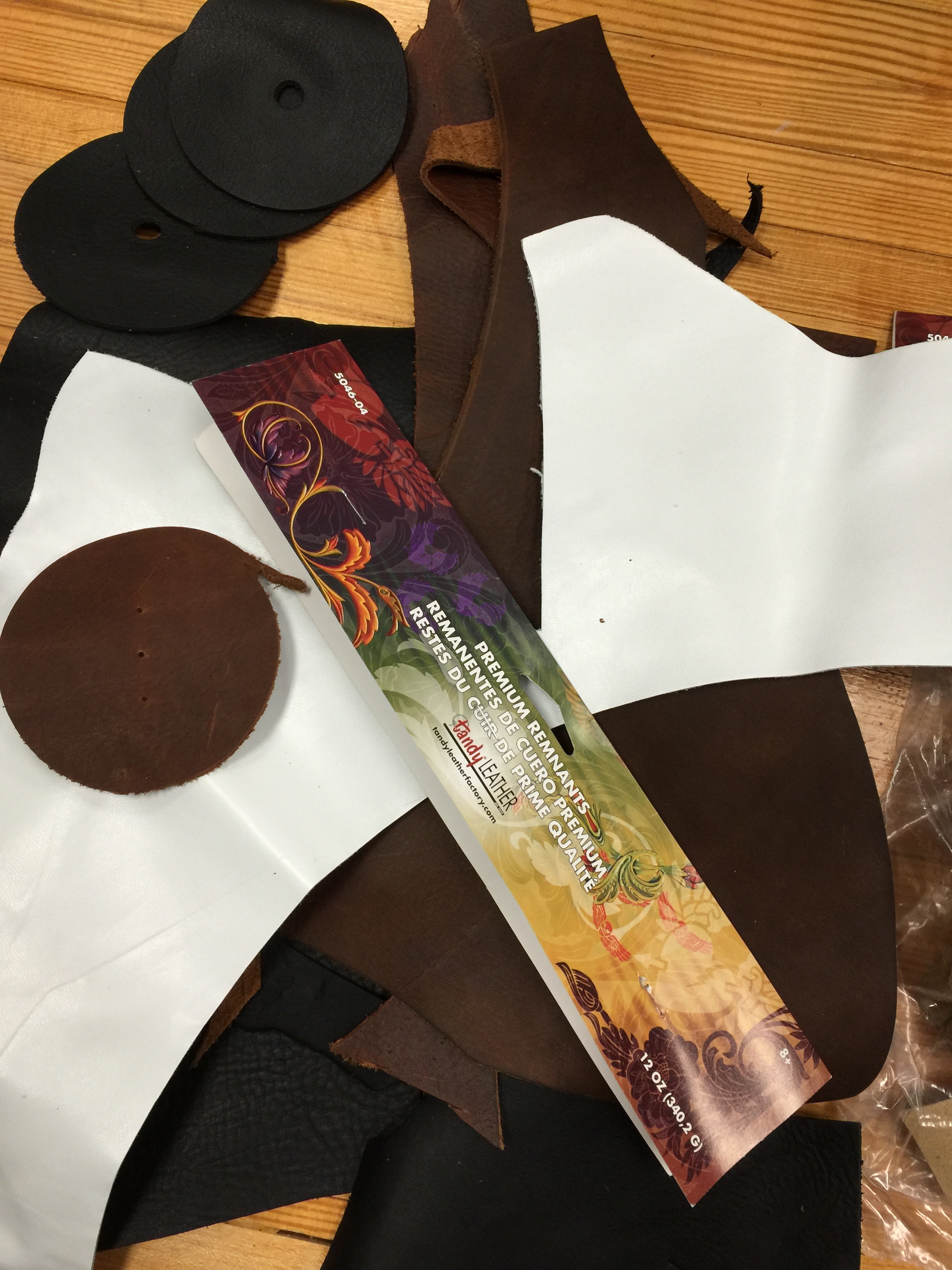

So I didnā€™t see the posts regarding scraps, so I did stop by Tandy. For those interested they do sell bags of scraps for $10 each. I picked up Latigo, Premium, and Suede.
Be careful using the Latigoā€¦itā€™s packed with oils and waxes for weatherproofing.
