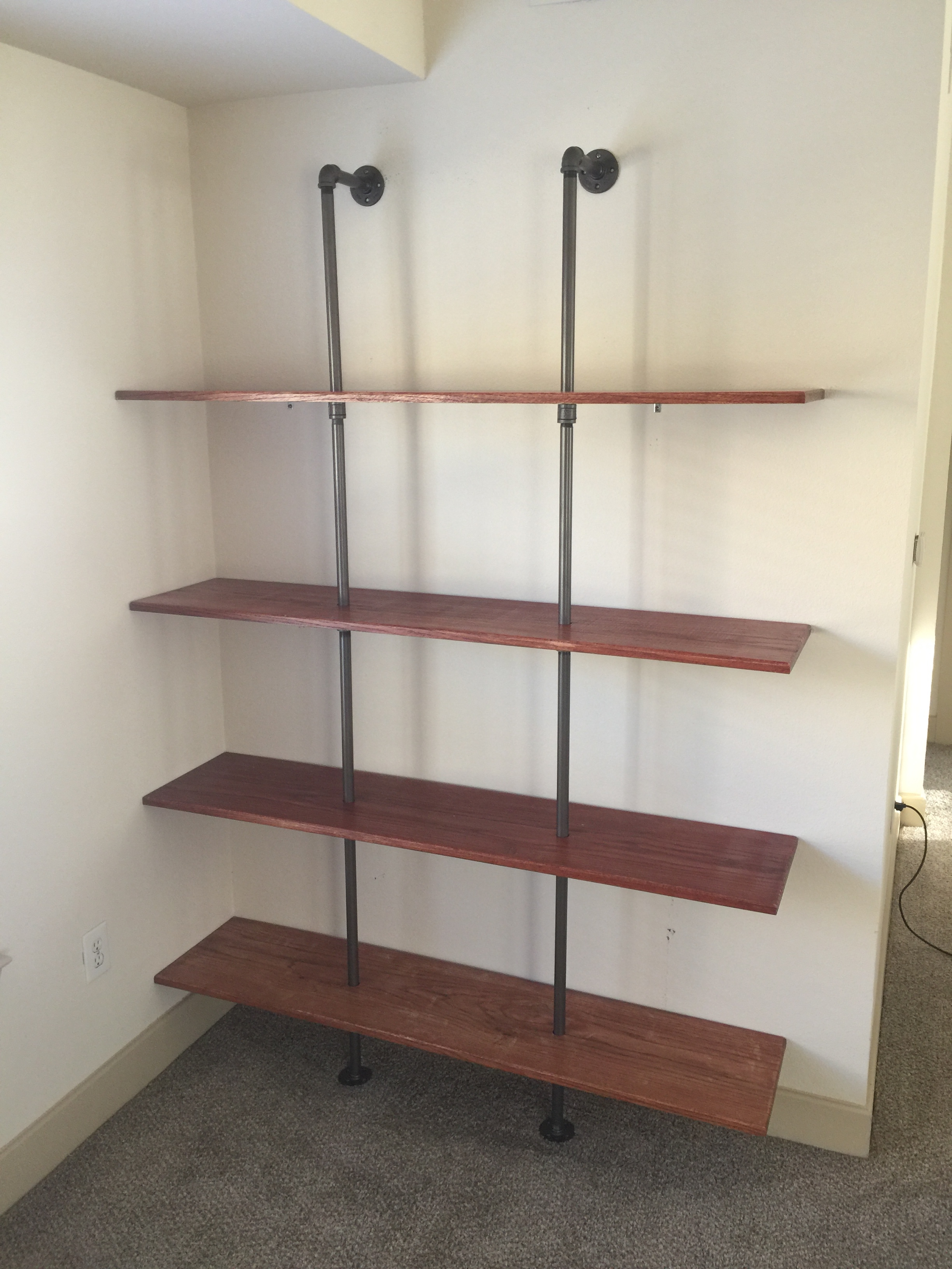

Finally finished the shelving unit at my apartment. 13" wide shelves mounted on 3/4" black metal pipe. The pipe was acetone cleaned and painted with hammered paint. The holes in the boards were CNC cut / counter sunk to allow a large washer to disperse some of the force at the hold points. Also used an anchor on each shelf for extra stability, but it’s more to keep things level and against the wall than load bearing. Boards are lightly stained red oak. And finished out to about 13/16" thick.

Looks good, Ian.
Question: Did you use (tapered) pipe threads for your threaded connections?
I’ve found them to be problematic where precision is concerned.
Wuz wondering how you dealt with the imprecision, if that is what you used.

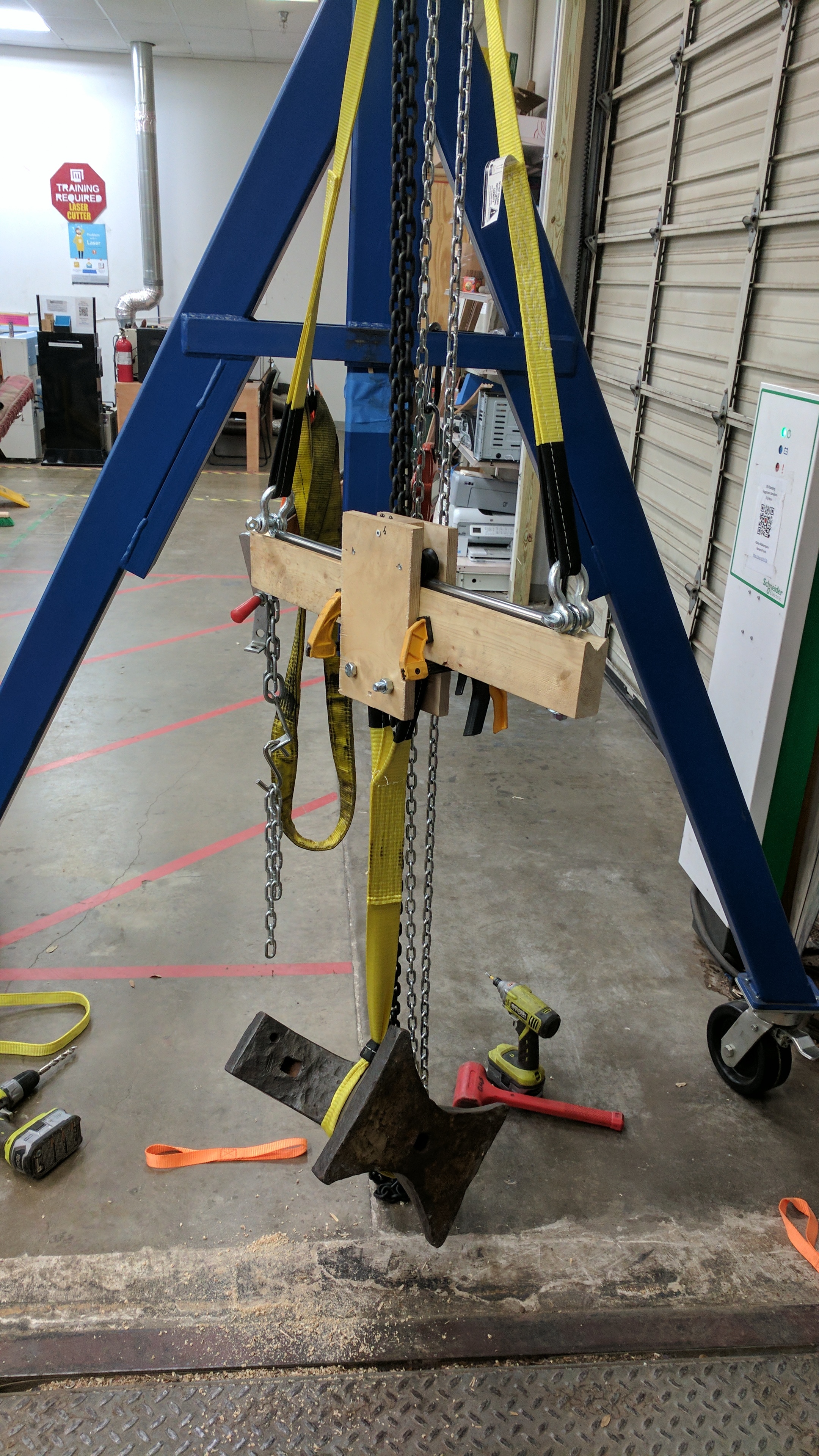

Got some 6 and 4 ft slings for use when lifting things
Used them for a bad idea I had for load testing bearings, ended up using press instead of trying to use 1 ton crane scale and anchoring to dead weight

I did. I just bought 18" sections at Home Depot (and the connectors as needed). Most of them were pretty close; close enough to throw some threadlock on them without having to totally sinch them down. However by the top shelf I was out of adjustment on the right side and had to add another washer to keep things level.
