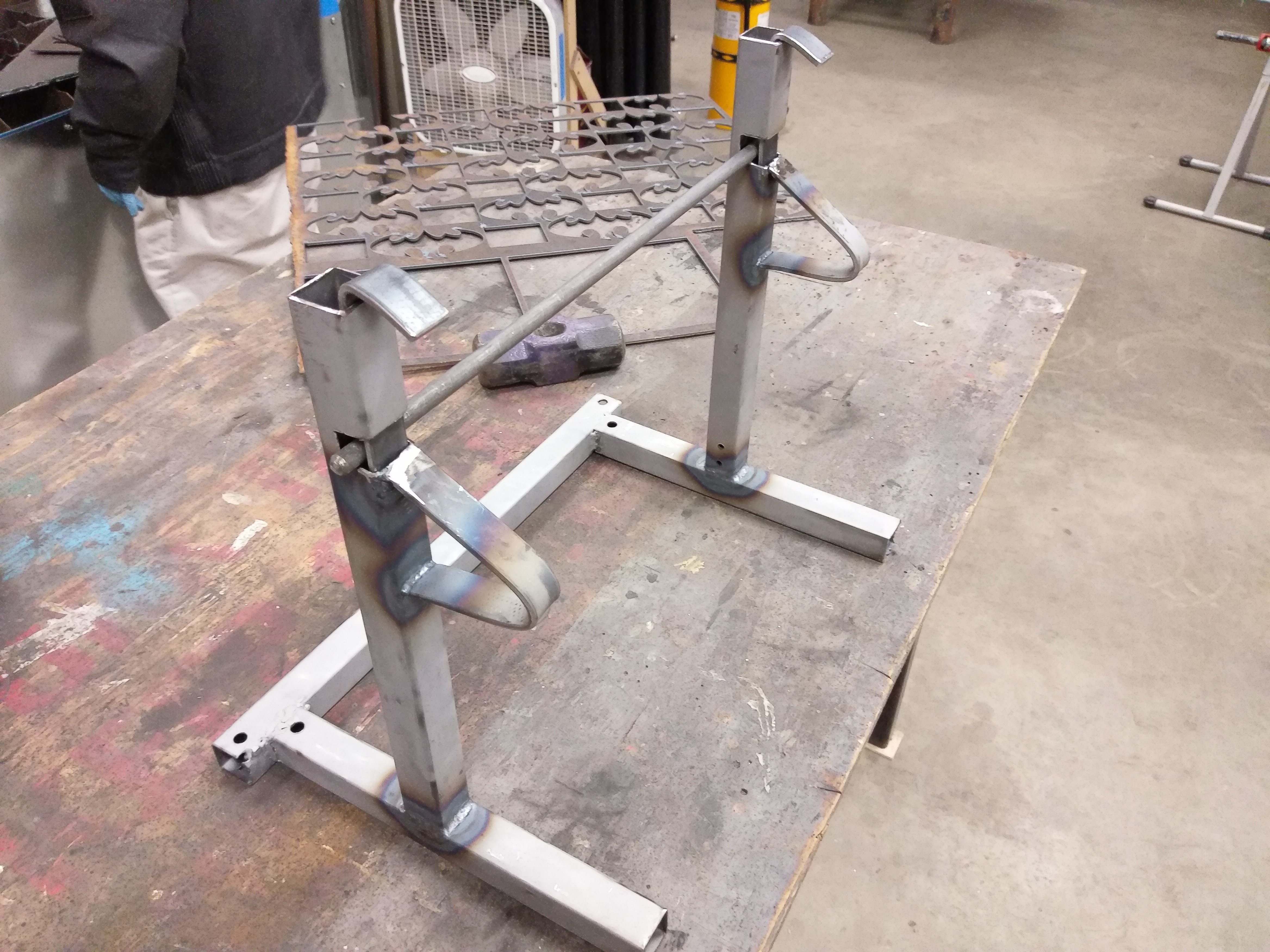

So a few people have seen me up at the space with my golf trailer moving my motorcycles around. I built a ramp onto the trailer, and had started building strapless stands to better secure the bikes inside the trailer. Well, got one finished and into the trailer. Bike fits perfectly, and is very secure (check out the video)
Video:

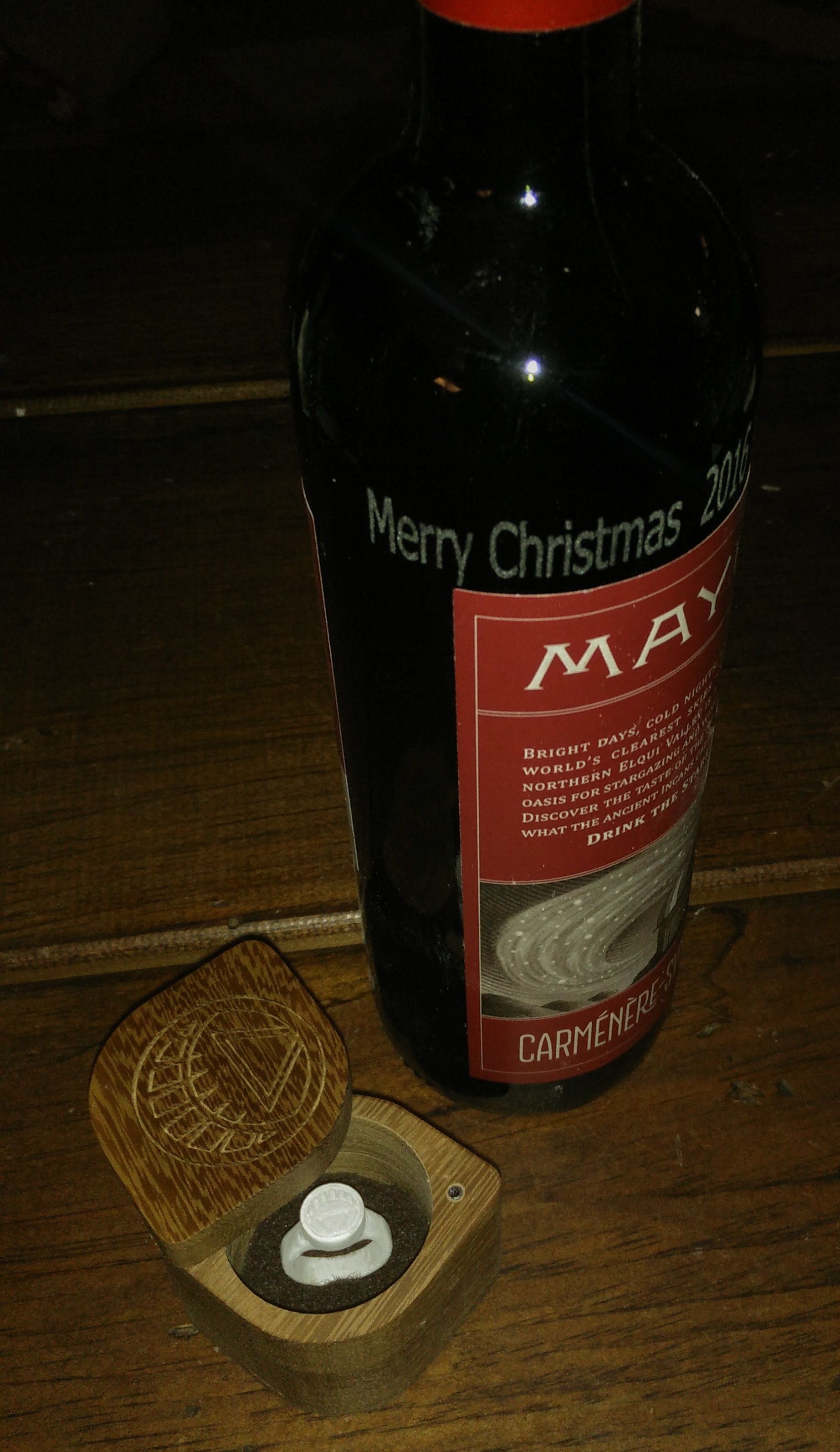

Made a last minute Christmas gift in John Gorman’s laser etching glass with the rotary tool class. Also 3D printed a White Lantern ring and made a teak box for the ring as another Christmas gift.

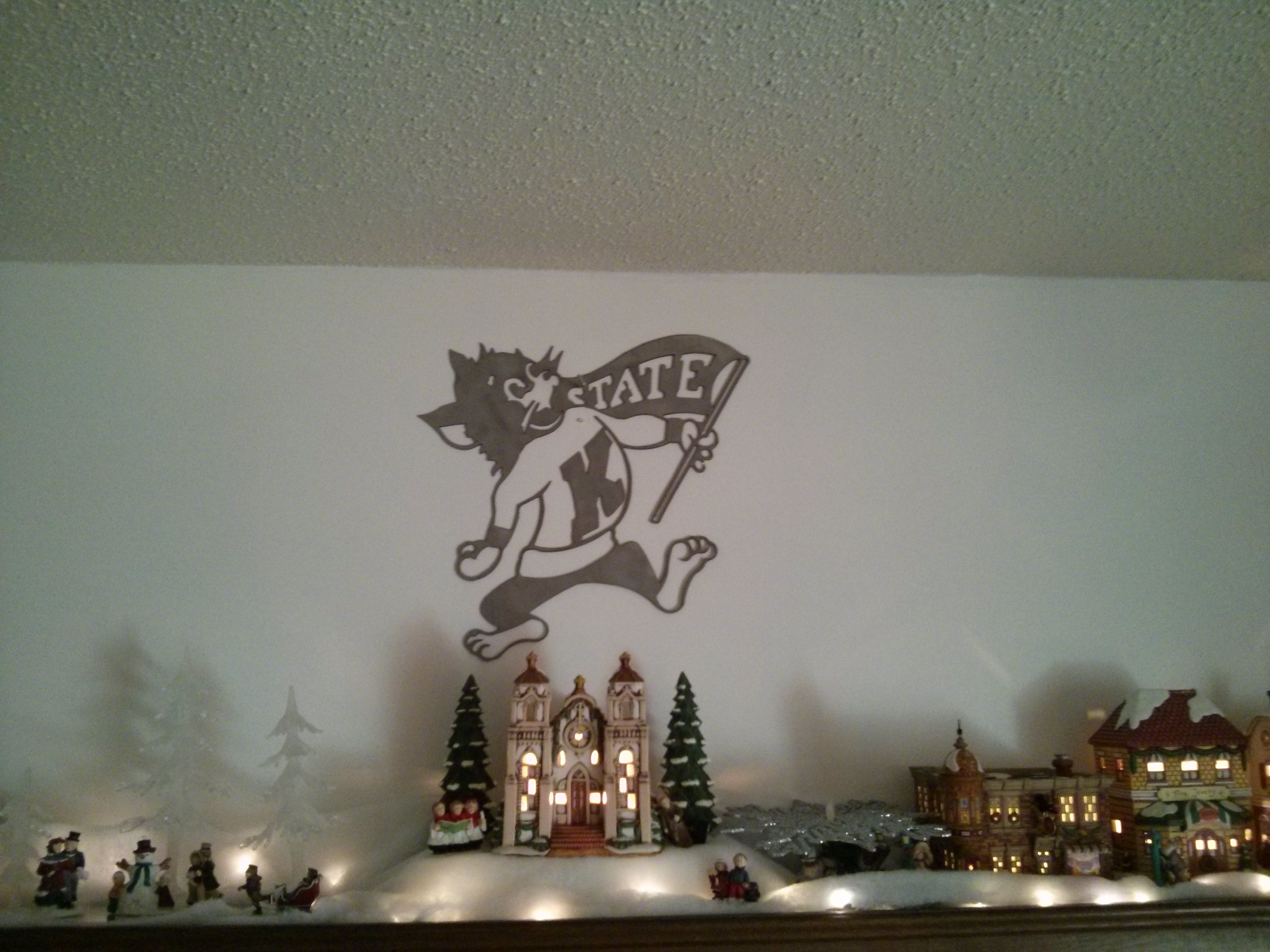

We made some wall art Christmas presents for a few family members. Overall it was really easy… the frames themselves were bought from a craft store, then we added backer board, cut some scrap wood pieces to size, painted/stained them at home, and glued them in place. And the word was laser cut out of mdf and painted.
Merry Christmas all!!

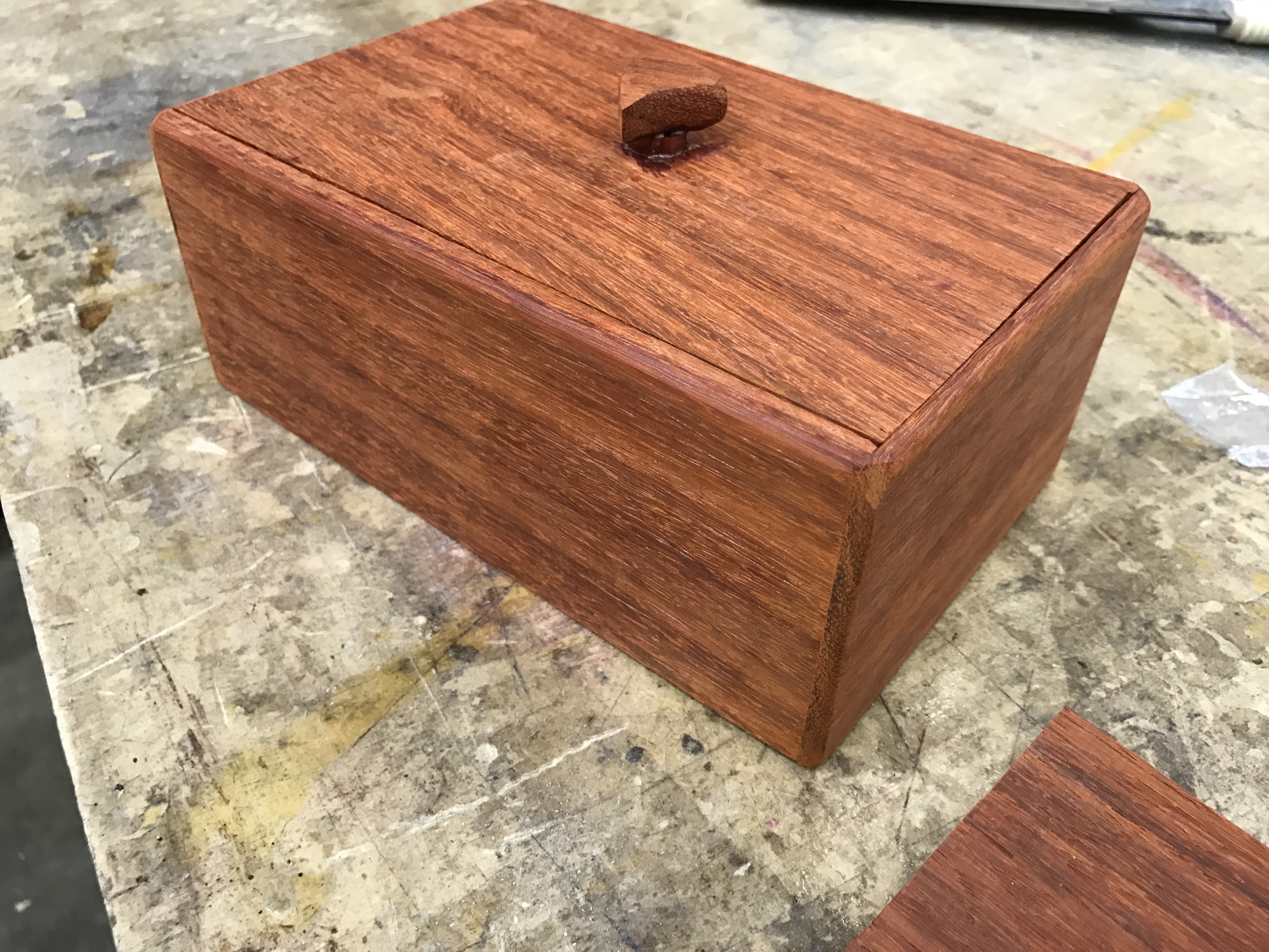

Was really glad I got to take Matt’s class A Wood Shop project class to build a box with sliding lid to learn basic joints and tool usage - #50 by AlexRhodes and made a box.
