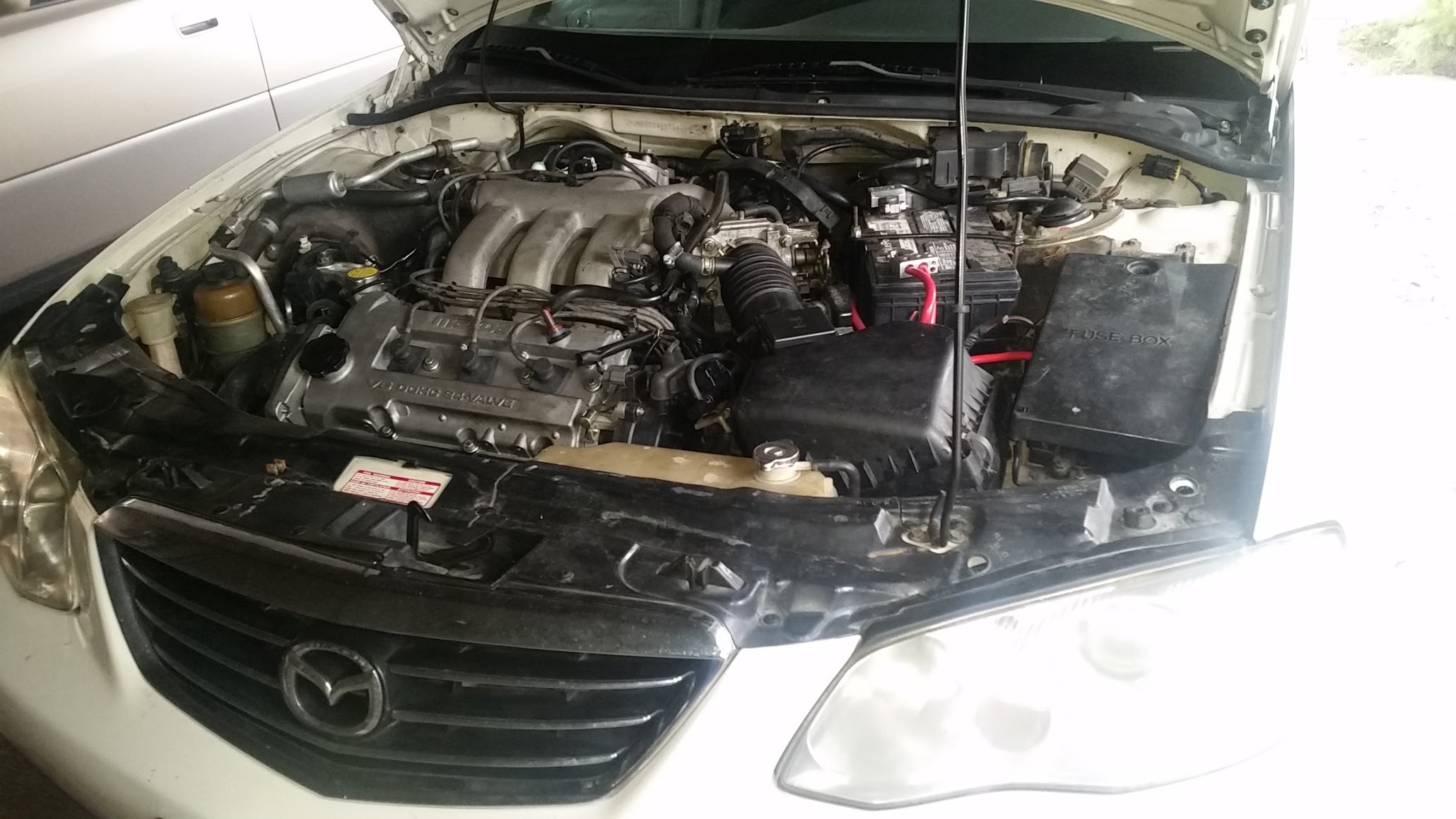

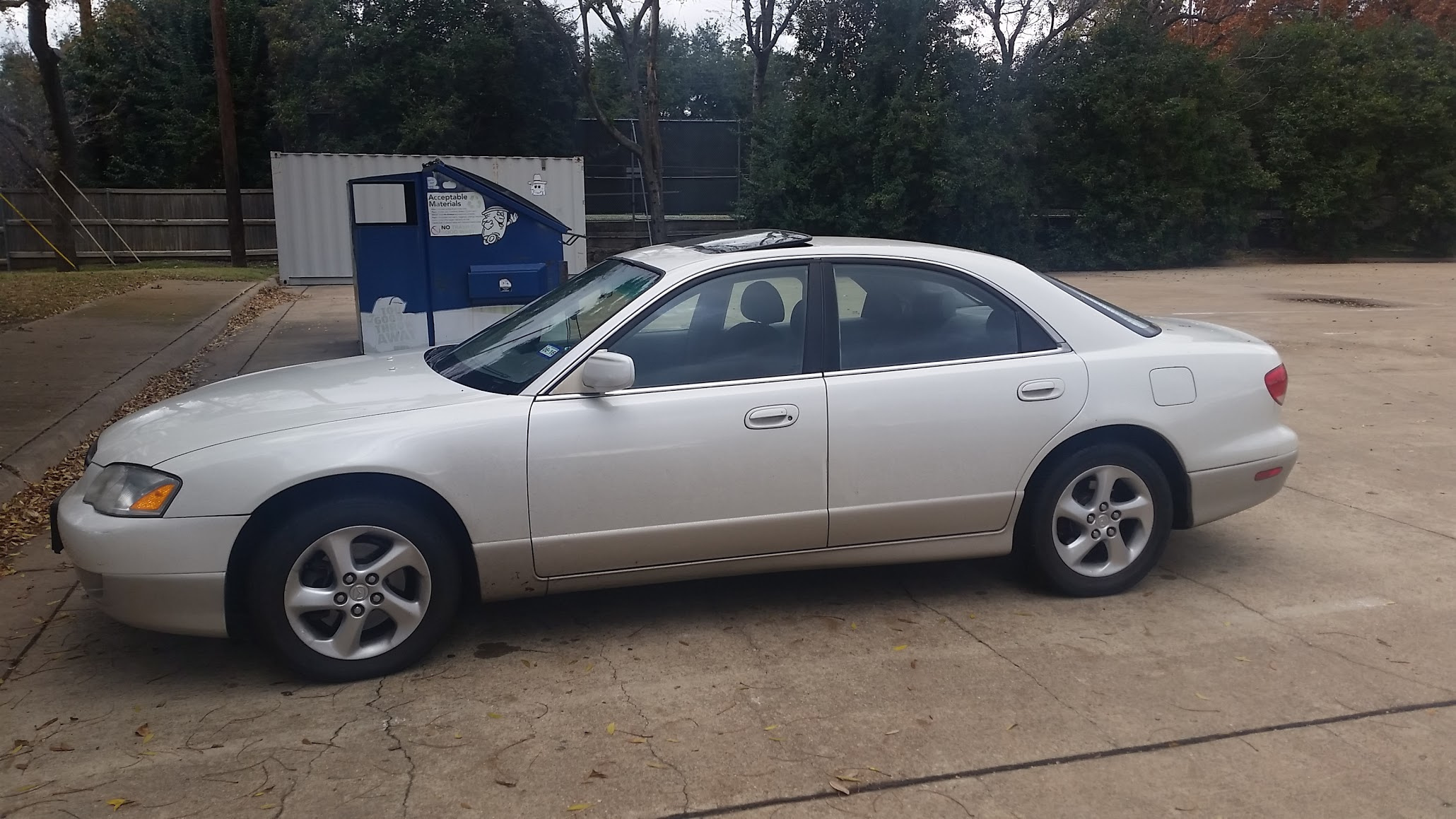

I know everybody has seen, but this thread gets special exposure, and I am proud of my cool old Mazda…For those unfamiliar, I rebuilt the engine on this using a new Mazda short block that came in a Ford box. Miraculously, I got it running once again (I program for $, never used an impact wrench when I started this one). I give credit to some non-stop determination (I needed a car) mixed with a little Dallas Makerspace Automotive Committee know-how…

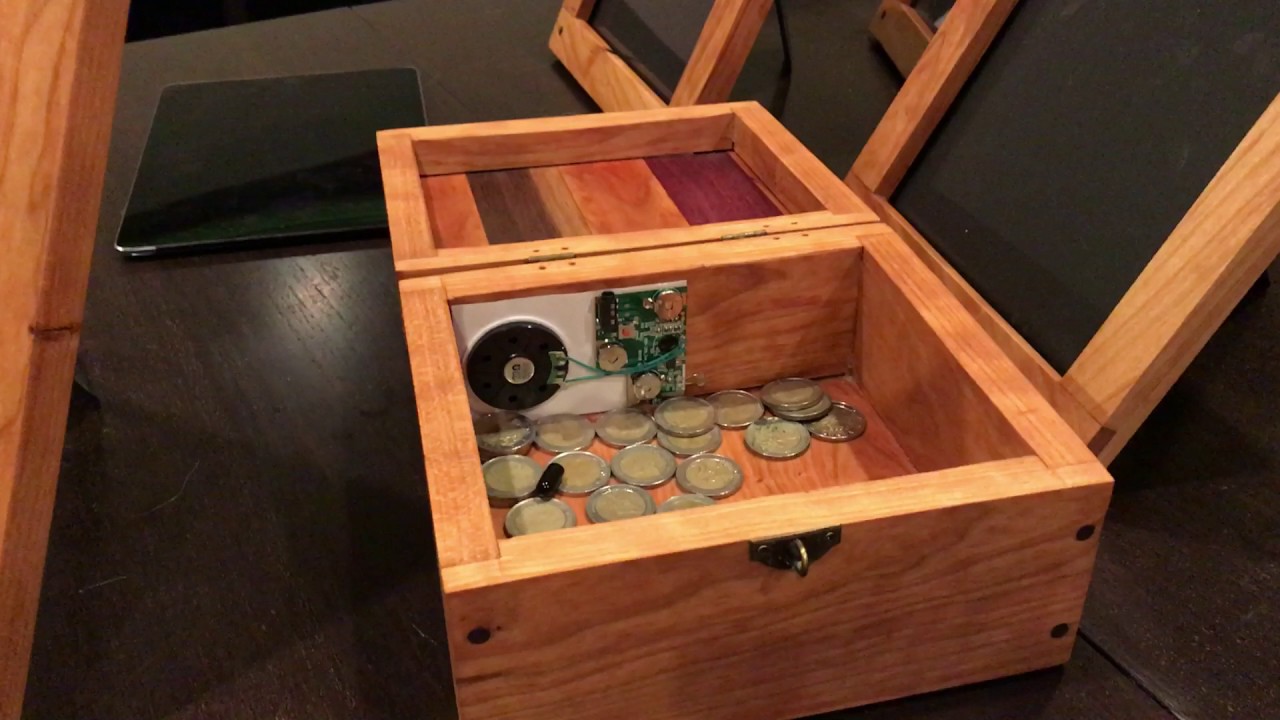

Gifts for my niece and nephews. Cherry boxes, rabbet joints for box frame and dados for top/bottom panels, walnut dowels, tops made of cherry, walnut, purpleheart. Interior uses light sensor music player I found on Amazon (search for invitebyvoice). Finished with 3x BLO and paste wax. Made three of them, programmable by the kids later if they want, with a bunch of dollar/euro coins in each because kids aren’t going to think a music box is cool, but I’m still going to be a troll-uncle and make the cash a little difficult to spend ![]()

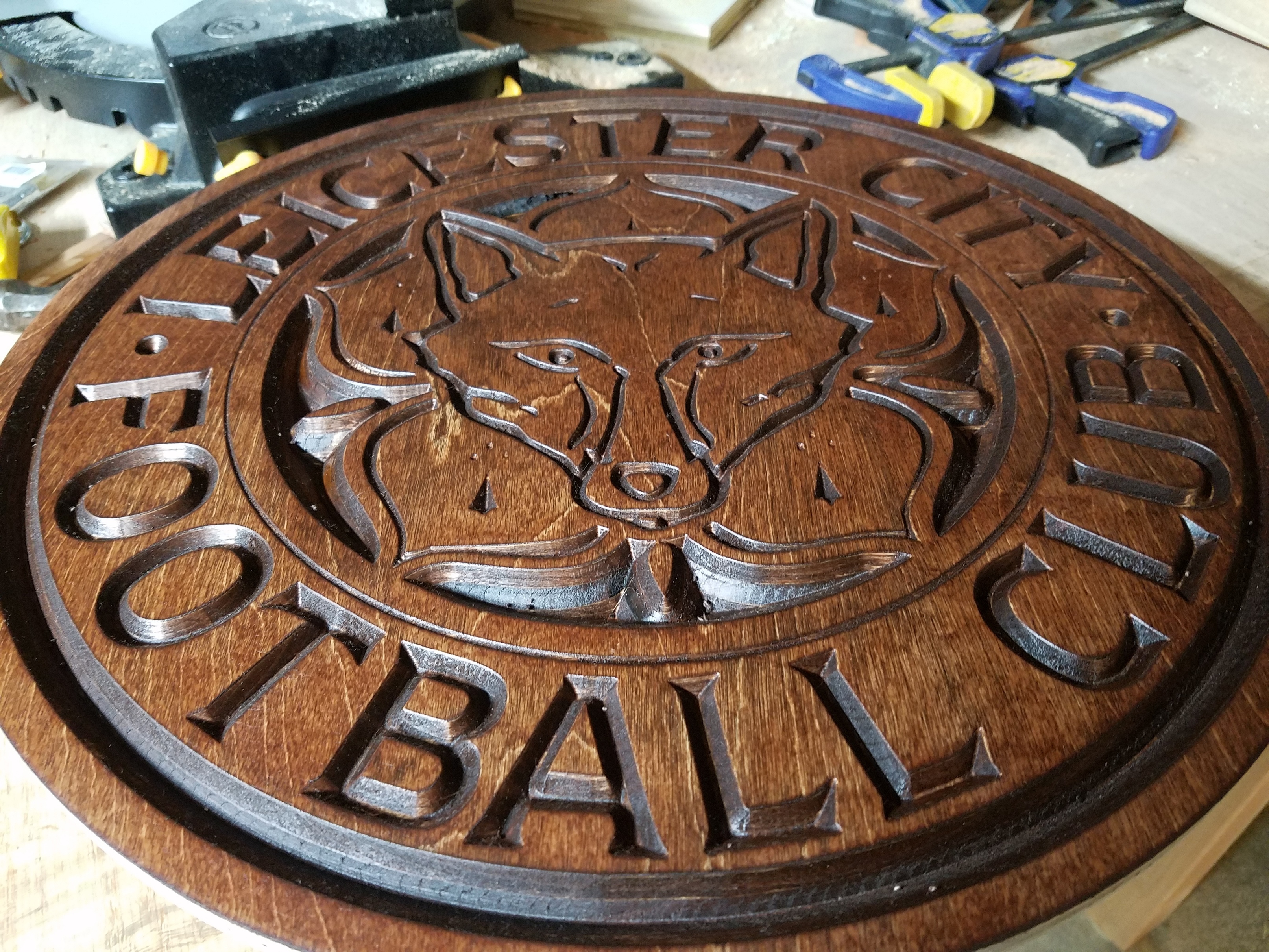

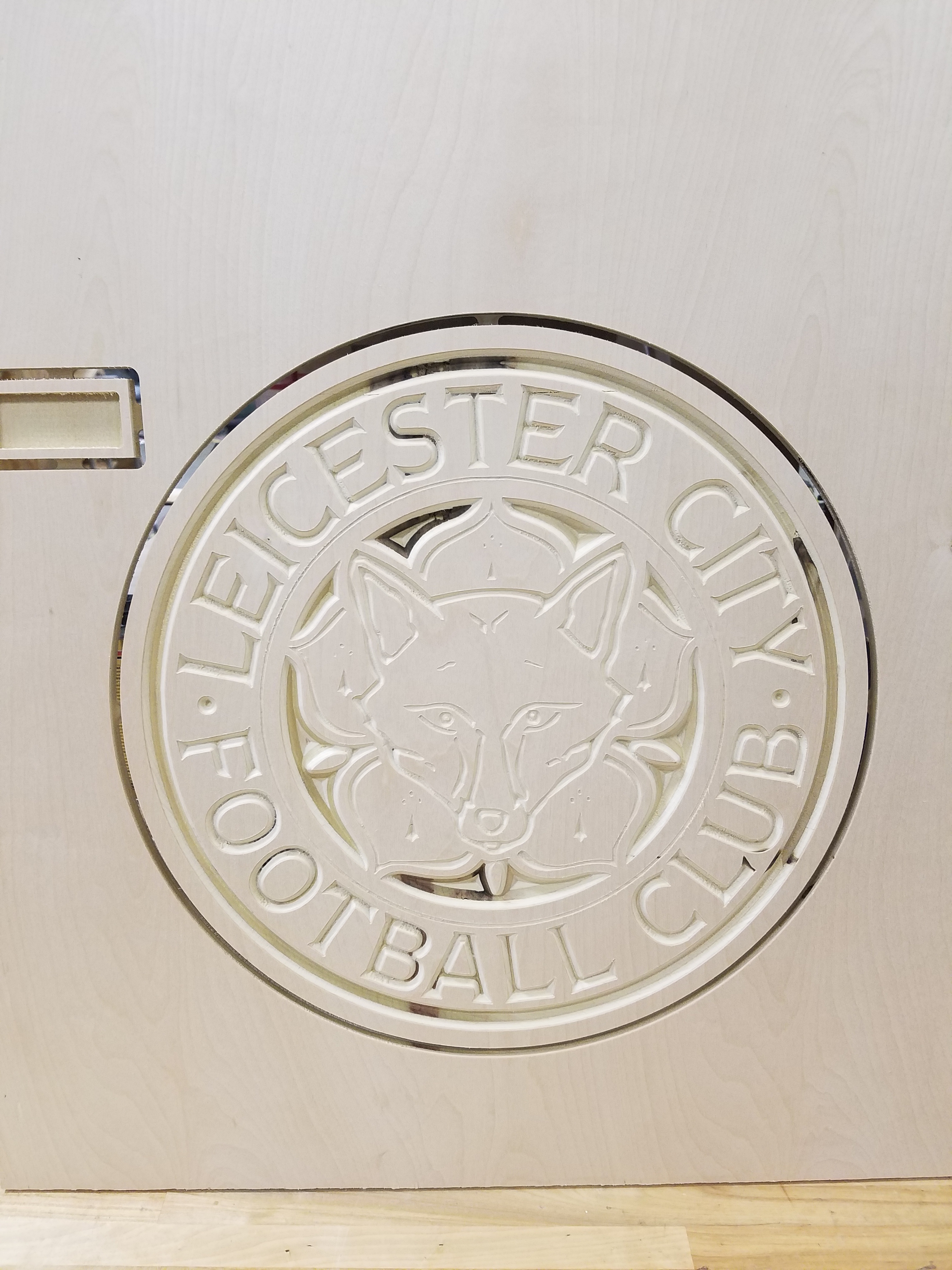

This was actually my Multicam test piece. I chose it partly because they’re my home team, and partly because @Kentamanos and his “Liverpool” example lol. Turned out so nice on the CNC (much kudos to Chris Ghaly, awesome tester teacher) that I decided to clean and finish it up.

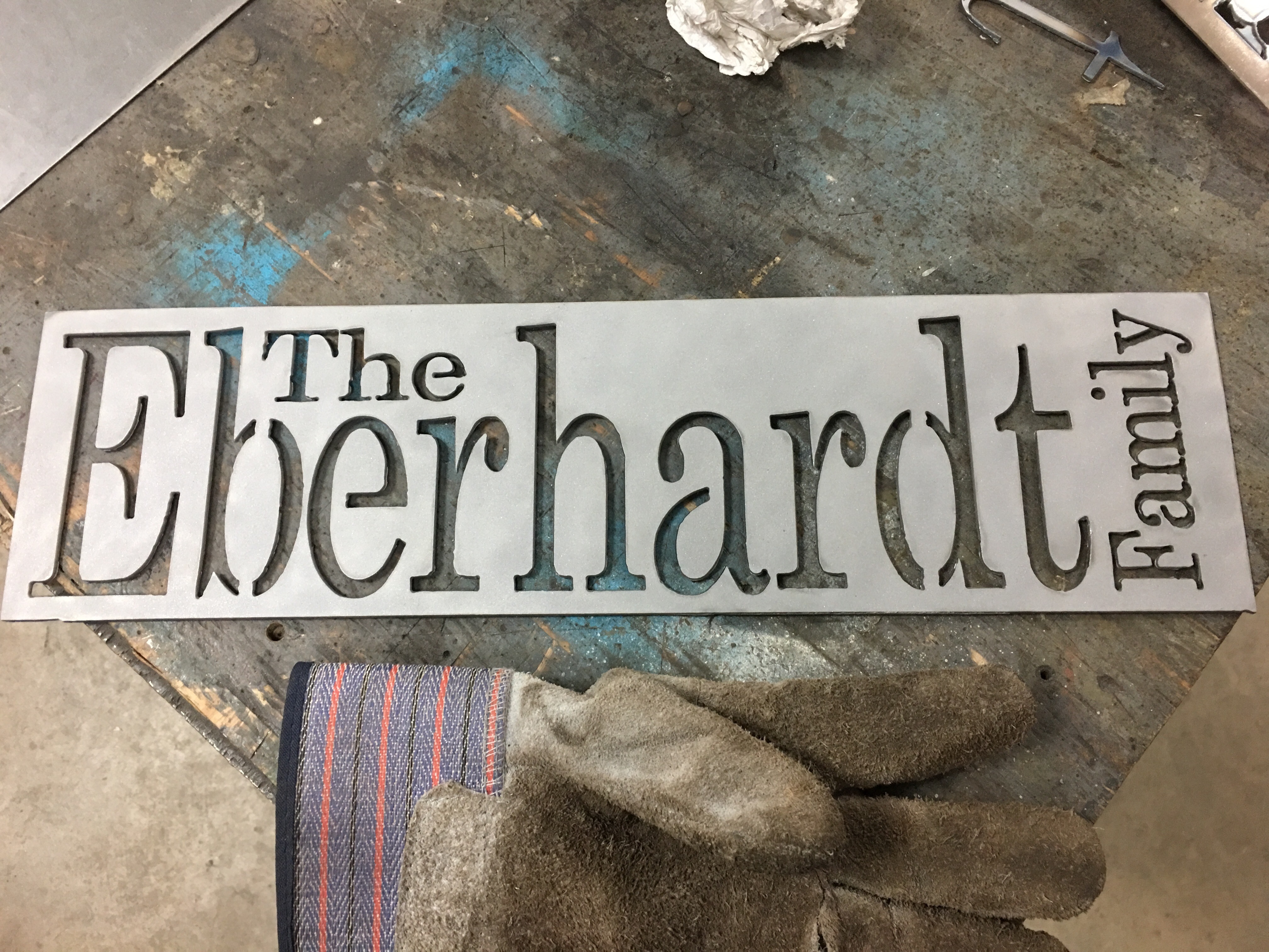

Been playing around on the plasma cam for some Christmas presents for my family ![]()
Huge thanks to @TBJK for the excellent class and just being helpful anytime he’s around!
Ran both through the sand blaster afterward.
16 gauge steel name plate for my sister and her husband:
