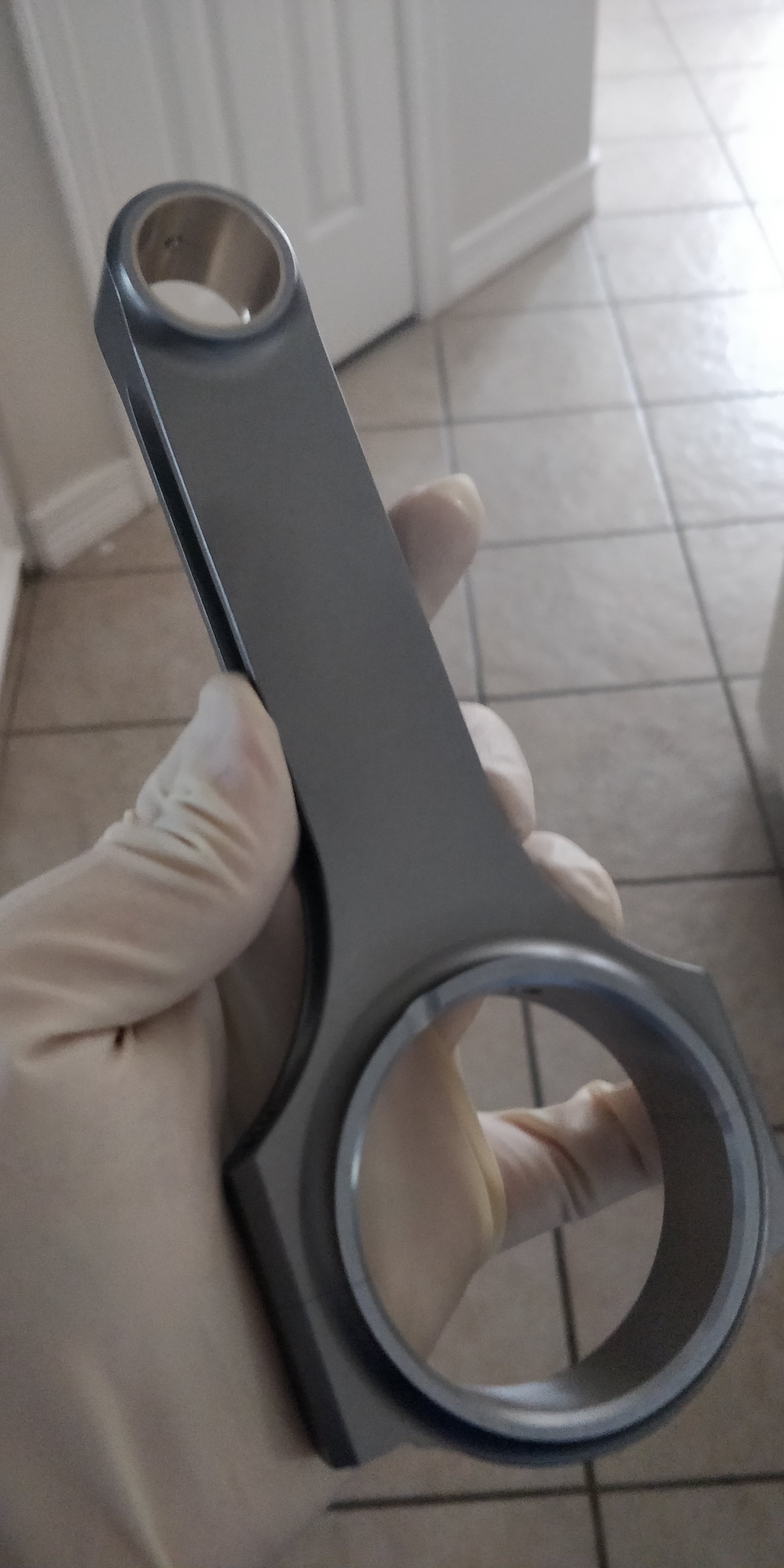

I have a few forged steel connecting rods that I recently received, and the caps were supposed to be marked so I don’t get them confused and mix up the caps. Can the lasers engrave my rods?
It won’t engrave metal, but, you could paint a section and burn the paint away. Or you could ceramark it with the laser.

An alternate idea would be to apply paint or tape, use the laser to put the number, arrow or whatever you need, then electro etch it.
Cermark is used to mark engine parts.
The cermark lmm-14 seems to be made for high temps. I’d bet that’s whats used on engine components. I may try that, but I can’t find temperature specs for it.
