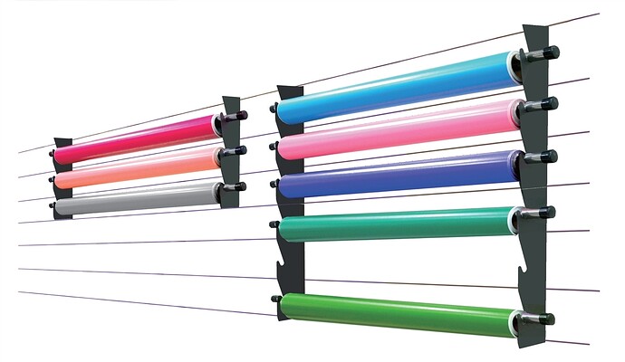

I purchased the vinyl holder for the space a solid year ago- it works well but isn’t great. I’ve started buying larger longer rolls of the more common colors and it’s just not suited to this size holder. Rolls are precariously positioned and if not careful they can come down when you’re getting another color.
We need deeper grooves and a wider area from roll to roll to accommodate the roll. This is a simple item but provides us easy access to supplies. I could easily see this made on the CNC (I need a refresher course and to take the test) or even with simple tooling in the woodshop. It need not be made out of metal unless someone just wants to get crazy with it and we can use the poles we currently have to save on costs. I will try to find an example of exactly what I’m speaking about.
I think the concept of the current vinyl holder is OK, but it just seems to have some problems with the details. Are you thinking about something like this?
I agree the design is good but just needs to be deeper nitches to kinda “lock in” the rolls and more space between each pole. That would work well as long as it has a good amount of space out from the wall to accommodate the thick rolls - but yes you got it right (as always).
the best “example of the idea of the deeper nitch I could find” please note I think this is just plain visually off-putting it’s just the concept:

The rods from the existing one could be used in the new one - so basically would just need to build a frame with deeper slots that are spaced more widely apart.

As far as the tubing is concerned, it’s difficult to tell in the photos from the link I posted; but, the rods are some sort of metal (not sure what type; but, it’s a bit heavy and definitely durable…). I’m not suggesting that what you could offer wouldn’t be better; but, rather - what we already have for rods may work well as they are.
I re hung the current one and wood or metal brackets or rods will be fine. This stuff isn’t that heavy, it just wants to unravel and the diameter is a bit large for the current spacing.
Alt idea: angled shelves would allow ditching the rods and make it easier to extract and insert rolls.
Having been down this road before, angled shelves are really a pain in the ass. The best solution is a hanger that uses rods that are the same Dimension as those that the vinyl feeds off of into the vinyl cutter. That way you lift the whole assembly into place, and that’s all you have to do. The feeder likely uses EMT, so it should be fairly simple to just cut EMT to the correct length.
