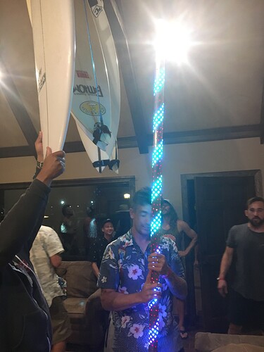

The reason I have to use aluminum is Stainless comes with thin walls 0.065"
Background - I drill thousands of holes in the pole and fill them back in with acrylic so I need the wall thickness to press fit and glue to.
The thermal gets offset with the heat generated by the electronics inside.
I’m very dead set on using aluminum and joining it to stainless or reproducing this part in aluminum all together

So the idea of a lighted stripper pole sounds awesome!
The idea of brazing Al to SS sounds like a bad idea. I’ve never seen anything brazed to Al that I’d trust. I’d hate to see some poor girl working her way through college fall because of some subpar welds.
Don’t be that guy that hurts someone by making a crappy design decision.

@Kevin that is GLORIOUS!

@Tres0422 Yes I’ve already made 8 of them & plan to make many more. My problem with welding is that I think it may melt the LEDs or acrylic inside.
