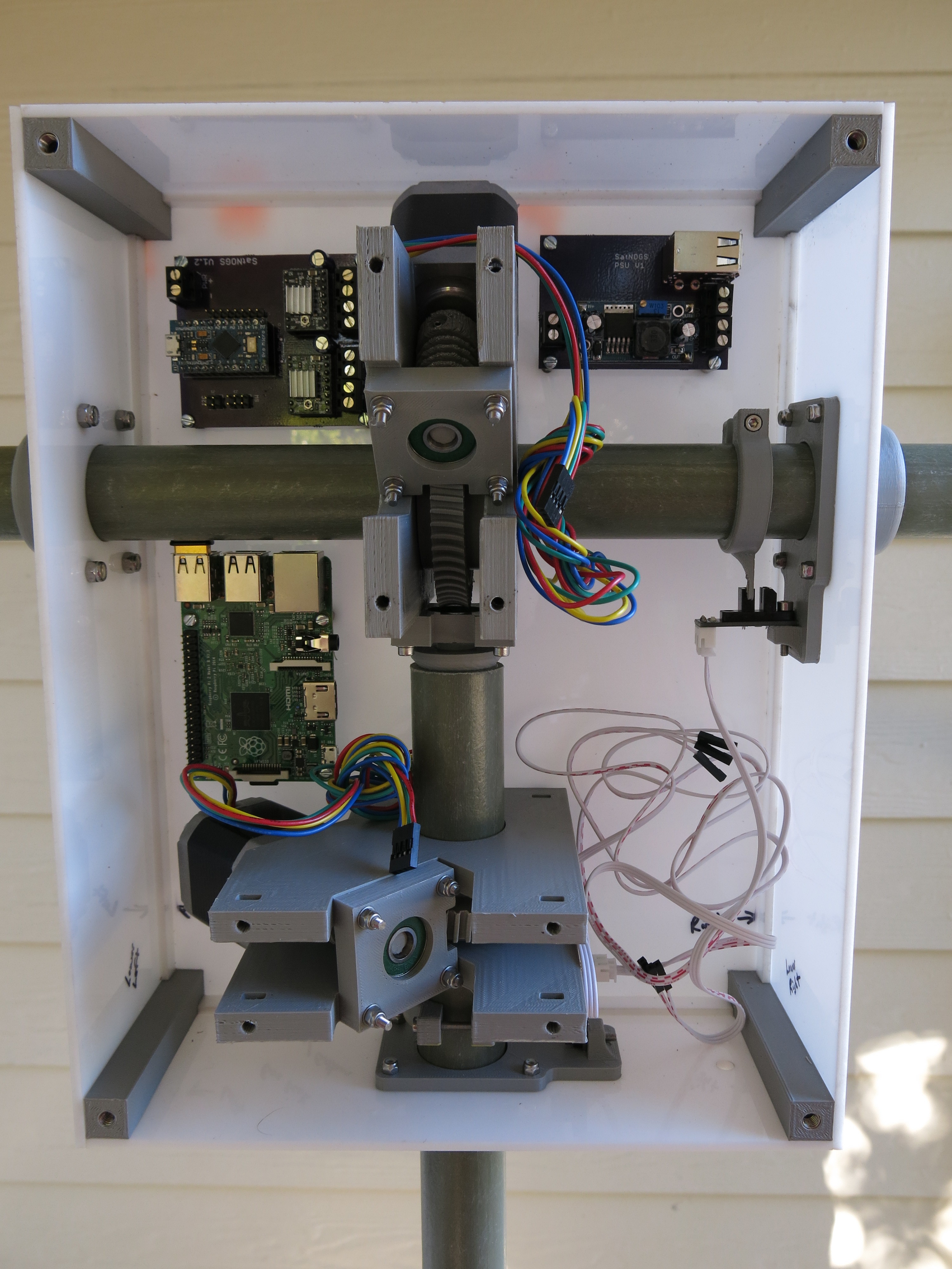

Here is my nearly finished inside of the rotator
Looks great !
Are the rotor mechanisms 3D printed ?
Yep, most of the mechanical parts are 3d printed (grey parts in pic), while the white box parts are laser cut acrylic. The only commercial items, beyond the Raspberry Pi, Arduino Micro, and the power supply board are hardware items.
@jonathan_brandenburg is further along with his and will be demonstrating a working (except for the finalized software) version at the Rasberry Pi meeting tomorrow. The meeting is open to anyone who wants to come.
Very nice work.
