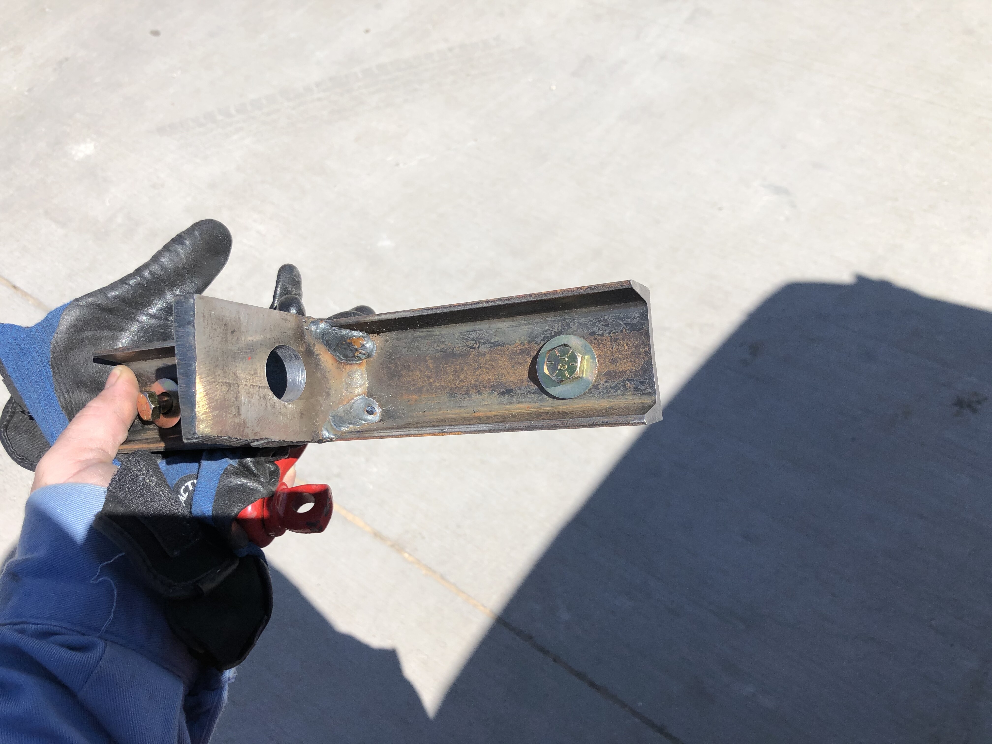

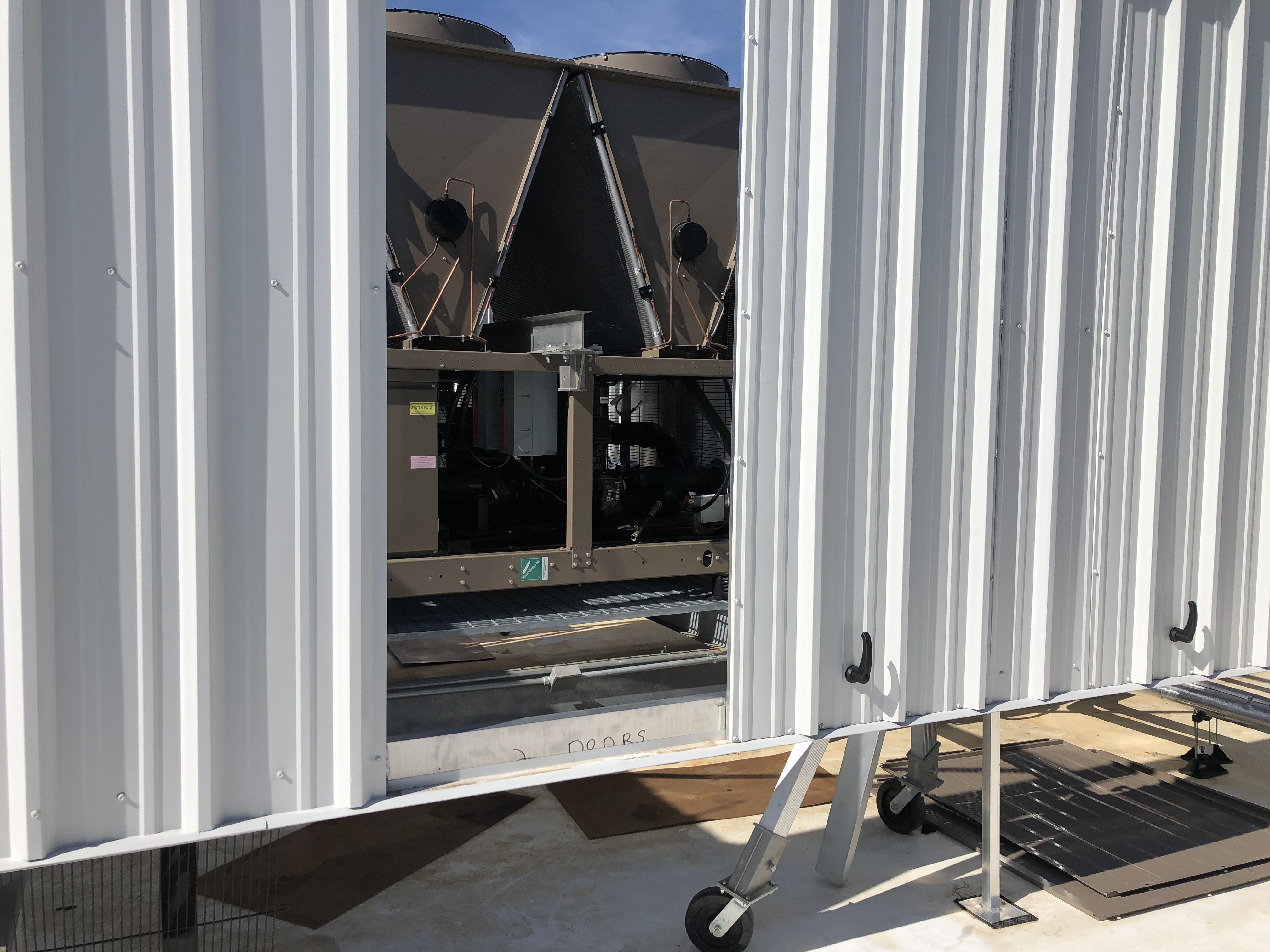

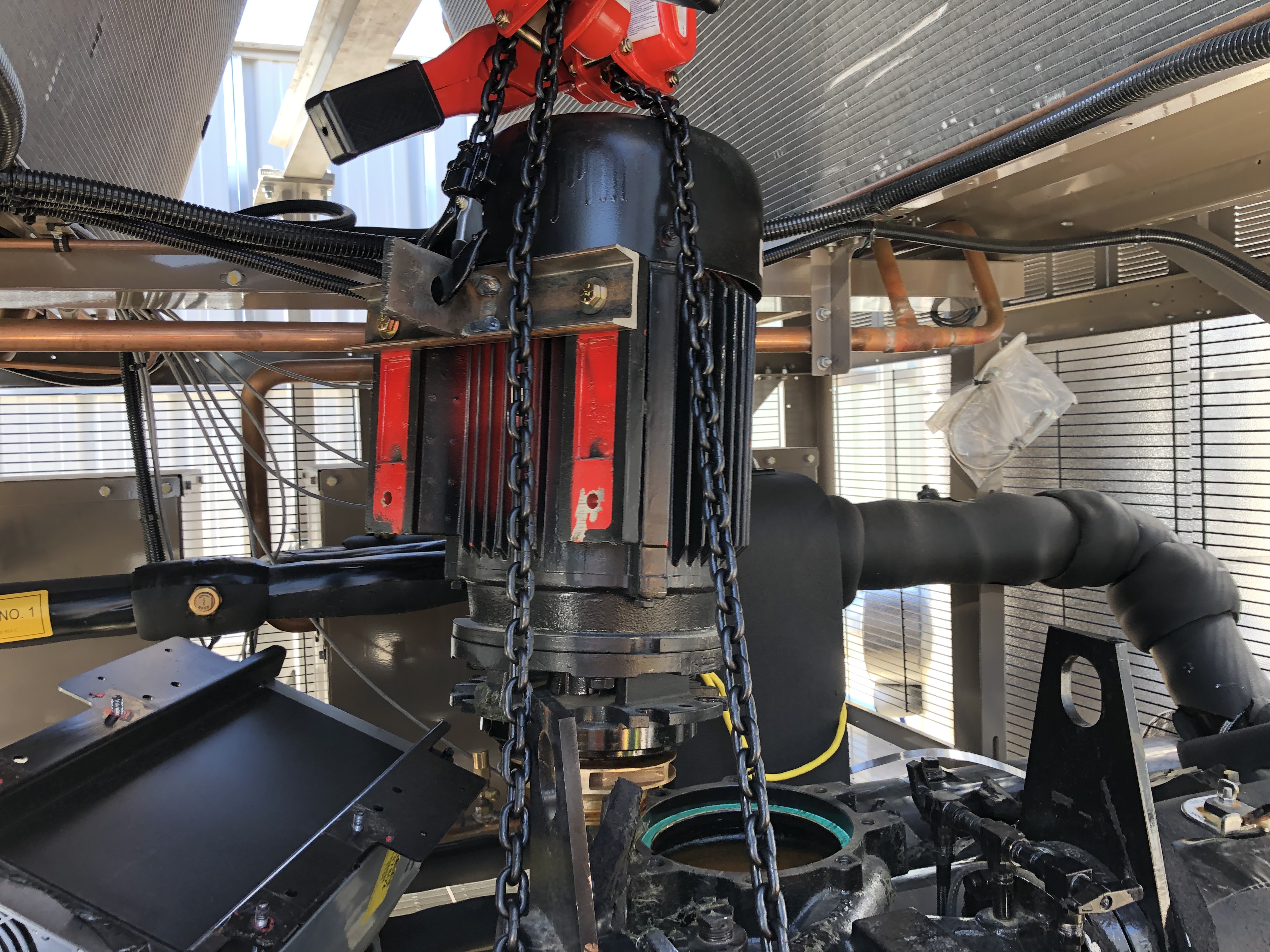

Just a quick bracket out of scrap steel I had laying around. Me & my MIG had some words at home Wednesday evening. So I finished the welds as the space. Its not pretty as I didn’t have time to grind the chit weld out. It is a 2” piece of MC channel iron 11” wide with 8.5” bolt hole centers. I welded 3/8 plate scrap to it to allow for us to remove/install the vertical pumps, well vertically. We tried with my various straps on the first pump but had hell getting it out in a manner that I cared for.
Little back story, the Freezmageddon or snowmageddon-whatever you want to call it, froze the housing on these 2 small 7.5hp pumps. Logically the unit couldn’t be on the ground but a white membrane brand new roof. The units were also set 2 ft off the roof with a “wonderful feel good we dont want to see it” wall around it. This took me back to my extremely youthful days of crawling around like a toddler on my hands & knees, BTW my knees now dont like me at the moment. There was not a lot of room to work above the pumps, we could not lift the gantry any higher or put a trolley on the I beam.
The bracket worked great, actually better than expected. It allowed us (my apprentice & I) to set the pumps back into the new housing flawlessly. Honestly the way the rest of the job went, I was expecting a fight.
Here it the bracket I made, again quick & dirty.
Yes it’s hanging offset for a reason. We had to clear the pump housing.
Reference of the room we had to work with.
And for once, I didn’t get asked whats taking so long, because everyone saw the job. OR they were probably worried I’d tell them to come do it. :grin:

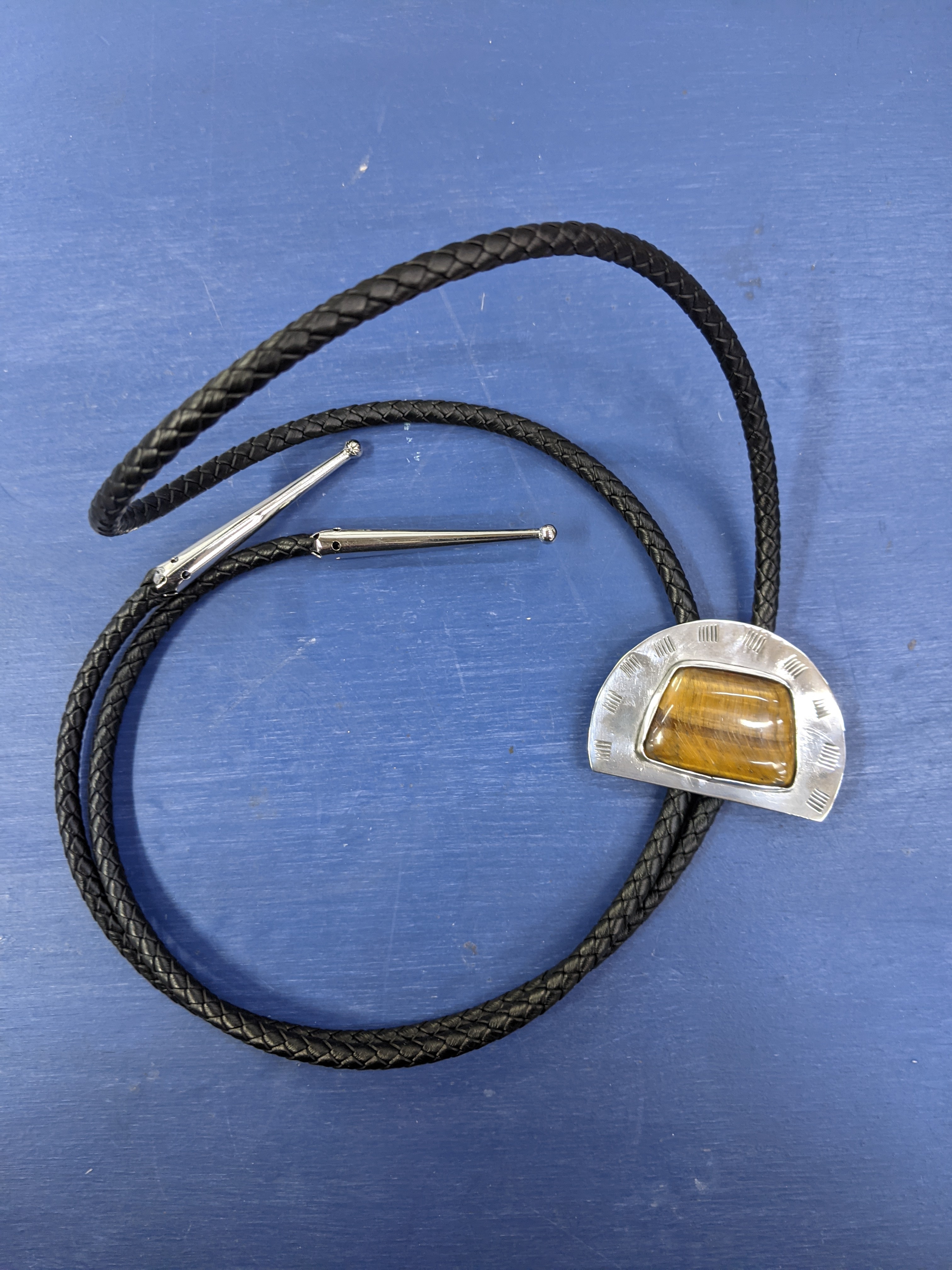

I cut and polished the tiger eye last week and made the bolo today.

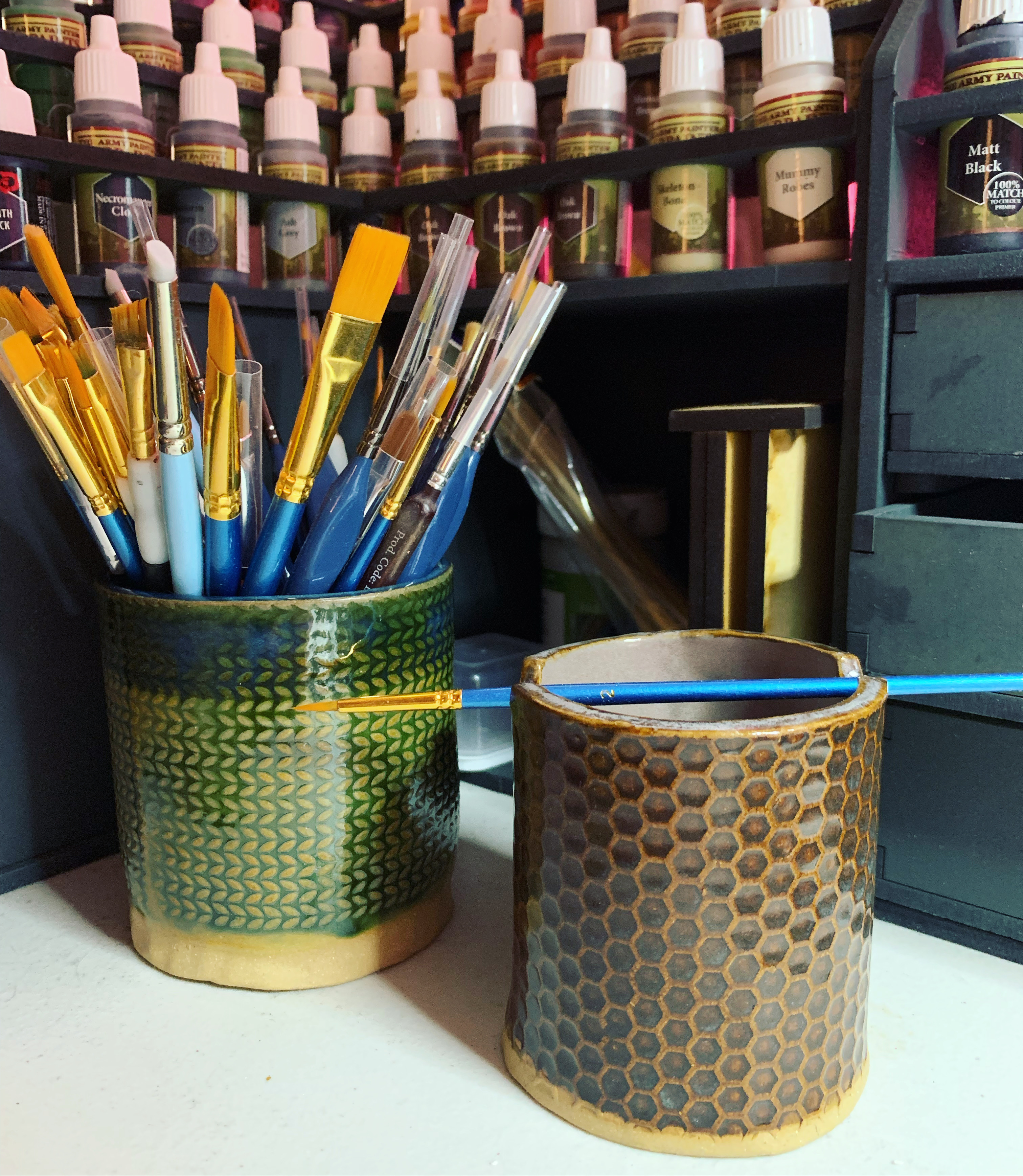

Made a ceramic brush cup and a paint water cup for myself :slight_smile:

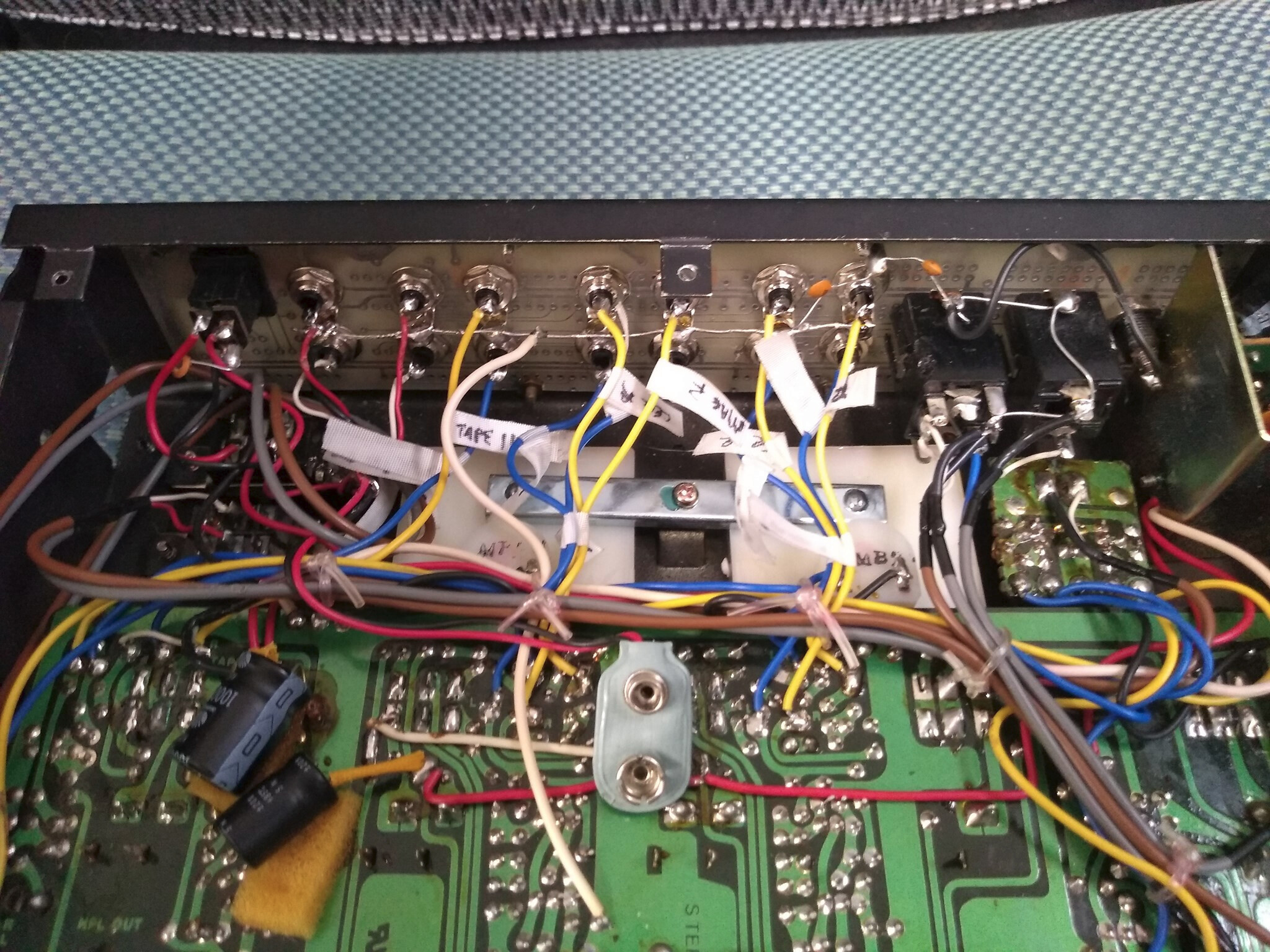

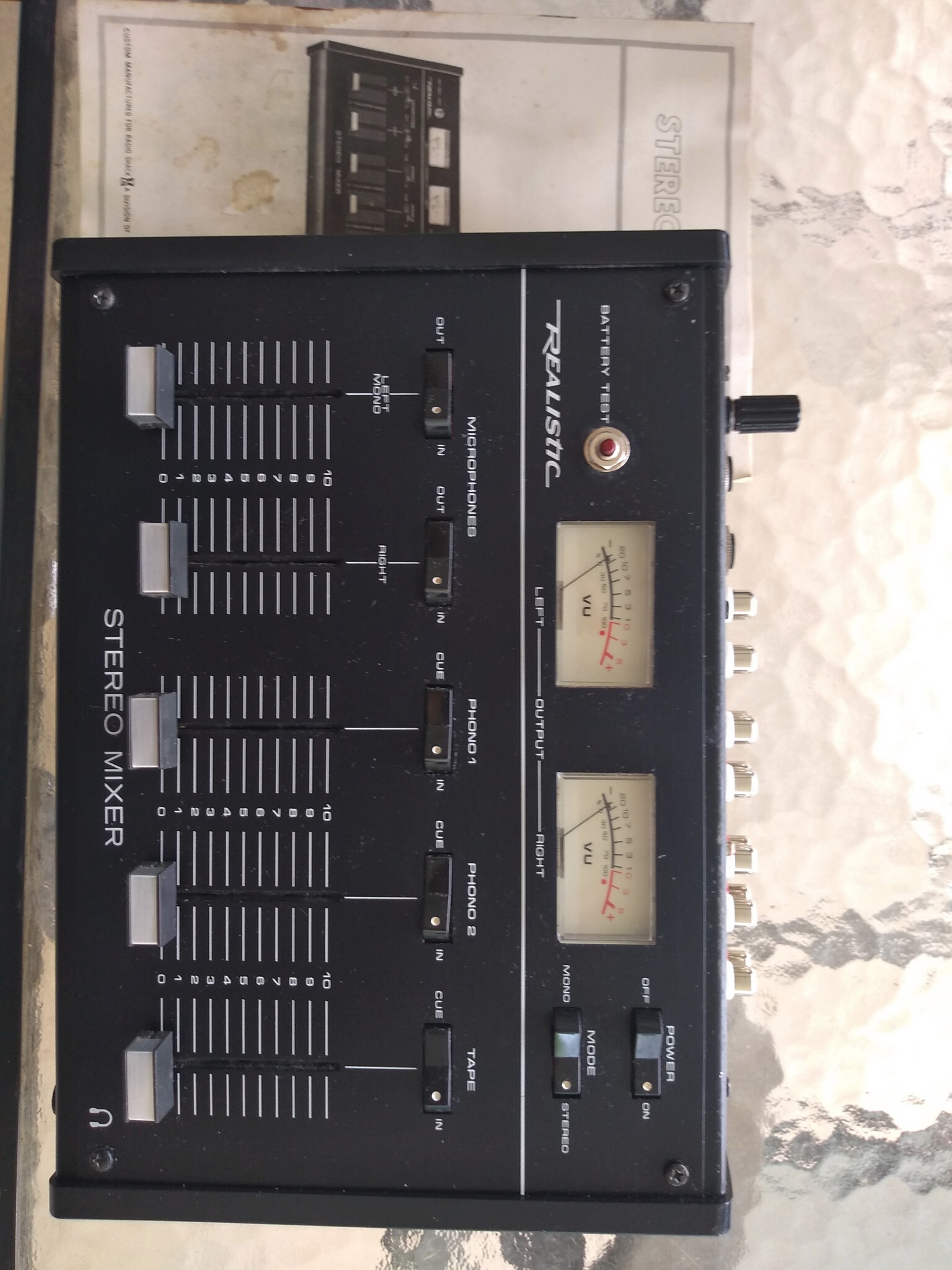

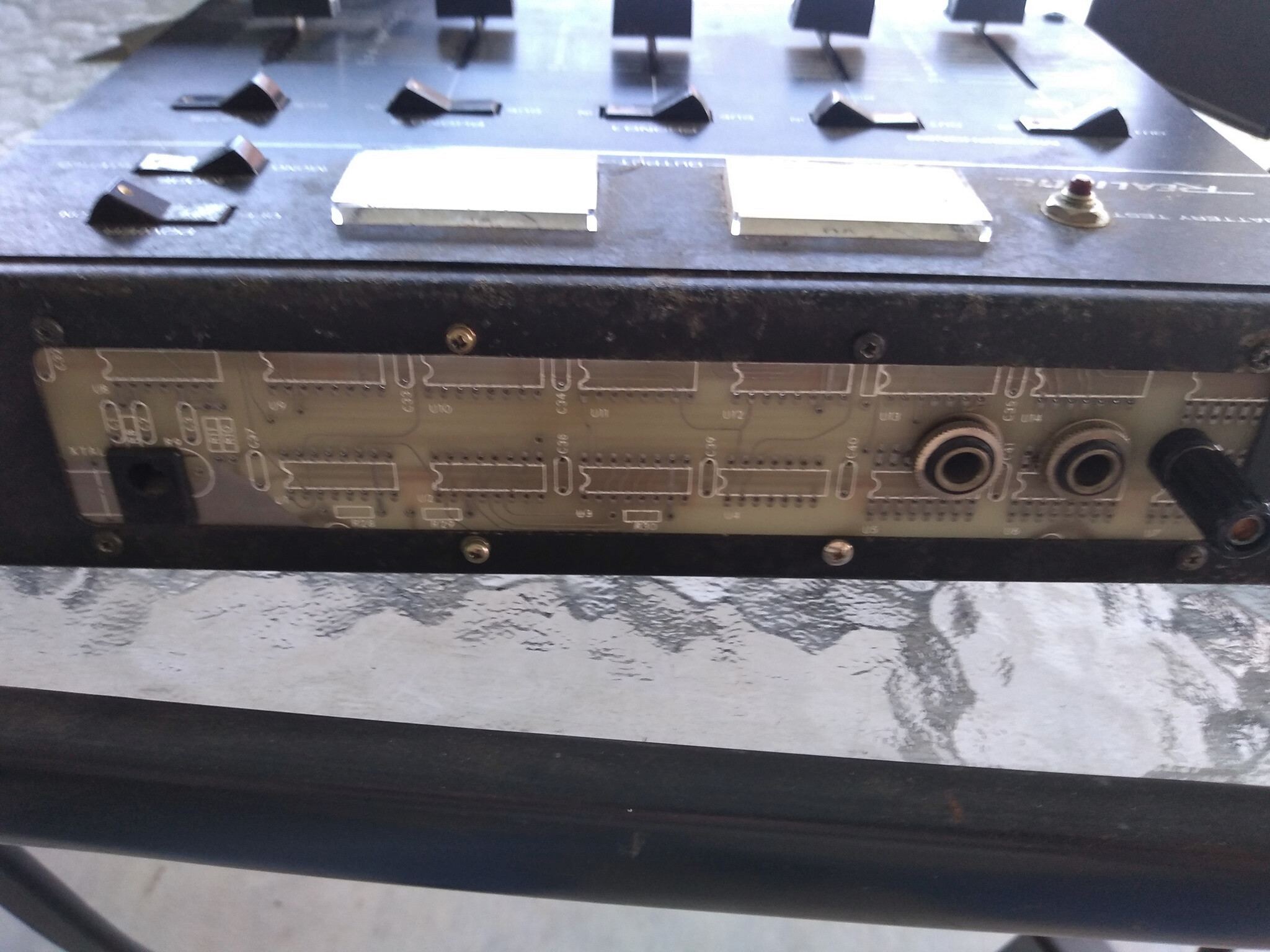

Picked up a dirty mixer with a broken back panel. It was in 3 pieces and had more cracks just waiting to go…
What to do? Hmmm… Ah! I have an old, blank PCB that I’ve never been able to figure out what it’s for. Well, it’s now for making a new replacement back panel to replace the pressed fiber panel. :smiley:
Not the straightest drilling work, but it’s very workable!
If you look carefully between the 2 red wires on the left side of that back panel, there’s half a capacitor. The other half got caught on the drill bit and separated, but, Dallas Makerspace to the rescue! I picked up a .0047uf cap from Electronics to replace the .005uf cap. (Dropped a buck in the box!) But, I didn’t take a pic of the installed cap.
Now it’s fixed and cleaned up - ready for use!

I love the concept of the notch for holding the brush on the honeycomb cup. Very clever.
Thank you! I can’t take credit for the concept, but I guess I executed it well at least! :smile:

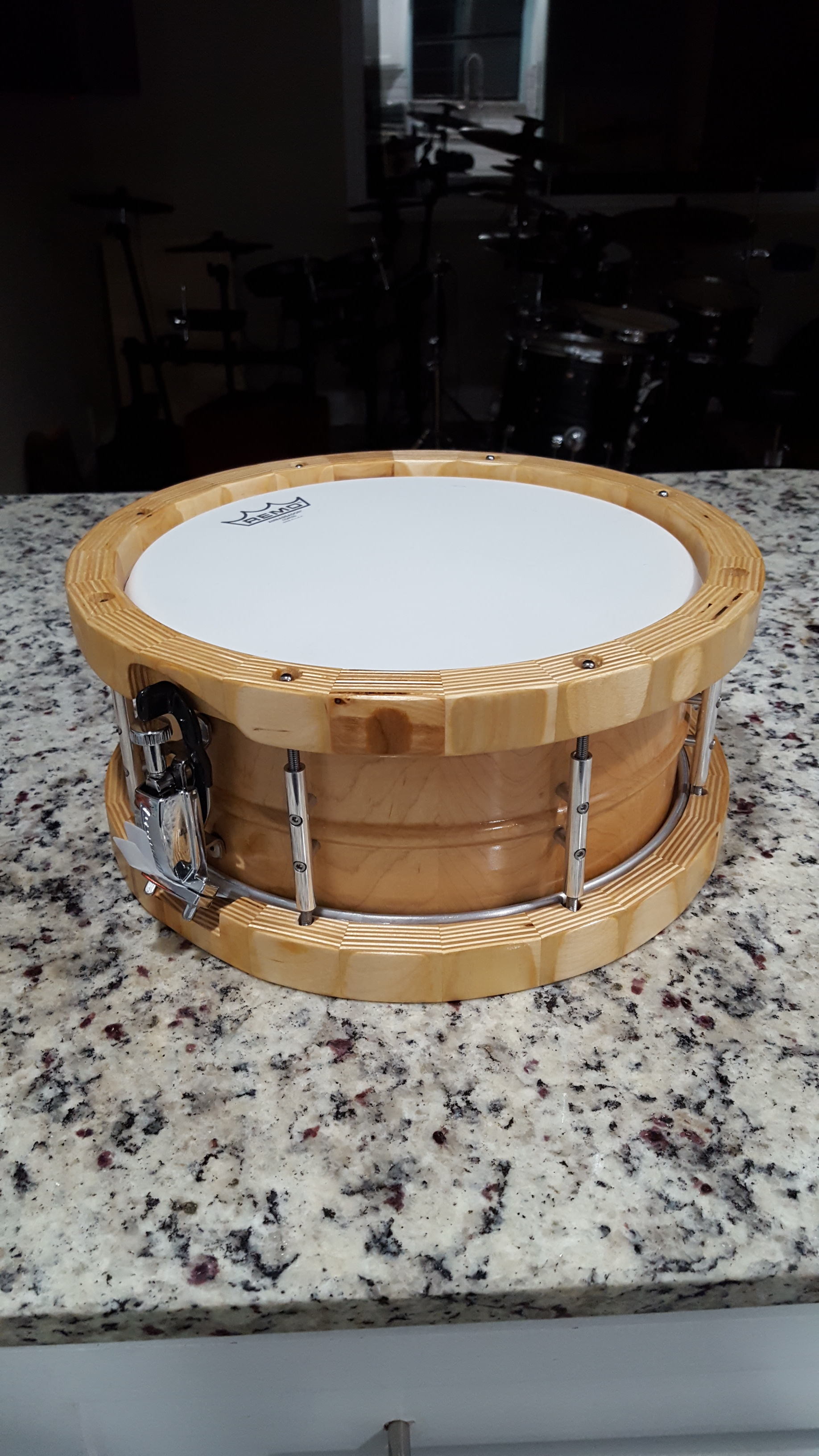

Maple stave snare drum with birch ply hoops.

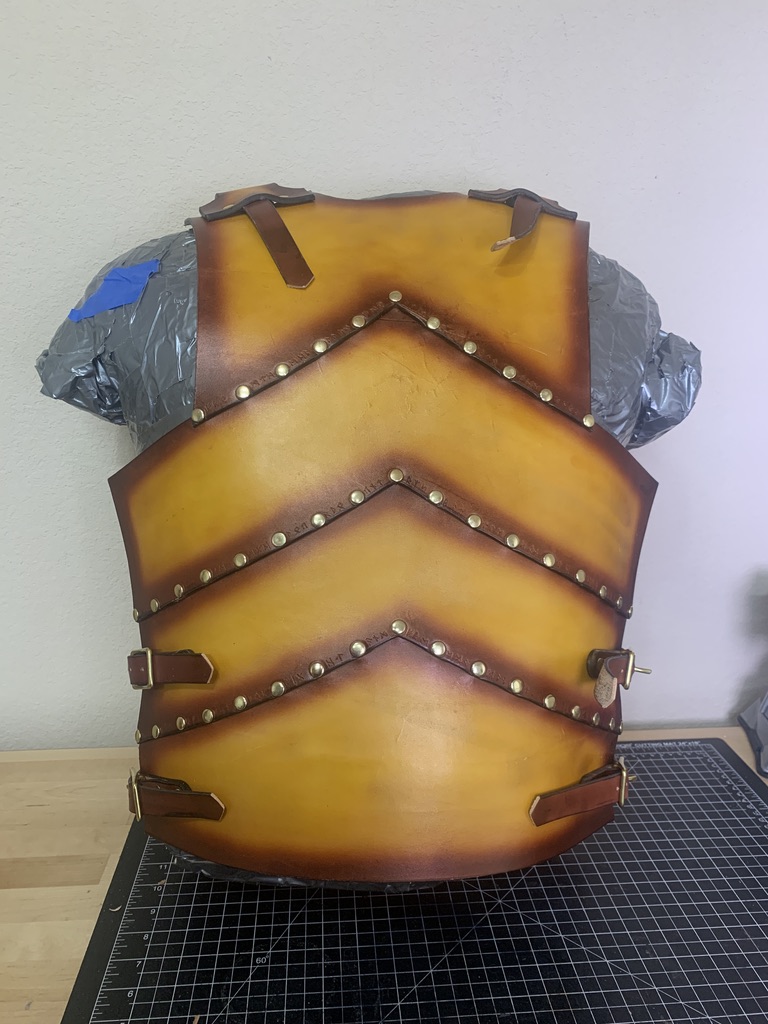

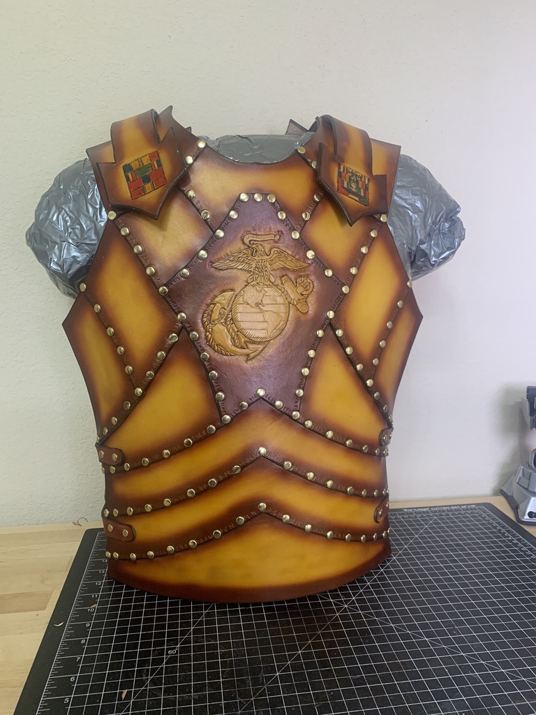

I finally finished this. My first all original armor piece. Built a mold of myself and made a pattern. Digitized it and cut this out on Big Thunder a few months back. Finally got a chance to finish it.

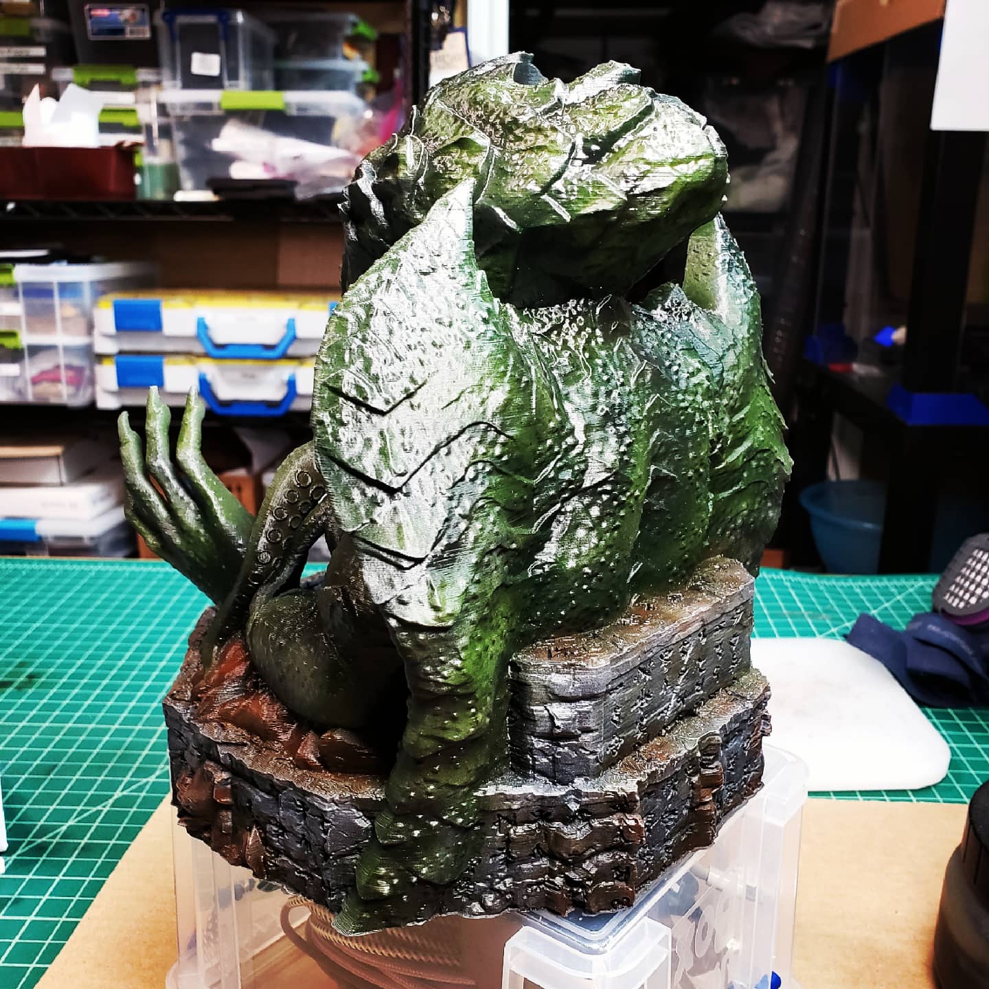

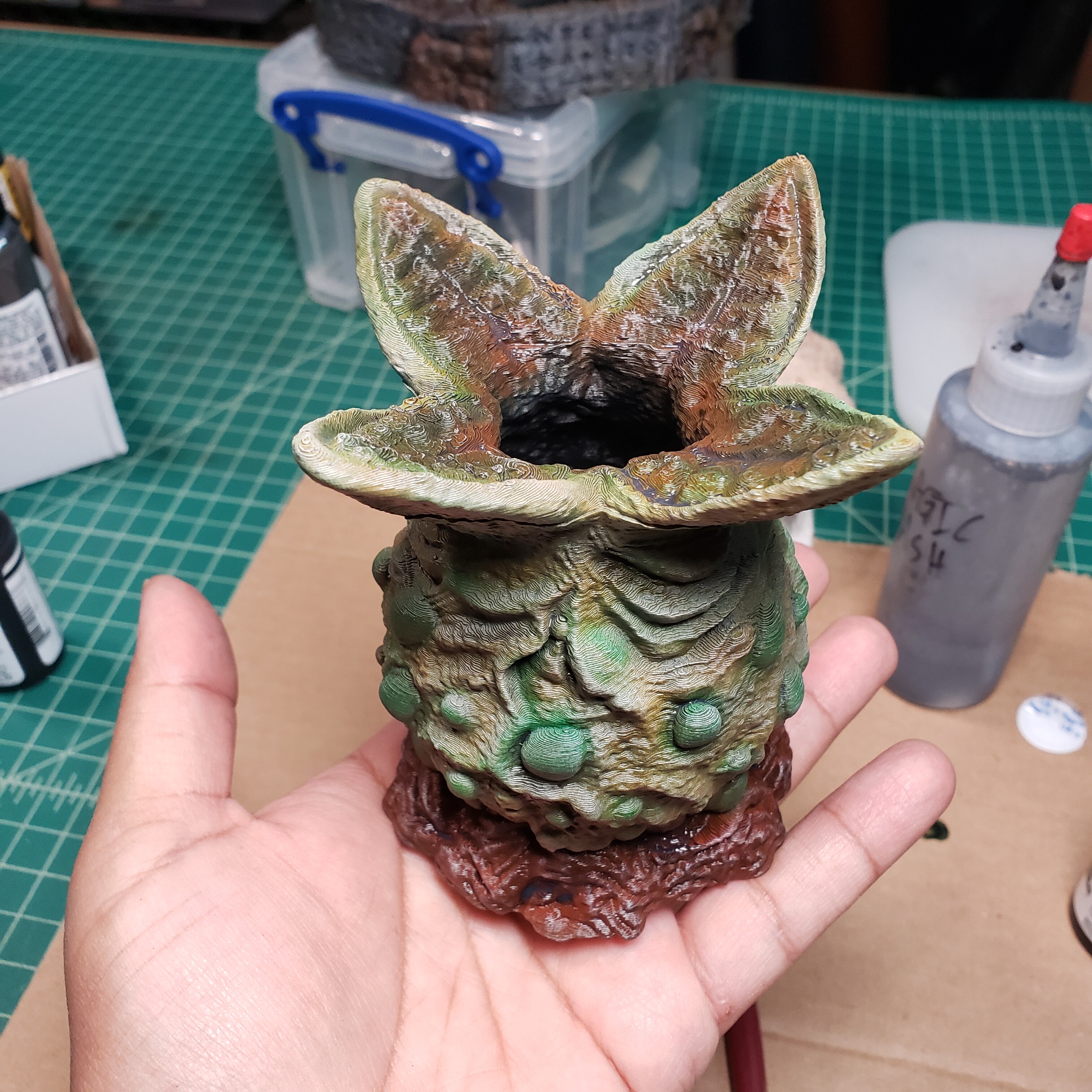

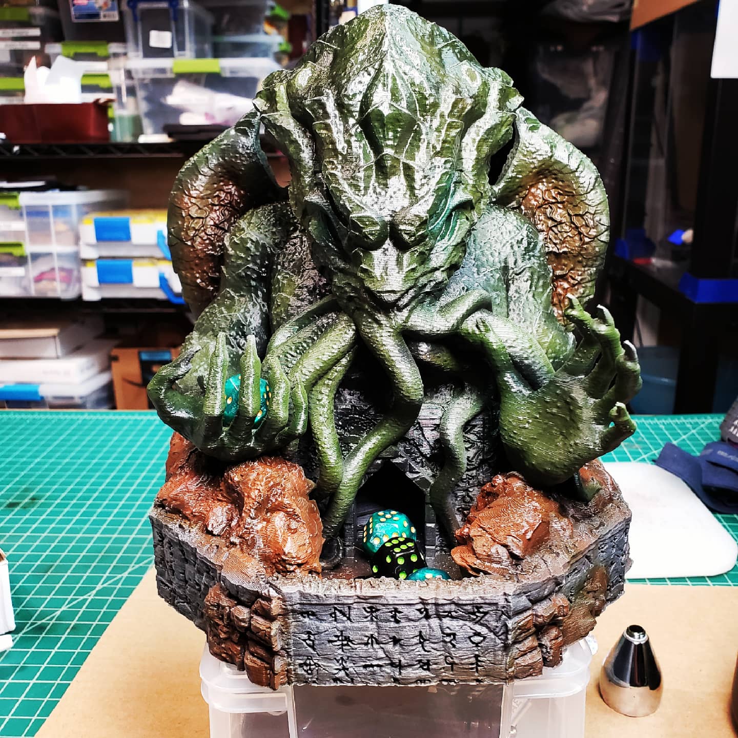

These prints are from a Kickstart I backed.
Alien Pod Dice Jail. 10 hour print in ABS at .2 layer height.
Cthulhu dice tower. 56 hour print in ABs at .2 layer height.
Printed on my Prusa i3 MK3s painted with Golden High Flow paints and my Grex airbrush.

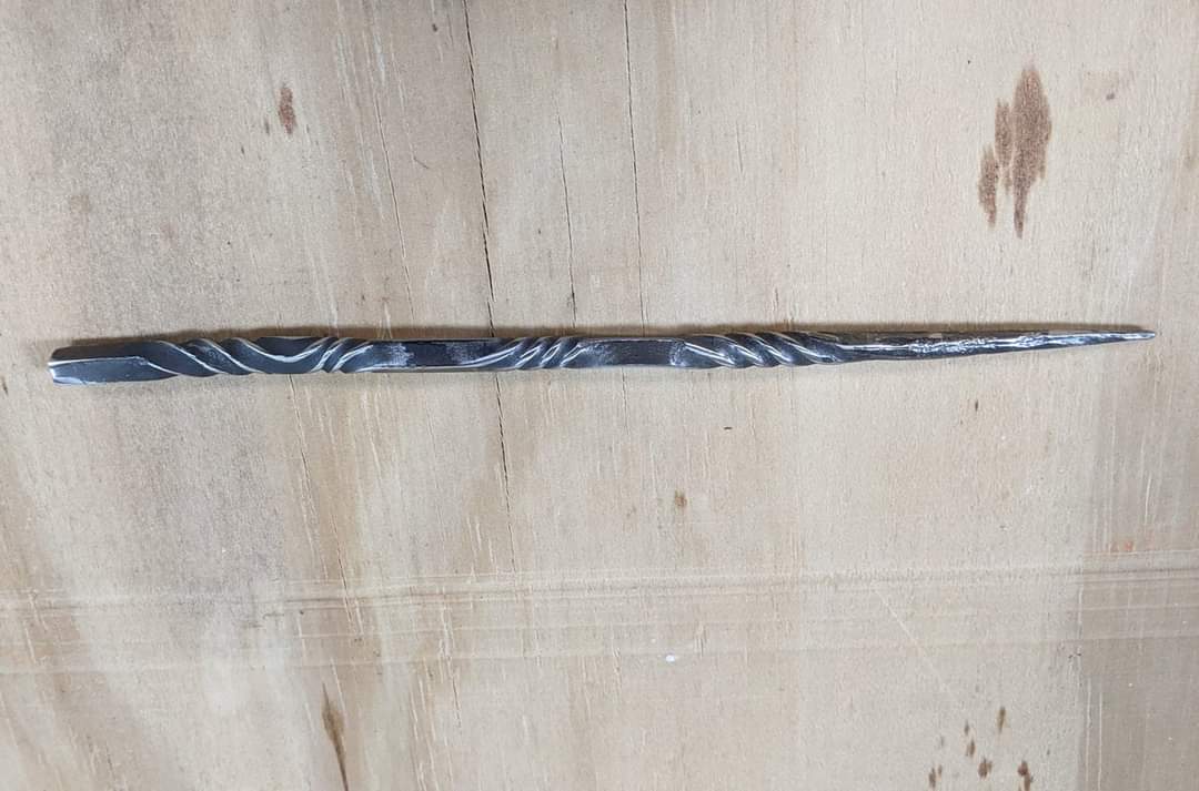

Blacksmithing class :grin:

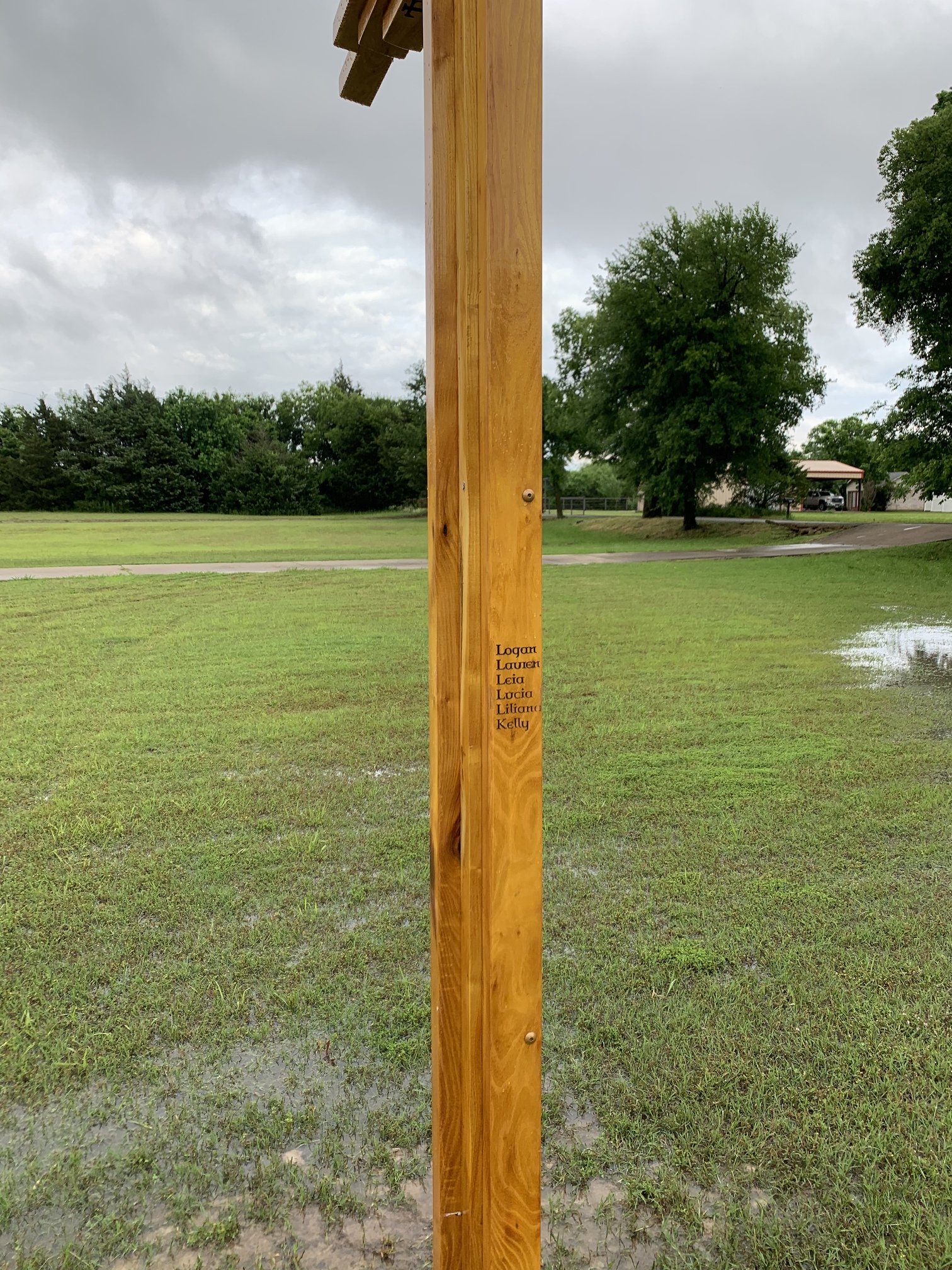

I was able to get the Osage Orange “”, Bodark
It was a lot of fun and I learned a lot in the process.

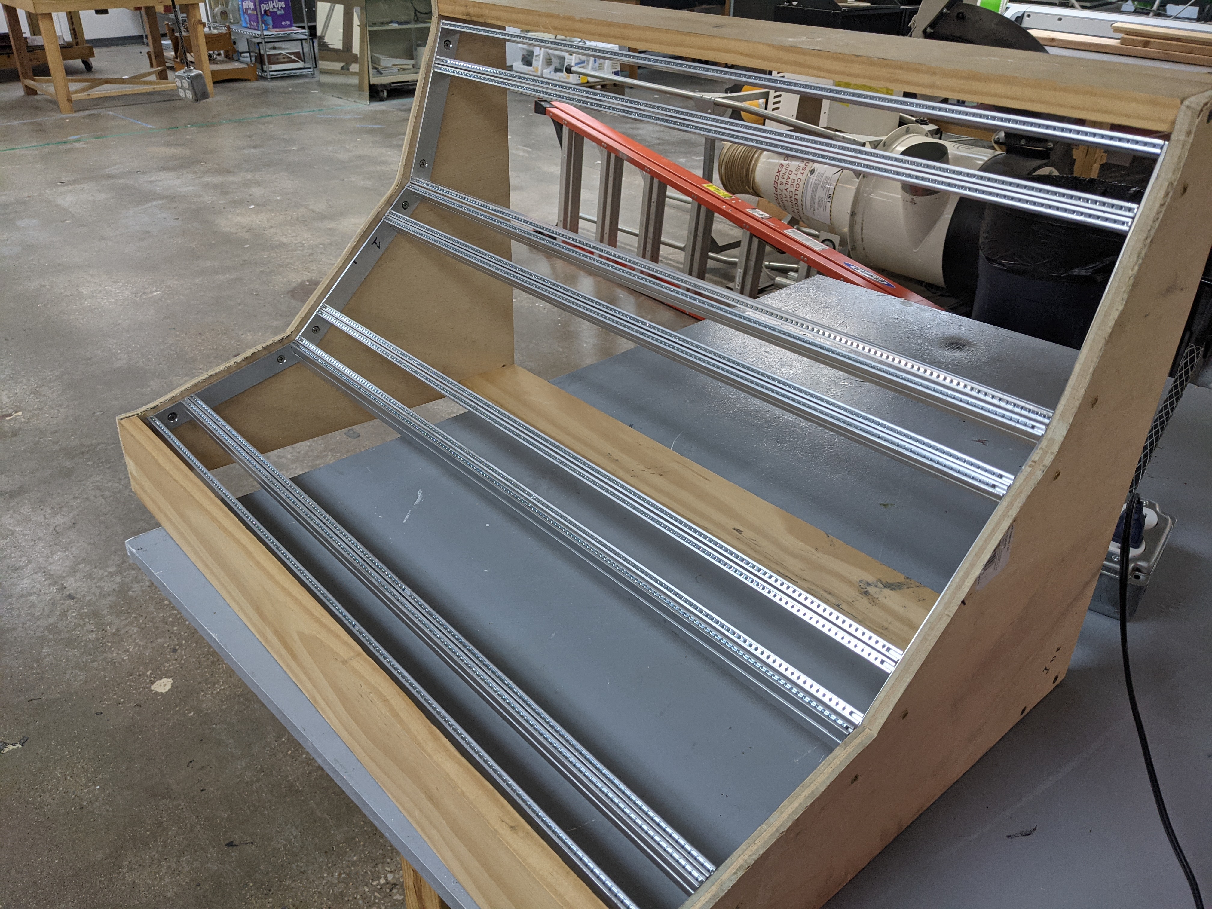

I finally got around to ( partially ) assembling the rack for my eurorack synth.
This was a mock-up of a future version that I want to make fold up for better portability. This would have been the opened up geometry.
This revealed a design flaw. It’s too deep for everywhere I have to set it up. So back to the drawing board.
