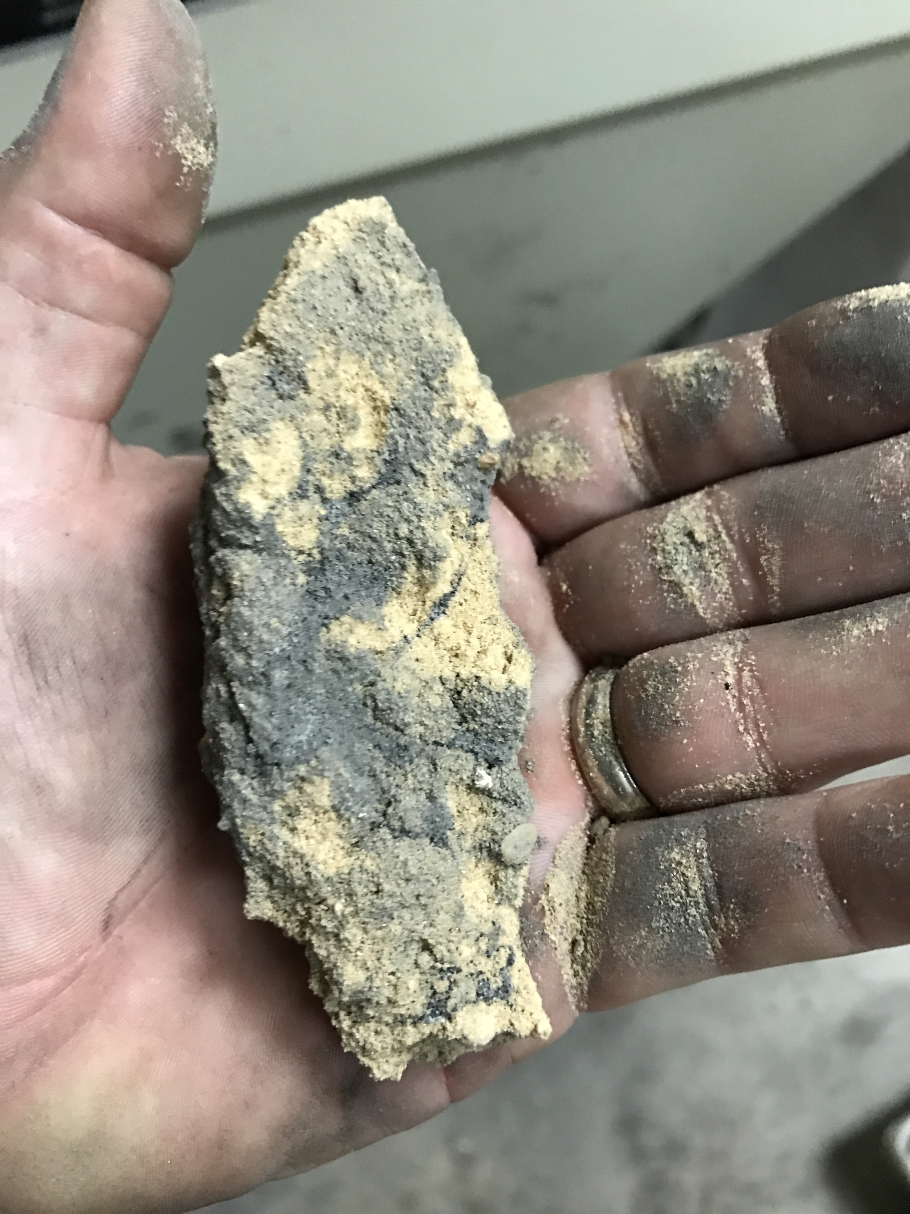

This is what crap was in the sandblasting cabinet
Someone needs a vacation from Metal Shop for blasting wet, greasy, or oily items. That is just ridiculous!
When I did my rusty crusty pinball legs before getting them powder coated, I scraped off all the loose crap and cleaned off ALL of the PB Blaster I had to use to get one of the feet removed. NO oil went into the machine. Someone was just lazy.
