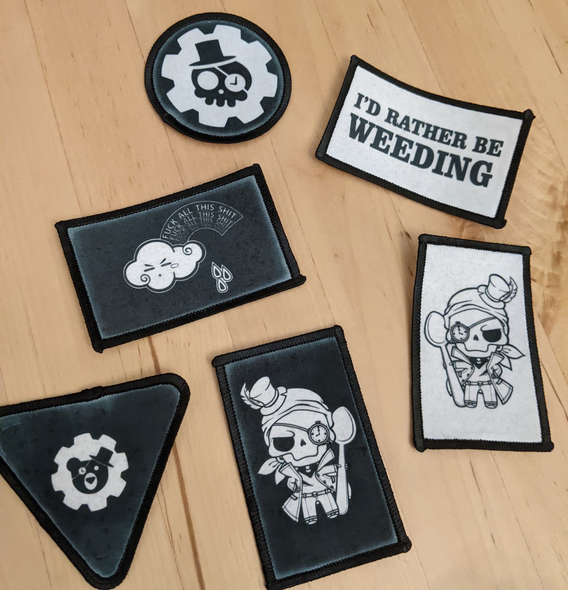

Why don’t we just print up some mechanic patches for your shirts? We can do that in dye sub for around $5 in ink (total) + $2/patch.

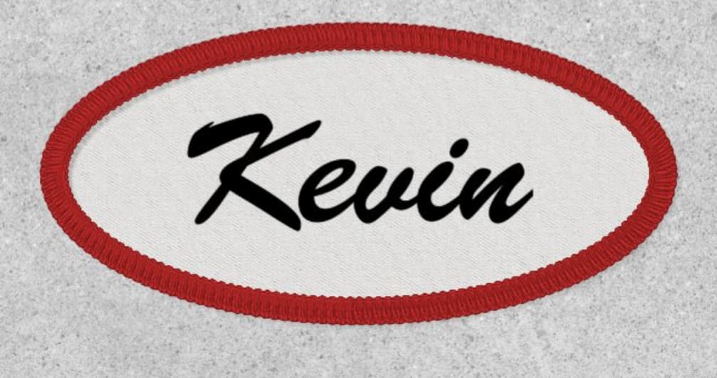

May i see an example of the patch?
Here are some examples from online-
You buy blank sublimation patches, we heat set the color images into them, you sew them to the shirt.
Design considerations- I would do your logo on a white background. Edge to edge color seems to fade right at the stitching and looks weird.
These are patches I made. You can see the fading near the stitching.
