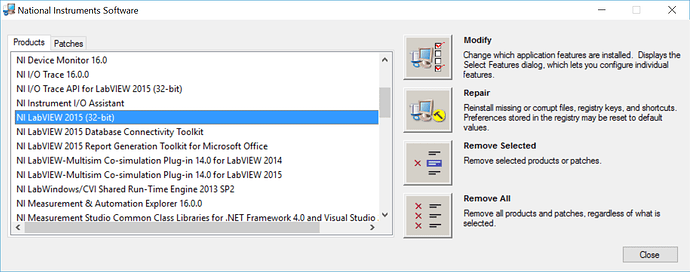

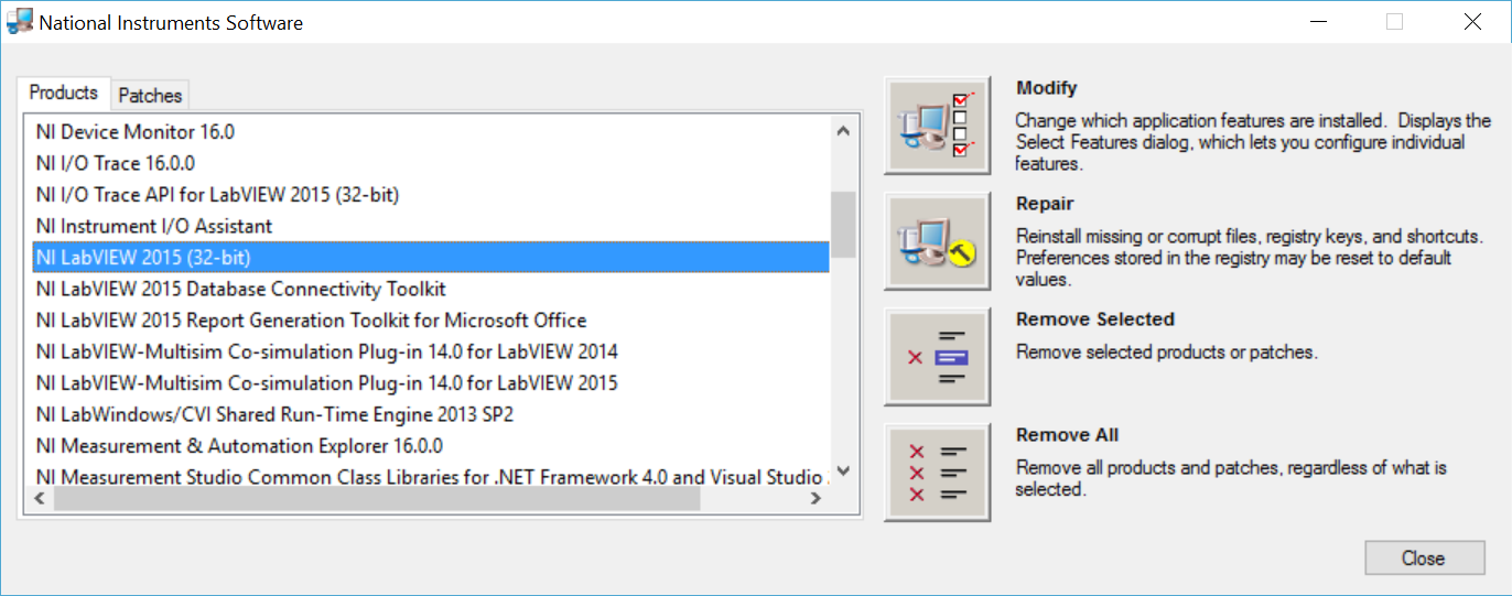

In a minute, I am going to attach a screen-shot of what you need to be able to see in order to be LabVIEW and device drivers install ready.
As an update, I downloaded the latest release of NI Drivers. It was 10 Gig alone. So I will now suggest that to take this class, you may need as much as 15 Gig free harddrive space. While I recognize that this is a lot, the skill learned through this class is worth A LOT in the industry. Those who have it remain fat in general, and I’m not taking about their body size.
I’ll be attaching screen shot showing what you need to see to know when you have labview and device drivers appropriately installed.

I just downloaded the latest set of NI Device Drivers, which atendees should install alongside a copy of LabVIEW, PRIOR to coming to class. The downloaded file was 10 Gigabytes, and it was compressed. So it must extract first, which will take forever, then you can run setup and it will auto install.
So I want to give you guys a heads up to expect that you will need significantly more that 10 free gig for the installation of LabVIEW & Device Drivers. I would guess that 30 Gig should be enough, but I am not going to commit to any number other than to say, you need significant free harddrive space for installation. You can recover a bunch of it by deleting the .zip and extracted .zip files after installation.
Here are the links for installing LabVIEW and Device Drivers. There are 2 major installations and it will take hours to get this stuff iinstalled with a blazing connection an on a fast computer. I can assist with Windows installs. I know not about Apples and Unixes. Here are the links:
Troubles with installation? PM me directly. Just pick any of the labview installation options. Education is a good one, as we will be educating. I can help you get edcuational option enabled, but fair warning, it will have a big splash that it is educational/evaluation software across any and all front panels as you use it. You must pay for commercial version when you are ready to make your millions/billions.
Just use default options and let the drivers install as they would like to. Be sure to uncheck the box for disable windows fastboot. It comes up on screen by itself. Applicable only to Windows 8 and 10 users, fastboot allows you to boot fast, surprise! I like this feature, and so I don’t want NI to disable it so that it never works. The thing to know here is that often, a full boot from scratch is required to properly install and reset drivers. Since NI uses extensive hardware calls to interface to the outside world, often NI tools need full reboots. You may need to induce a full reboot occasionally when working with NI tools, and often windows will omit full in favor of fastboot. So just be aware if you follow my advice of the distinction and what to do if your NI stuff is acting wonky…full reboot is in order…
Once the software has been installed, you should be able to go into programs and settings from control panel and run the NI software listing where all the programs are, and you will arrive at a screen that looks like my pic below.
In this tool, be sure you have labview installed, 488.2 installed, NI-DAQmx installed, NI-VISA installed. If any of these are not showing up upon installation of LabVIEW and Device Drivers, please let me know and I can help.
