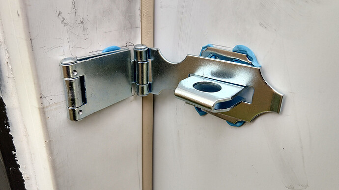

Poster putty made placement simple with this mildly complex fitment
Was able to swing the hasp out and hold the staple in place for marking holes

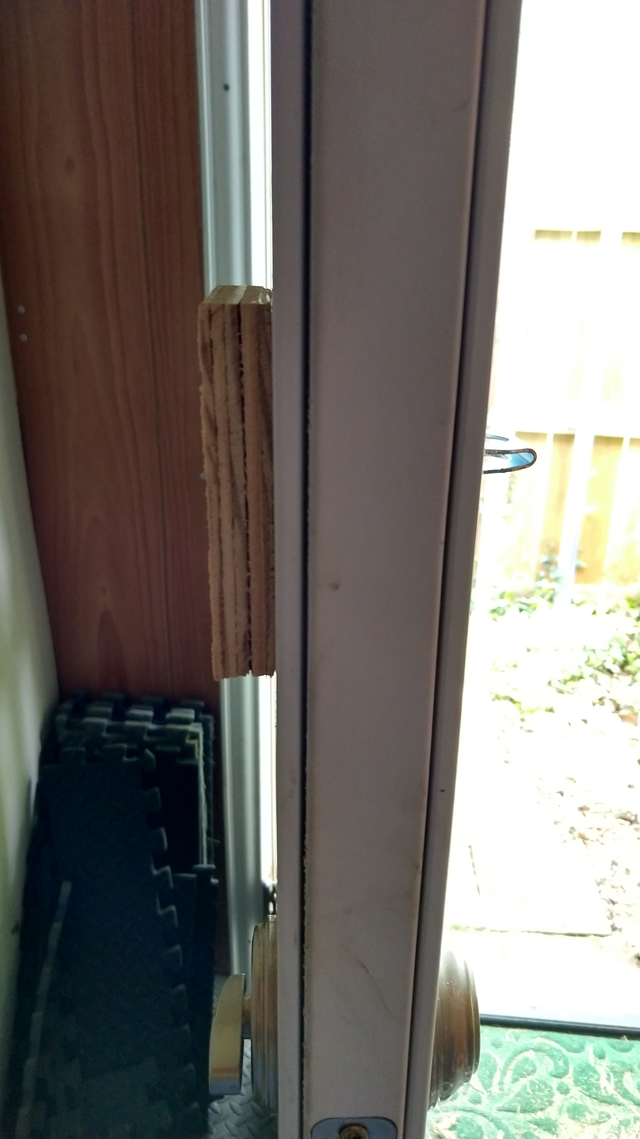

The block for the lockset didn’t go end-to-end … :expressionless: … thus I used longer screws than planned in order to adequately secure the staple by sandwiching the door*

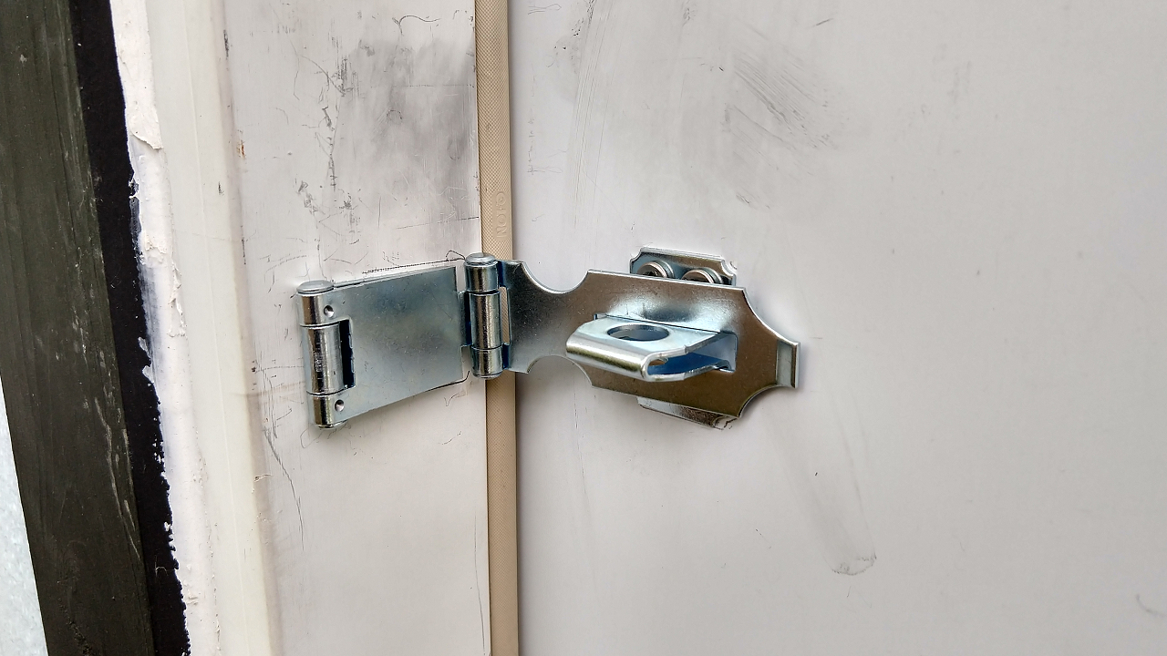

Success - everything lines up*
A little bit of cleanup and now it’s somewhat sturdier

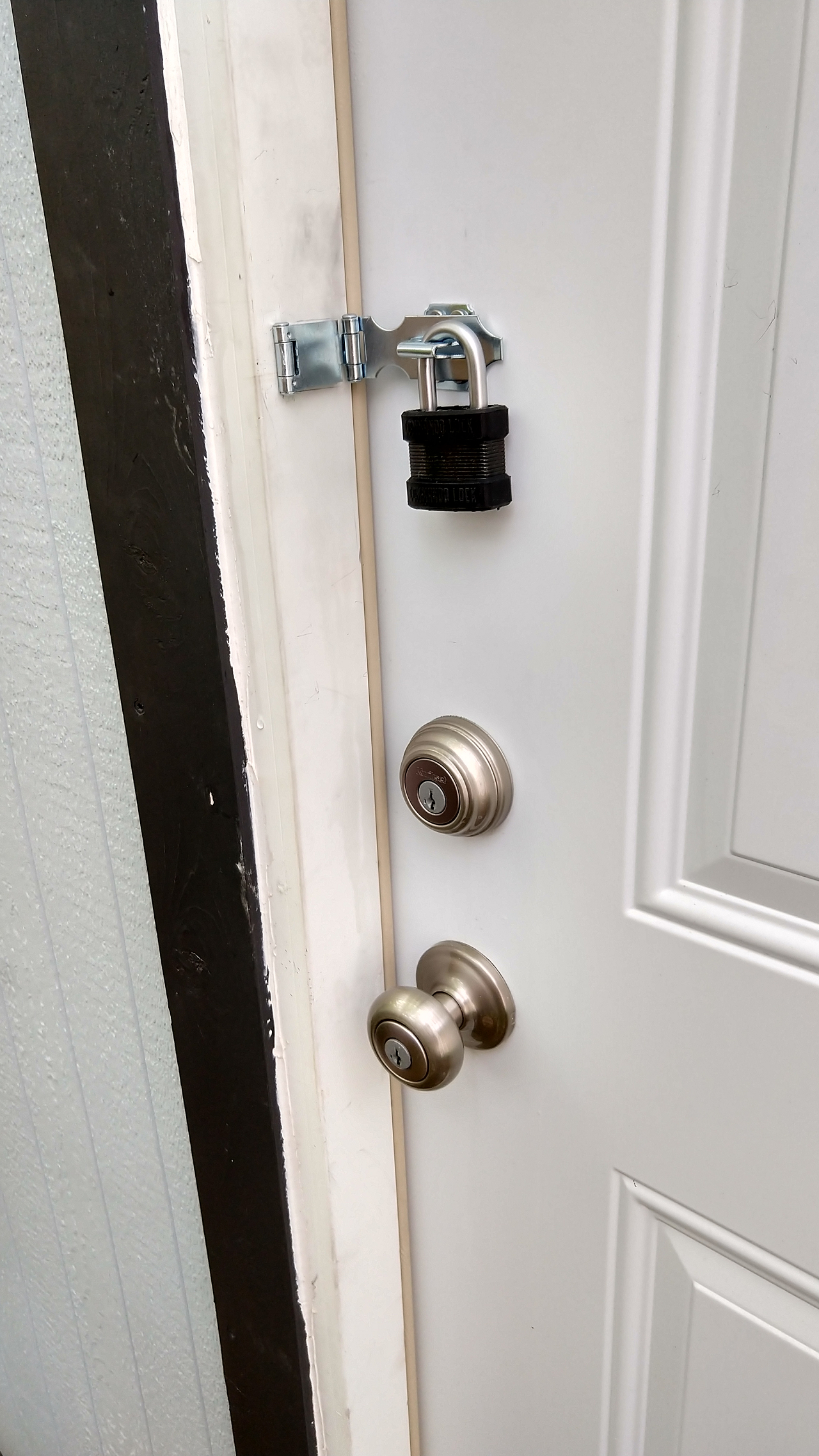

In reality all that I’m doing with this mod is a little added discouragement beyond that which the lockset provides and mandating that any would-be burglar makes more noise and takes more time than they’re likely to want to invest.
