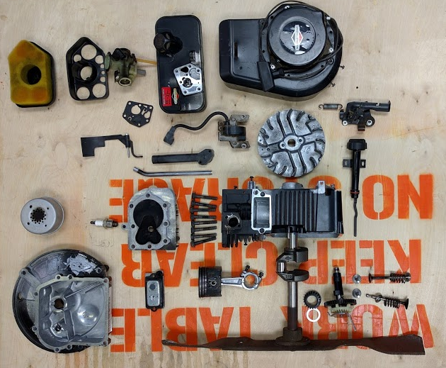

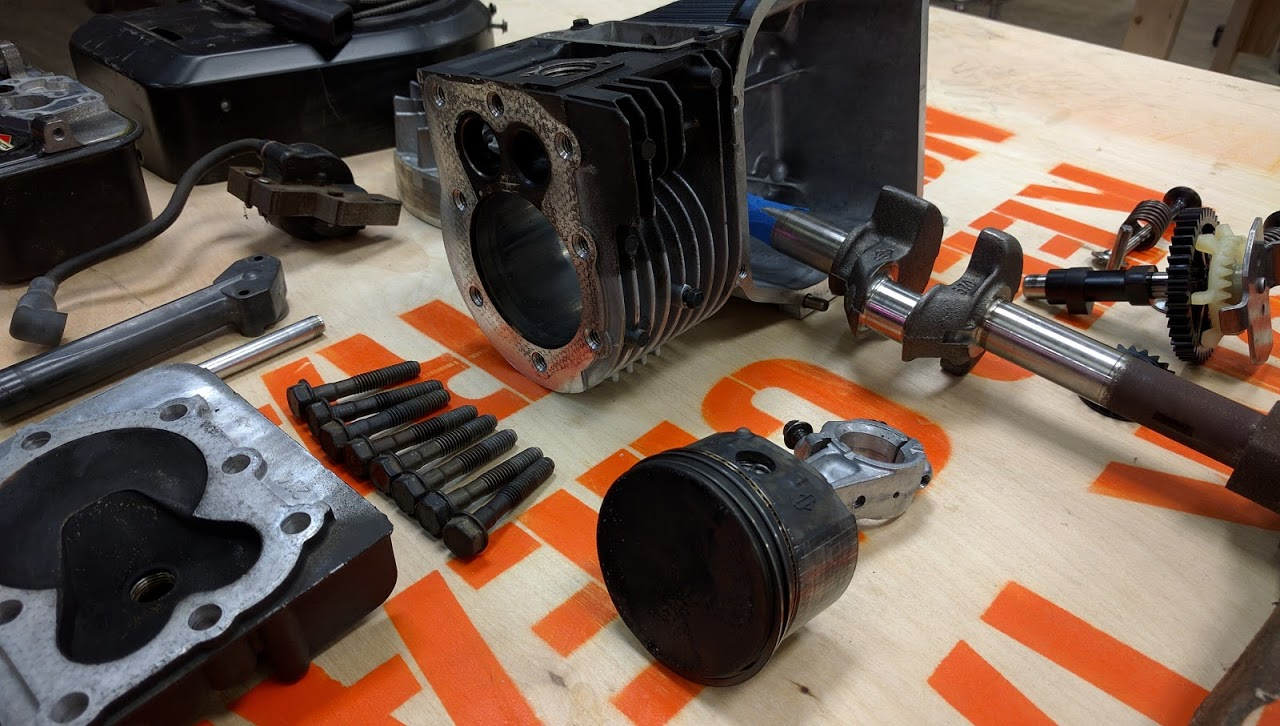

I had an old mower I haven’t used in a couple years, so I decided to take it apart, step 2 will be seeing if I can put it back together, getting the valve springs back in will be tricky without a proper spring compressor.
It has been a long time since I put a valve spring back in one of those. I think I used grease to hold the keeper wedges on the stem, then used a pair of stubby needle nose pliers and a small block as a lever and fulcrum inside the valve chest to compress the spring and and endcap, and button hole it over the keepers.
http://www.diygokarts.com/vb/showthread.php?t=6920
could probably duplicate that bad boy from the scrap bin…

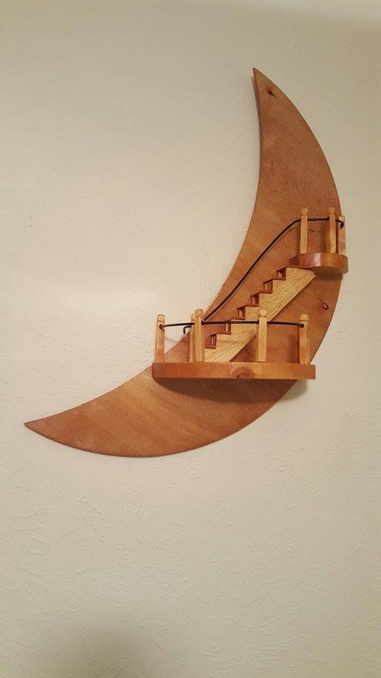

This is a piece of folk art exactly like the one that hung on my grandparents wall and made by my uncle in the 1930’s. It was a Christmas gift for my daughter. The rail on the original was 14 g. copper wire but mine is 3D printer filament.

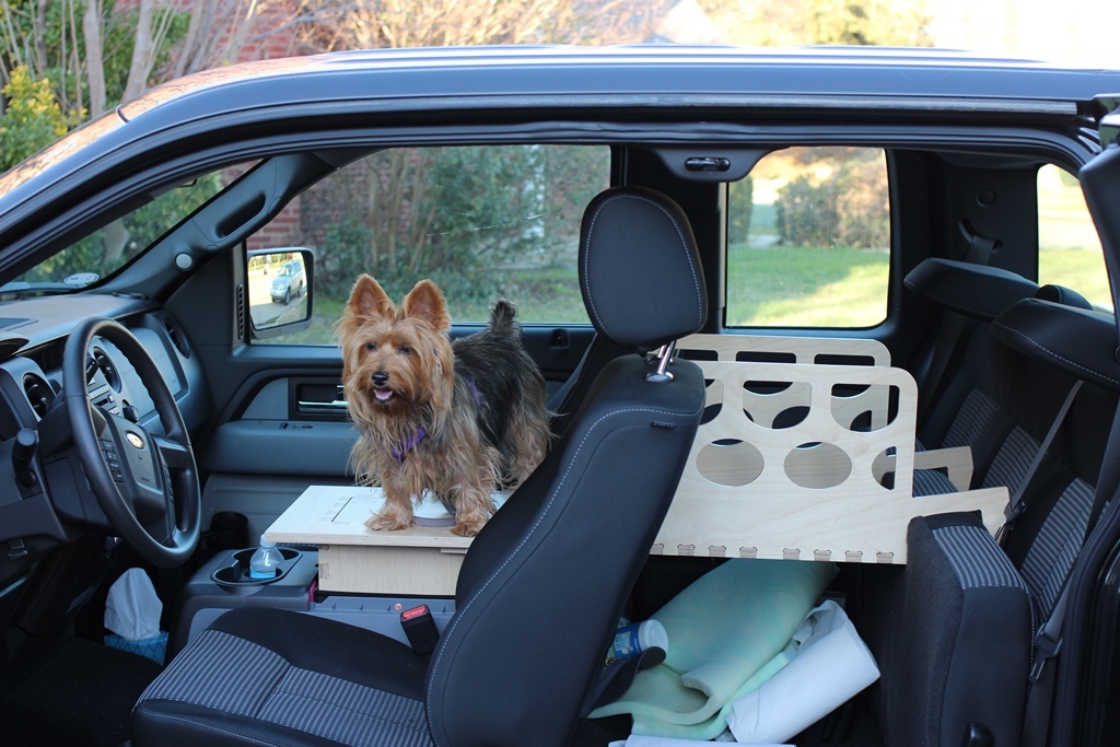

Caitlin’s Pedestal
18 mm Baltic birch plywood cut using the Multicam assembled like a puzzle. There is a short leaf for when we have guests in the back seat.

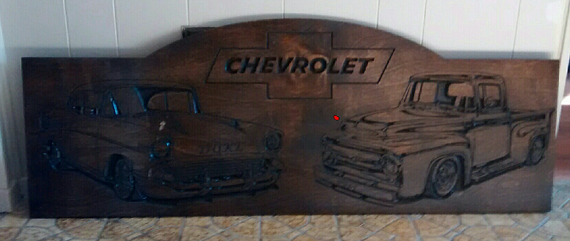

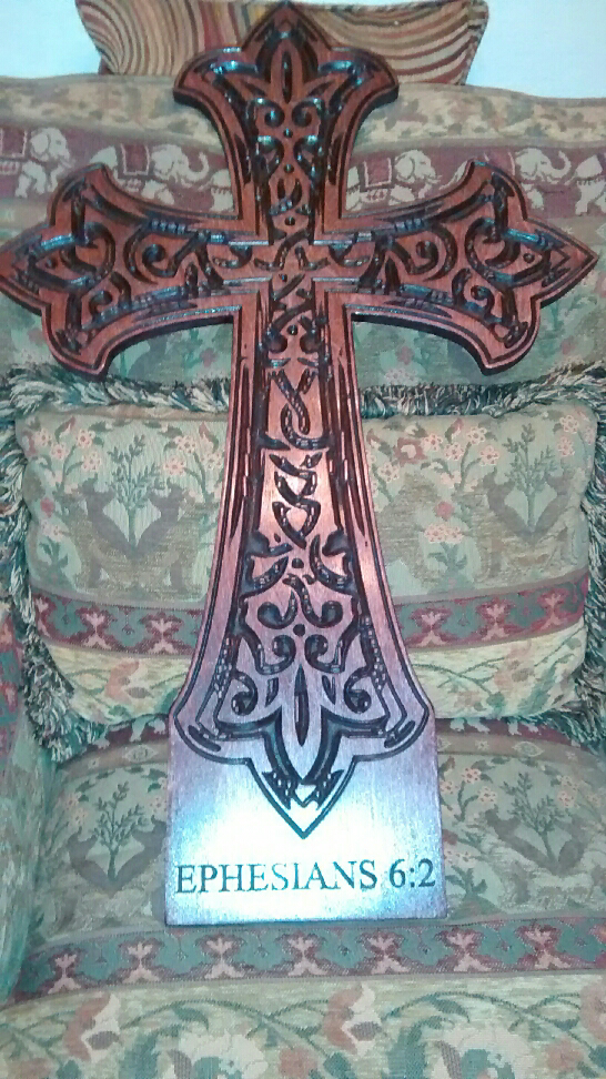

couple of projects on done on CNC

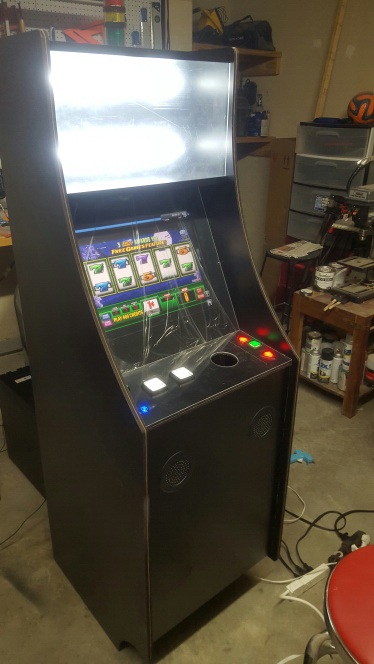

Virtual slot machine.

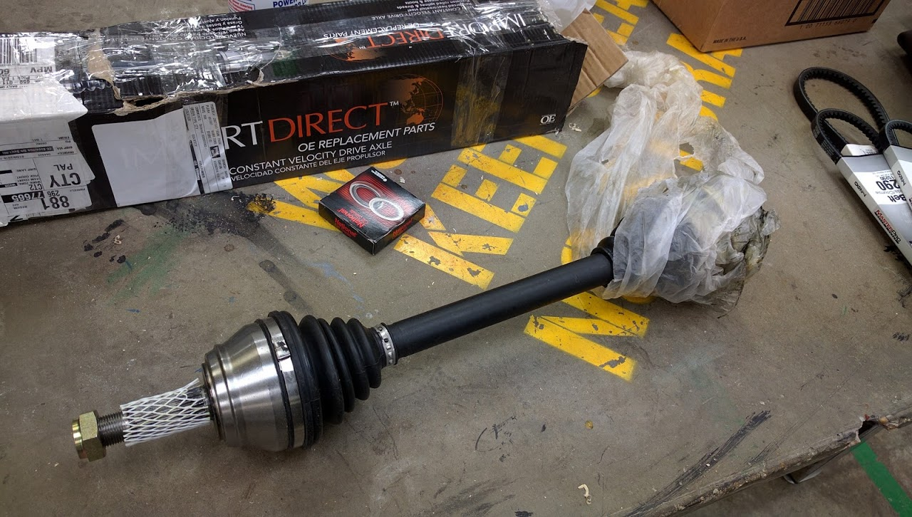

Worked on replacing the CV axle on a VW cabriolet, having a metal shop to put together a custom puller comes in handy. The goal being replacing the seal to hopefully stop a transmission fluid leak.

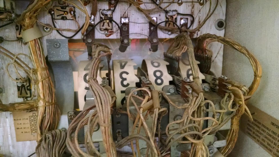

I’m working on restoring a 1974 Bally Flip-Flop. It’s difficult to take photos showing progression since all of the work so far has been mechanical rehab: disassembling internal components, cleaning mechanisms, lubricating, adjusting, function-testing.
Detail on a score reel prior to rehab. Reels themselves are dirty and the mechanisms don’t actuate.
The disassembly process commences. Clean each score reel (and hope that you don’t wash off too much lettering). Burnish and adjust the switch for the 9-position. Clean the axles/pivots. Polish PCB contacts. Apply a dash of lube to each axle and pivot. Test the mechanism. Tweak spring tension as needed (typically pull 2-4 loops out to ensure reliability). Repeat 15x more for the rest of the score reels.
Now that you’ve gotten all the score reels clicking along properly, work on all the other components! Steppers need a rebuild just as extensive as the score reels (mercifully, no real need to clean the numbers). Relays need tuning. Broken wires need to be noted. Resistance on coils must be measured (some have likely burned up over time). Maybe you want to plan on replacing all those light sockets. You might also want to track down a font for re-lettering the score reels.
