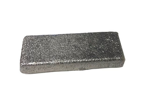

If it were me I would cast it in woods metal. Don’t know if that could survive nickel/chrome plating though.

  1. I have no clue what woods metal is

Woods Metal is a low temperature alloy. By low I mean below boiling water. I have some as low as 140 degrees F. You could make a mold out of pretty much anything and cast the panels. Then weld them together with a hot air gun.
I used it to bend small diameter tubes for model train engine piping. Truly is magic stuff. Not cheap, about $15/pound.
EDIT: On sale now for $9/pound
