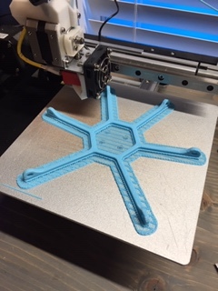

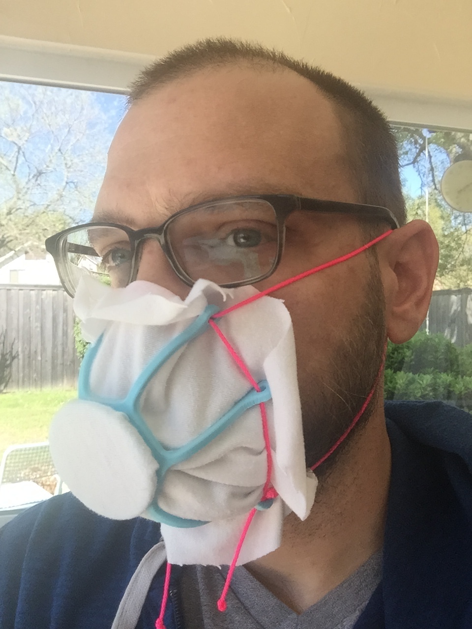

Most of the world is at a “better than nothing” stage on PPE. Cloth masks filter about 50% of the particles and can be cleaned to be reused, so lot of people are pushing to make those. I’ve tried a couple of 3D printed face masks posted online. Each are multiple pieces, take 2-4 hours total print, porous surface, and potential holes from print errors.
I think 3D printing holds better solutions. Medical grade may be beyond the troops working at home, but clean, disinfected parts are possible.
My current thought is to make a small flat printed frame that can be formed with a heat gun. Cut and place a sheet of 3M HVAC filter in the frame, and secure with elastic bands. Depending on form fit, possibly adding a rubber rim with Sugru or some cut rubber tubing.
Though there’s more post processing, it should get the prints down to 20 minutes and use 15 g instead of 100g of filament. Also bending into shape nixes most of the standard Z-axis weakness of FDM. The design still needs a lot of work. I’ll post progress pictures later.
IMG_3107 IMG_3109 IMG_3111
The design still needs outside fabric securing and a jig for heat forming, but the proof of concept kind of works.
Pros:
Mask without sewing
Mass production: Shorter print time/ less filament than other 3D masks
Full filter coverage (not relying on print integrity)
Cons:
Printed plastic is single use
Single unit: printing mask and jig will take as long as other mask prints
My Net:
Sewn masks with a non-woven cloth insert beat this out, because they can be washed and reused.
What do you think? Is it worth pushing this design further?
I applaud your ingenuity, @MerganMcfergan. I think it’s a goid start, and can be revised to make it better.
The advantage of the most recent sewing design is a pocket where nurses, etc. have been putting coffee filters, hepa filters, and whatever they can get their hands on. The version you made seems like a single layer of cloth, and isn’t reusable.
It’s a good first draft. How do you think it can be modified to match the advantages of the cloth designs?

Thanks @Holliday! My note was really a long winded vote for hand sewn masks. I provided details of my attempt hoping to spur someone else’s innovation.
Regarding filter material, I have the filter wrapped around a large ring and pushed through the smaller mask hole. The securing system on the front could handle your choice of 2-4 filter layers. I just stopped the testing at one layer of fabric, because single use can’t beat washable/reusable.
