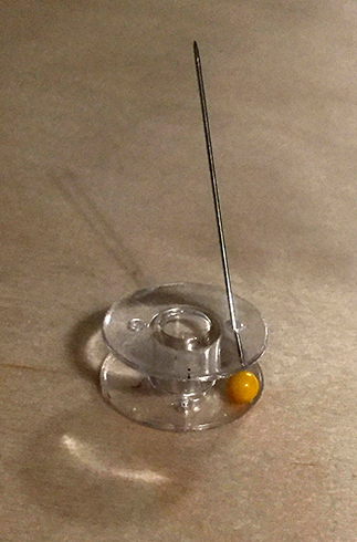

Here’s one way we could test the other bobbins. We can use a sewing pin as an extractor handle for the test. Take a sewing pin with a large glass head. Pass the pin through one of the tiny holes in the bobbin so the head is “inside” the bobbin. Place the bobbin in the bobbin holder. If it can’t be removed, use a pair of pliers to grasp the pin and extract the bobbin. Then, of course, we still need to see if it fits into the Janomes.

The problem is that once you put one of the offending bobbins in, you have to pry it out. If someone is less gentle than I was, it could destroy the metal bobbin holder. That’s my concern.
