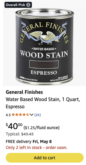

Great question! The first thing to know is that white woods like maple don’t always take stain evenly—they can get blotchy or patchy because of how the grain absorbs color. To fix that, I highly recommend using a pre-stain conditioner before your stain to help the finish go on smoothly and evenly.
My favorite brand is General Finishes, which you can find at Rockler or Woodcraft, or order online from Amazon. If you visit Rockler, be sure to mention that you’re a Dallas Makerspace member—they’ll sign you up for the Guild Program, and you’ll get 10% off every purchase.
General Finishes makes a beautiful Espresso shade that looks great on maple. Rockler often has samples you can test right there on your piece before buying—plus, they usually show how different stains look on various woods, which can really help you decide.

You don’t happen to have this General Finishes Espresso stain do you? I didn’t realize how expensive it is and i only need it for this one small thing so if you have some and are willing to share I’d be happy to pay per usage.
Sorry I do not. Good finishes cost aren’t free sadly.
Many advanced wood workers tend to standardize around certain finishes. If a project requires something special, then usually the party that ordered the commission pays for the finish.
Walk the floor and talk to other woodworkers. Someone might have something you could use.

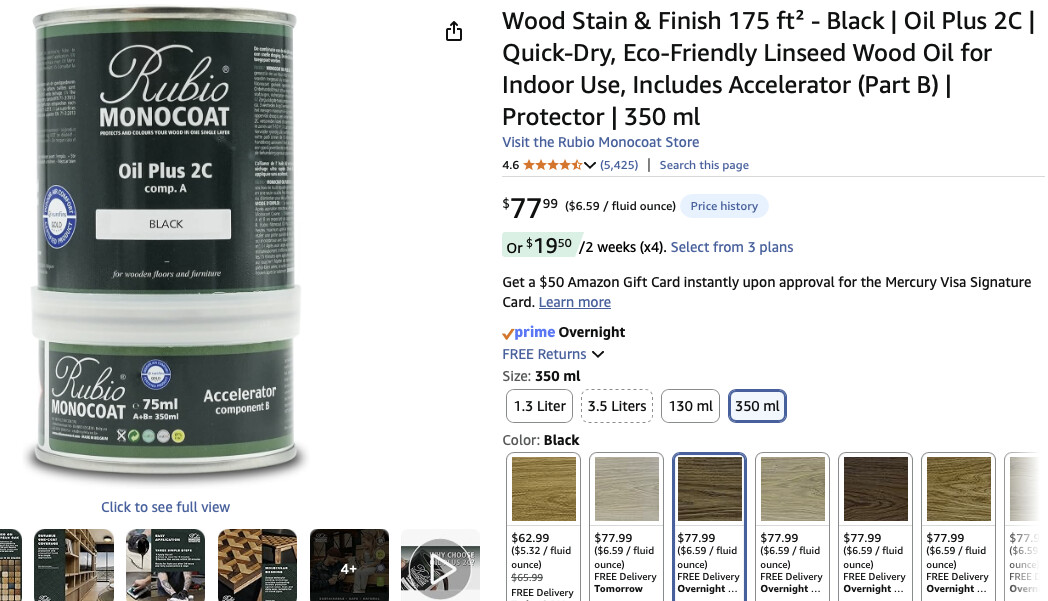

To place this into perspective and drive home HB’s point, we can compare your selected finish to the finish I prefer. Being a stain, your selection also requires a top coat.
My preference is below and notice small quantity compared your selection. This product is stain and sealer in one. For the same quart, your choice costs around $76 and my preference below would cost $210. Keep in mind the coverage is not one-to-one. The very small $80 can (1/3 the size) of my preferred brand will cover a lot of surface area, and has many other qualities that are wonderful. Its primary use is for hard wood floors.
