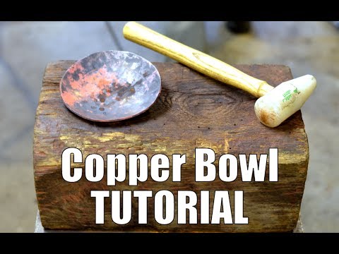

How are you going to make the bowl, hammered ro spun?
You may need to make some large stakes to help raise it over
Which YTs are you looking at?
On the plans are raising and Sinkiang c;asses this summer in JSM
Hammered. The methods I’ve seen online are all sinking. I’d be interested in taking more classes if they were offered.
What are YTs? Edit: YouTube. Got it. :woman_facepalming:
These are the two primary ones, but I’ve seen quite a few just to get a feel for the process.
