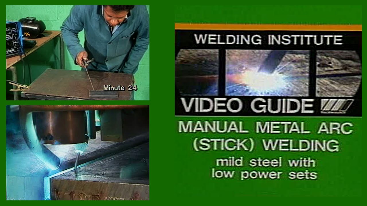

Everyone needs to learn how to “drive stick” before hopping on the MIG. You learn a lot of skill from having a simple, nearly indestructible setup which requires attention to arc distance, speed, manipulation/pattern, etc.
This is one of the best videos I’ve seen to teach practical stick welding.

@zmetzing - excellent recommendation on this stick welding video! I prefer stick welding and this video will (hopefully) help me to make welds that are less ugly.
