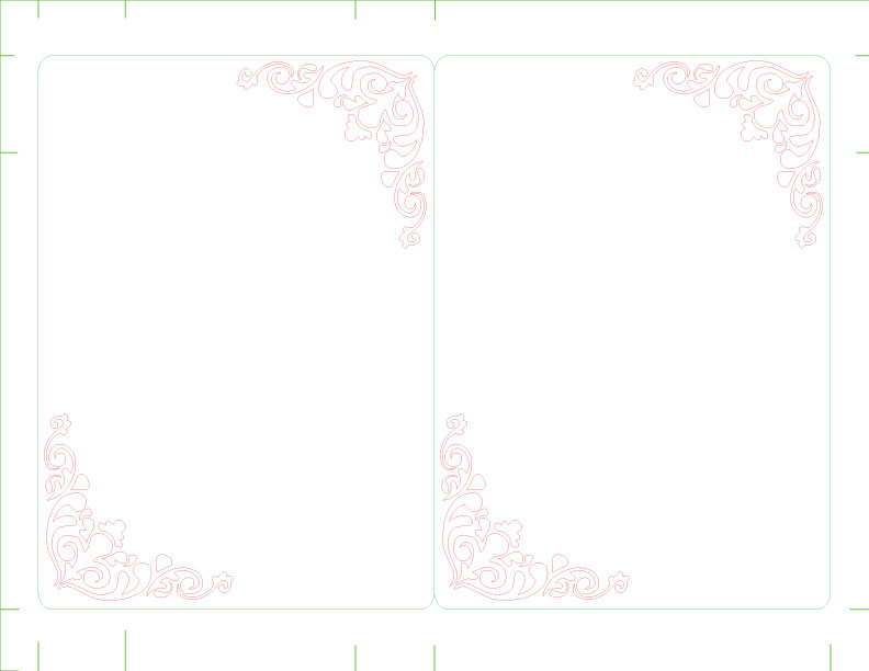

Chris, Thank you for the in-depth instructions. Attached is my cut design. I will be pre-printing all the text on 8.5"x11" cardstock. I would like to stack the job to cut multiple pages at once but have been informed that it is not a good idea because of scorching and gas being trapped between the sheets.
