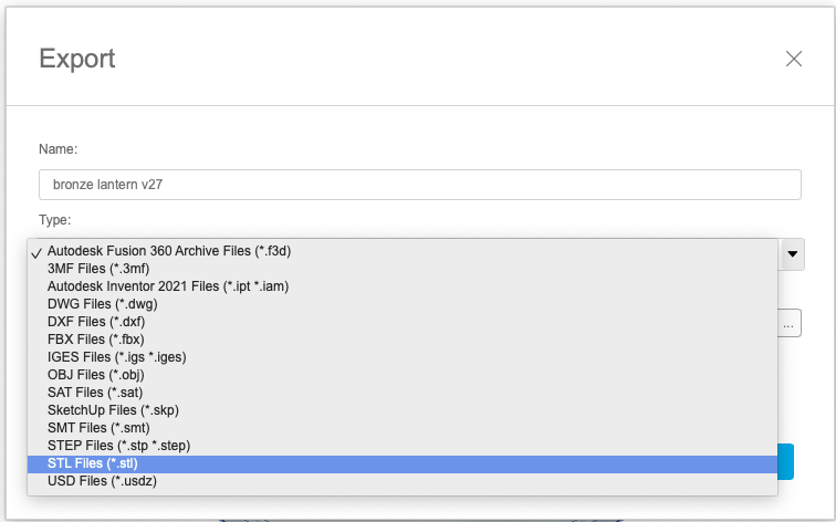

To output your Fusion 360 file as an STL formatted file ( {filename}.stl ) so the printer software can read it. Note there are various settings for STLs to make them fine or coarse detail depending on your model. You’ll have to experiment with them.
