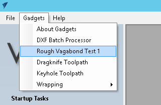

I just worked through the two tutorials on that webpage. Everything went flawlessly. I put the script here…
C:\Users\All Users\Vectric\VCarve Pro\V8.0\Gadgets\
(Note: This is the same location… C:\ProgramData\Vectric\VCarve Pro\V8.0\Gadgets)
As far as I can tell, the only potential issue is that location getting erased. But, that can easily be made irrelevant by making proper backups.
The only thing missing is the documentation. :wink:
Someone please connect to the Jump Server then navigate to this directory…
Is there a file named Rough_Vagabond_Test_1.lua in that directory?

Got it. I see your test Gadget FWIW :smile:

If Vectric has support for per-user Gadgets I cannot find it.
These shared locations work…
C:\Users\Public\Documents\Vectric Files\Gadgets\VCarve Pro V8.0\ C:\ProgramData\Vectric\VCarve Pro\V8.0\Gadgets\
Alias for the one above…
These per-user locations do not…
C:\Users\YourUserName\Documents\Vectric\VCarve Pro\V8.0\Gadgets\ C:\Users\YourUserName\Vectric\VCarve Pro\V8.0\Gadgets\ C:\Users\YourUserName\Documents\Vectric Files\Gadgets\VCarve Pro V8.0\ C:\Users\YourUserName\AppData\Roaming\Vectric Files\Gadgets\VCarve Pro V8.0\ C:\Users\YourUserName\AppData\Roaming\Vectric\VCarve Pro\V8.0\Gadgets\
