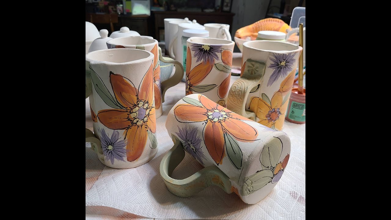

My thought is that it’s the effect of being watered down. Cone 6 is a bit high for the underglazes. While most of them keep on keeping on, they may require that heavier coat to maintain color. Let me find my post. I pulled 2 videos from ladies who do watercolor underglazes – one on bisque, and one on greenware. They may say what clear that they use.
Here’s the first one:
Anne Ewing Ruel (or is it Ruel Ewing…) is the greenware one. She posts lots of pictures in the Amaco FB page.

I watched her video and the kiln unloading with the final result and felt like hers had a change as well ( post firing) but hers were still more intense color wise. I’d have to say I watered mine down more than she did which is probably why the change was more pronounced on mine.
