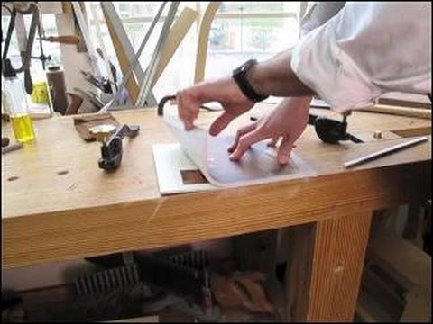

A bandsaw would handle this well, I think. Even a handsaw:
If using a handsaw, a flush cut style will probably work best for this.
