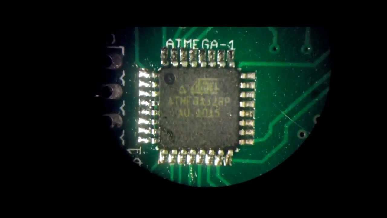

Its really not hard, even with a normal iron to do this. Video shows how to do it with no magnifier and everything.
I did a similar AVR chip once with the help of @dave. Heavy flux pen, dab of solder on tip, and swipe across. It was shockingly easy, and some people claim easier than thru hole parts.
