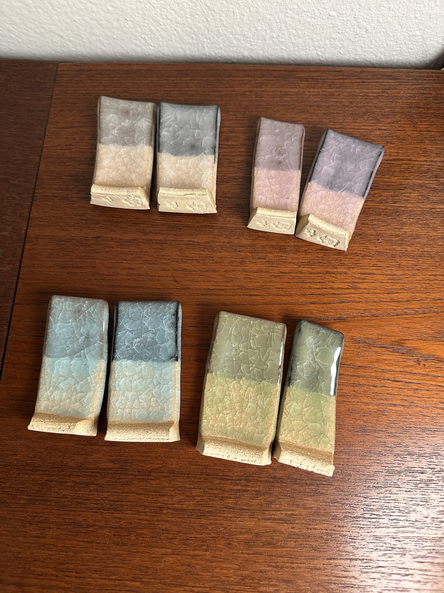

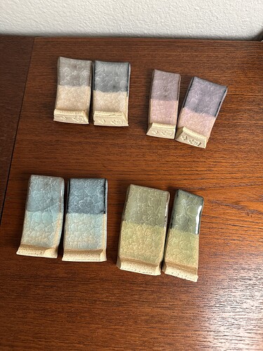

Test tiles are out of our kiln! 5 coats on white stoneware. Left to right clockwise: snow drift (white), arctic blush (pink), frozen fern (green), glacial lake (blue). For each color, the left tiles have brown engobe on the top half and right tiles have black engobe on the top. The darker color really does make the snowflake effect pop more. There is some pinholing on some colors, so I’m hoping the special program will aid that
Really cool results.
Were these run in a normal cone6 kiln vs the special program?
Yep our normal cone 6 in 1222. There are some pinholes so I’m curious how the special program will compare
That purple is so pretty. I wish I had something ready to go. Any chance y’all do this again in the future?
If so, do you recommend we do the underglaze layer prior to the event or will there be time during?
If there is demand then I’d love to do it again. I’d recommend putting the underglaze or engobe on during greenware stage so there’s no risk of smearing during glazing
Test tiles look good, the program posted essentially had a 30 minute hold after its peak temp during the cool down phase. I think that is there to help with pinhole issues.
