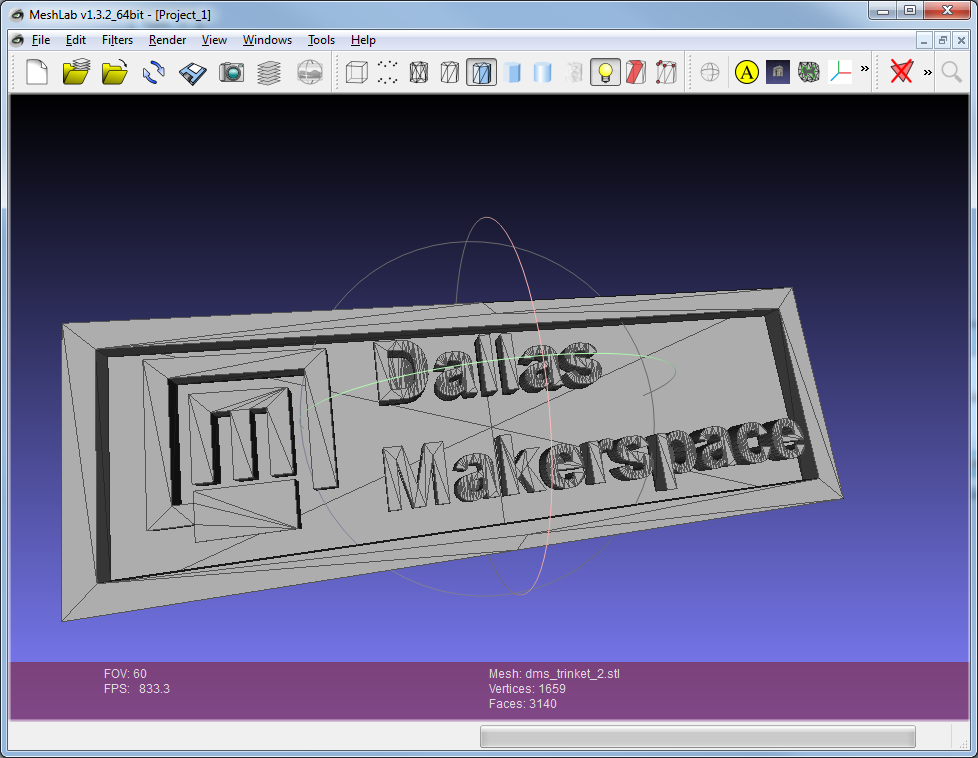

If I actually open up the file with MeshLab for instance, it’s clear it’s a valid 3D STL file:
