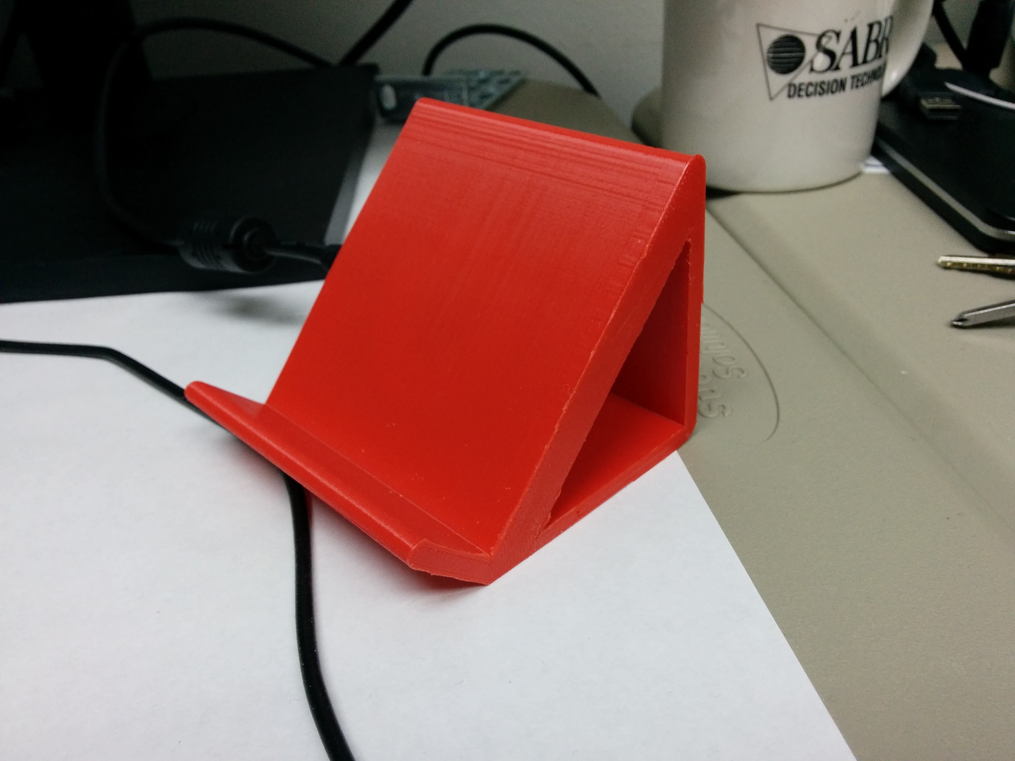

Well, I have been printing quite a bit of PLA on my printrbot lately and thought I would share.

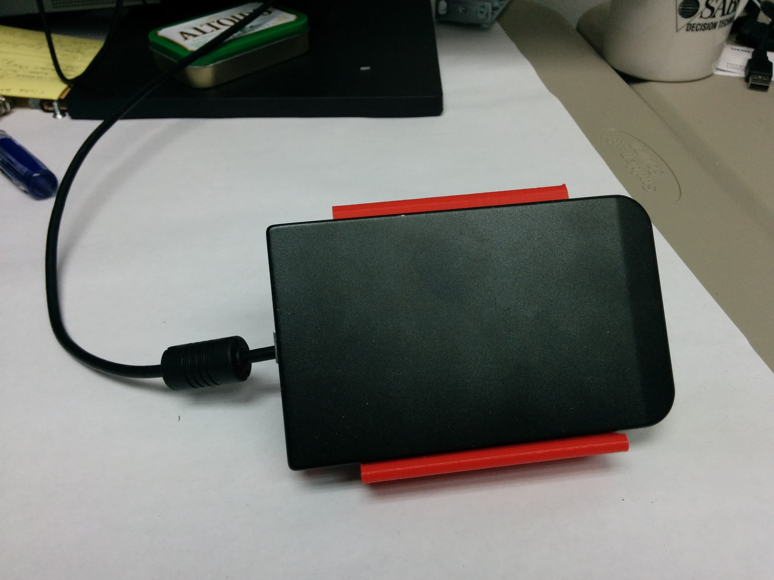

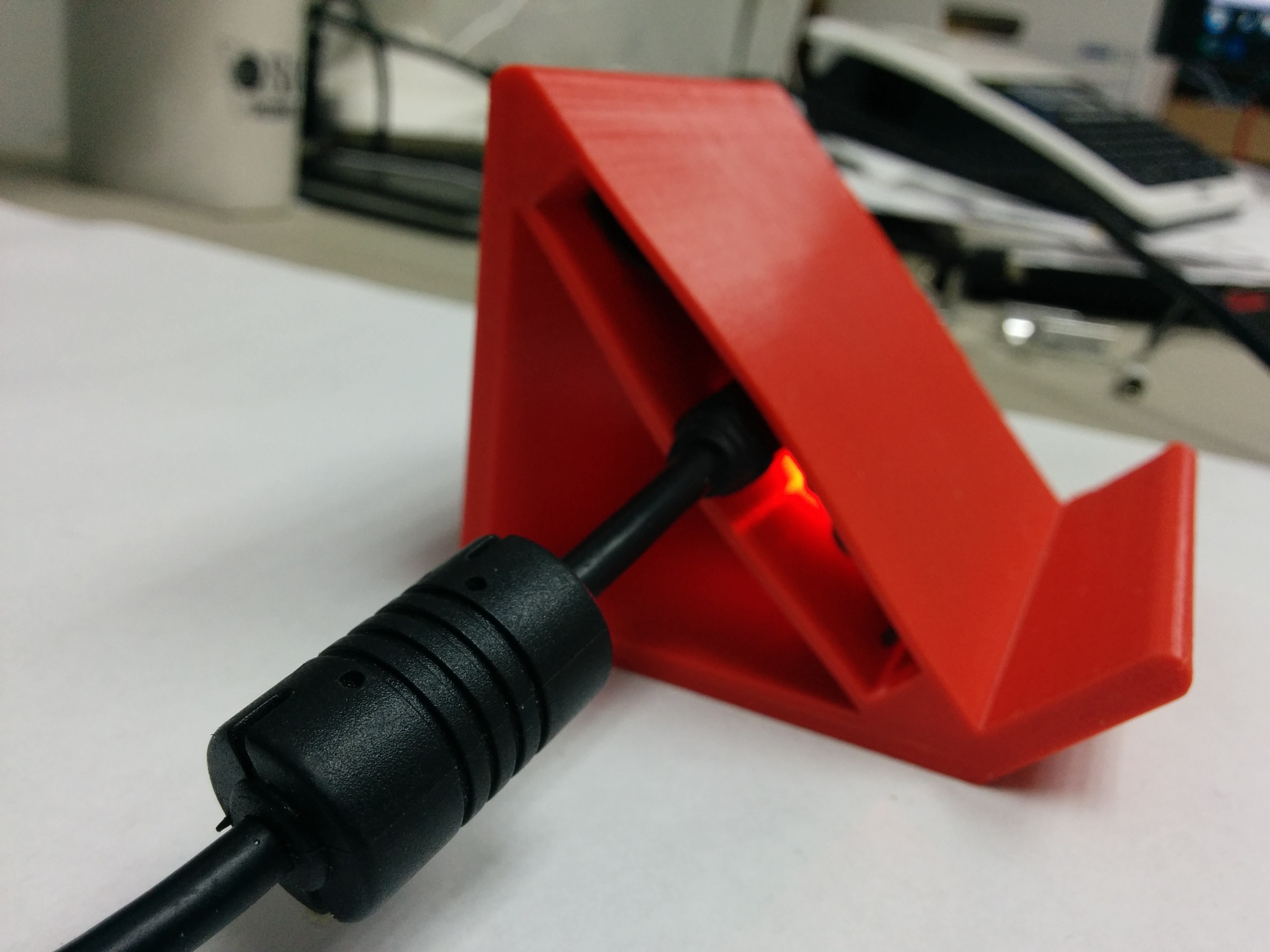

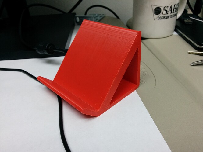

Here is a picture of a cell phone stand I designed and printed. Pretty basic, but the neat thing is that it charges my cell phone via induction. I purchased a Qi power charger base from China and then removed the electronics out of it. Then I designed this holder with a little pocket on the side so that I could slide the electronics into it and create my own custom charging stand.

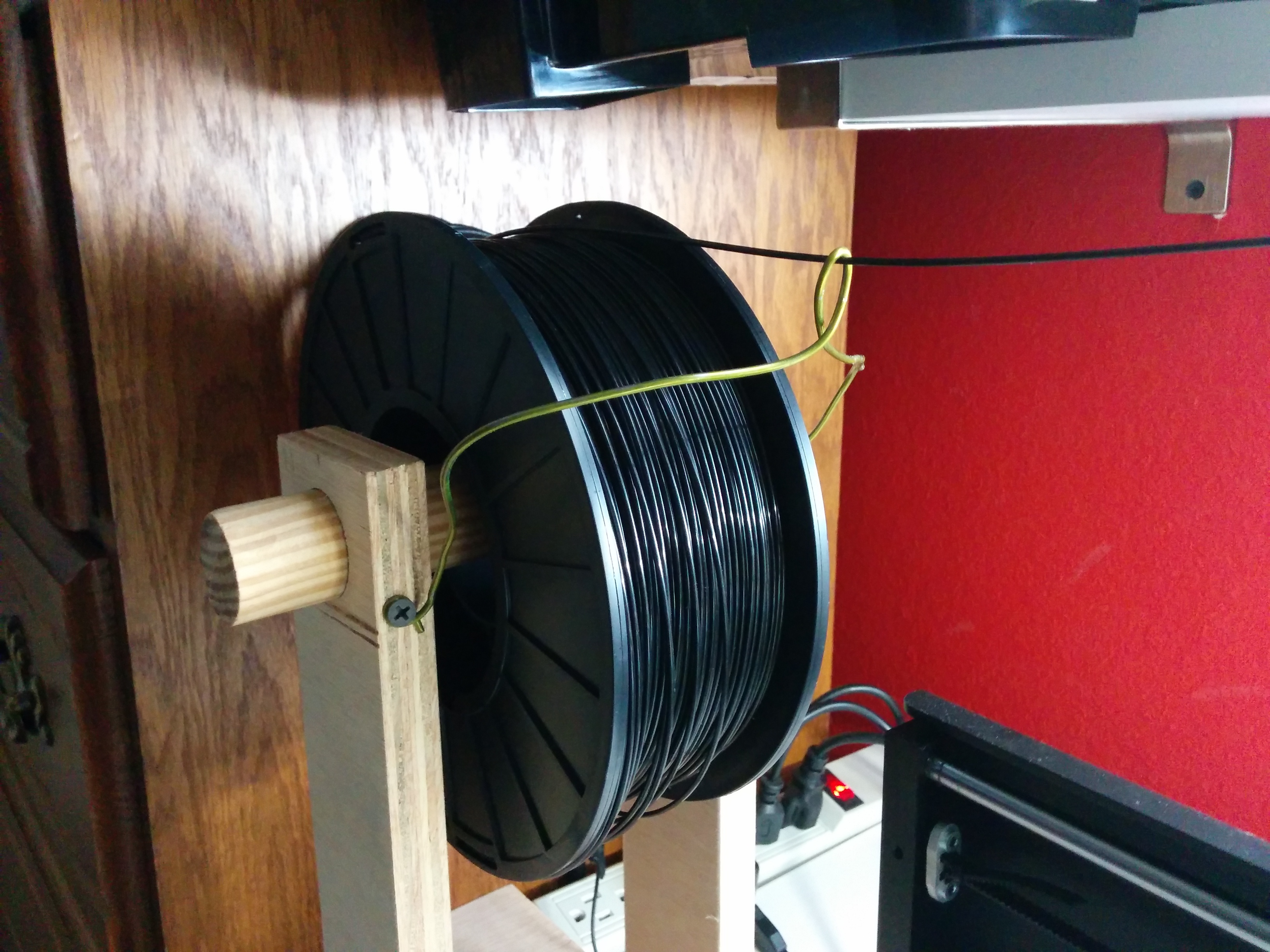

Here is a picture of my high-tech filament guide…It keeps the filament from coming loose off the spool and wrapping around the dowel on the filament holder.

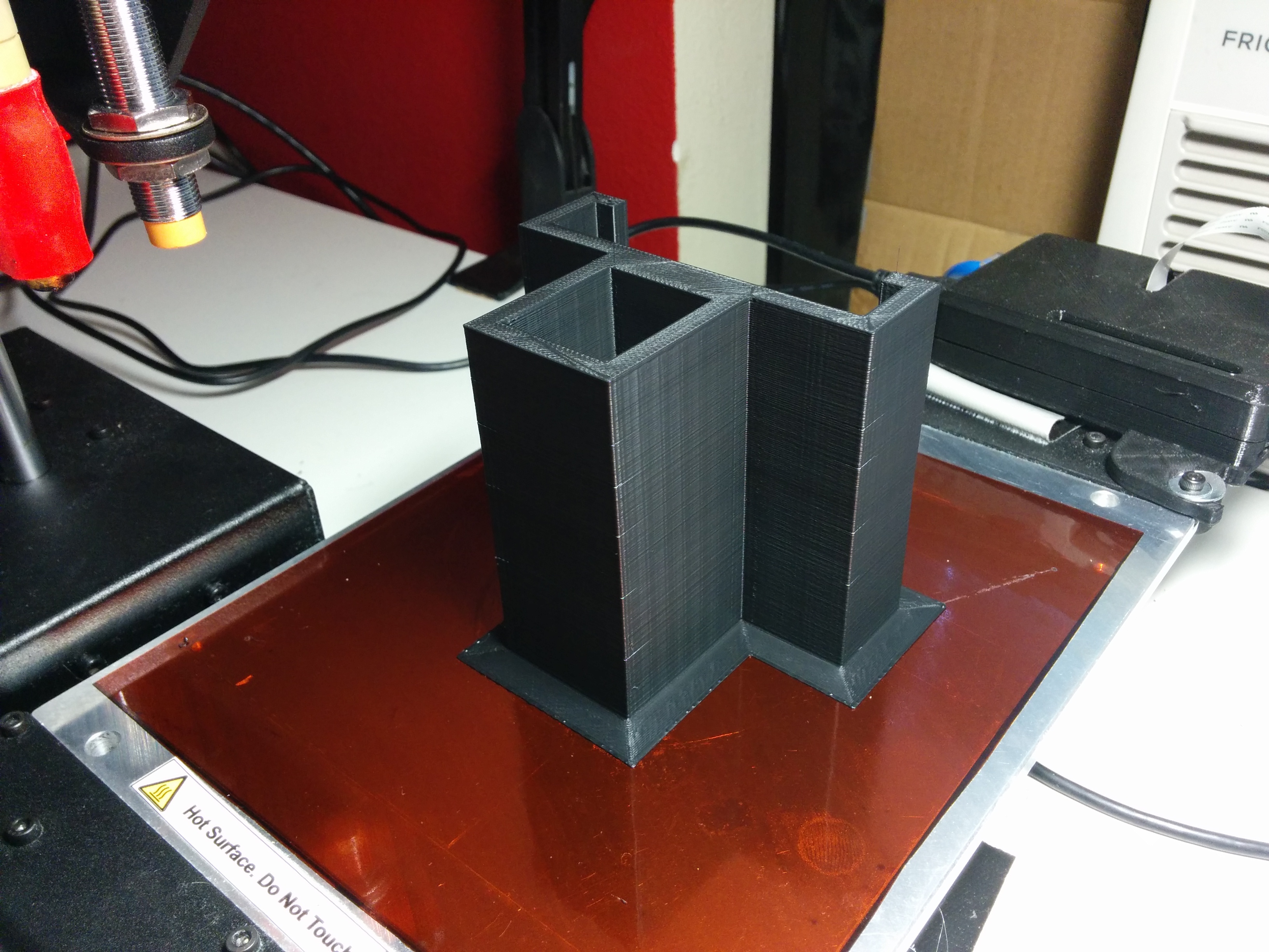

Here is a picture of one of my boxy ABS car phone holders. I have an aftermarket radio in my Camry and there is a small, almost useless pocket under the radio. The square section you see closest to the camera wedges into that pocket and the C part on the far side allows me to slide my phone in from the side. It holds the phone pretty securely.

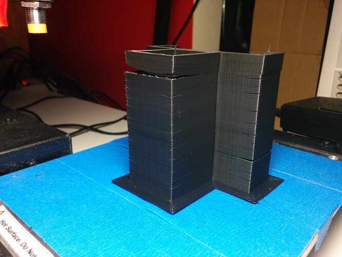

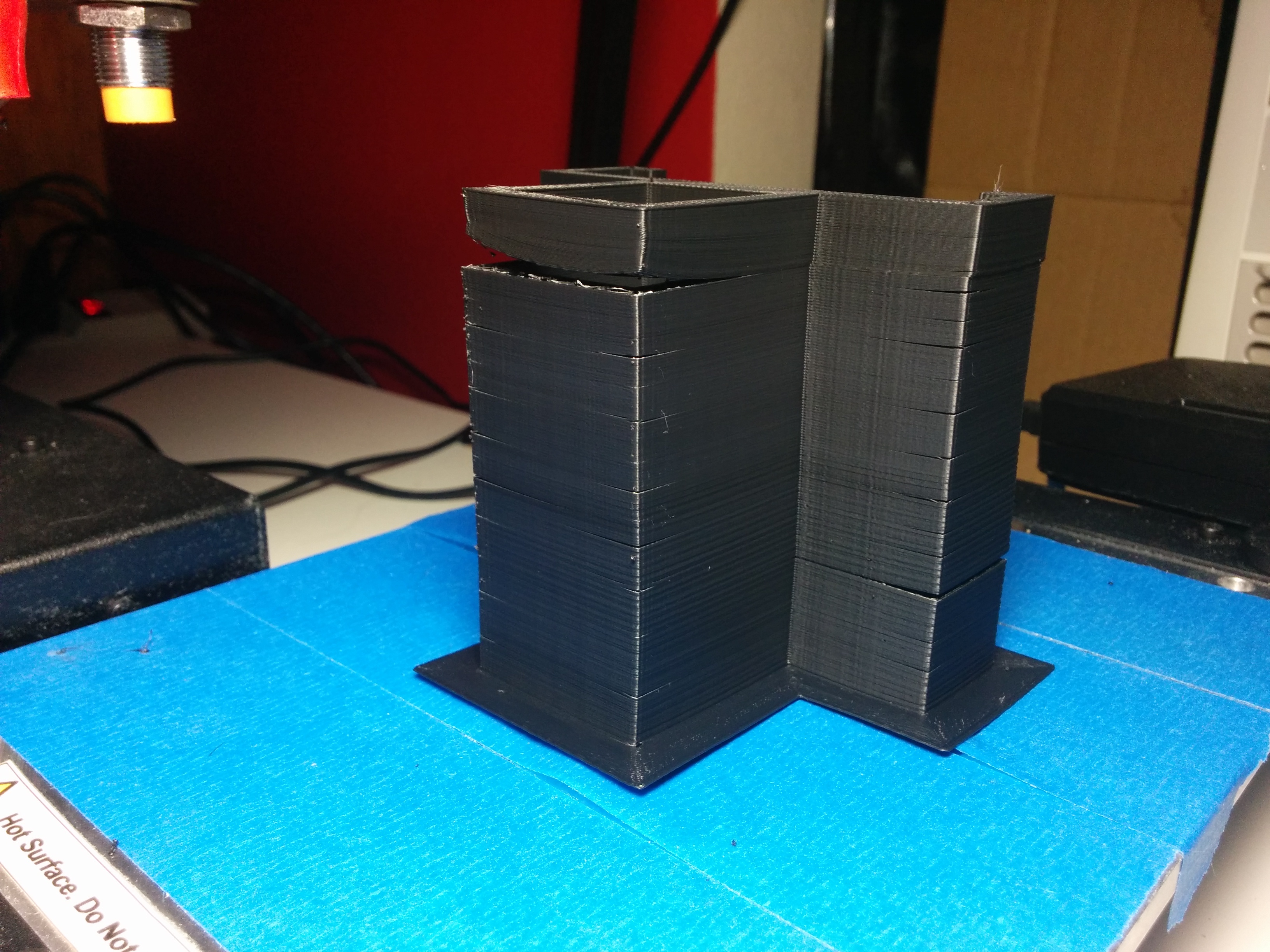

You can see some of the layer issues in the print, the white lines about every couple of centimeters. It might be caused by the air conditioner kicking on at certain intervals, but it isn’t blowing down directly on my printer, so I am not sure what is causing that just yet. The max I could get my bed temp to was 105C, but ABS still wouldn’t stick. Using Aquanet in the purple can works great though and I can run the bed at 90C saving energy and ambient heat. I don’t have to apply the hairspray before every print. So far I am on my 5th or 6th print with the same original application of spray.
Here was one of my previous attempts with different speeds, flow rates, and HE temps. Terrible…and the ABS curled off the bed and barely stuck.
