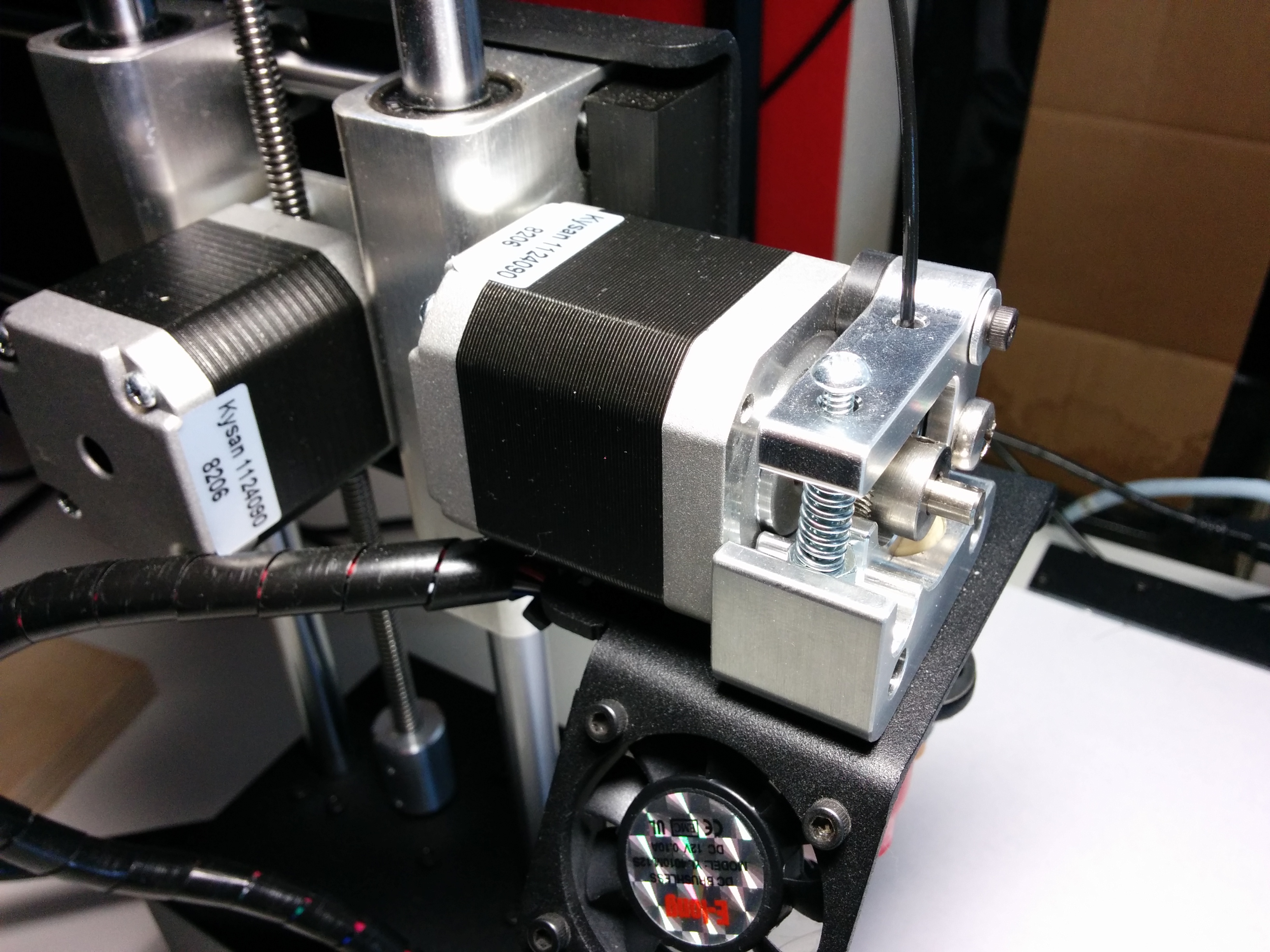

I am curious if the others with the printrbot extruder assembly (not just the metal simple) have notice a problem I have. I originally modified my printer to have a second fan that is directed to the metal extruder and the stepper, but found it wasn’t sufficient and have had to had a small house fan (about 8" diameter) and keep it angled above the heat bed, but still blowing air across the extruder stepper motor. The reason is that my metal extruder gets hot enough to significant soften the pla filiament before it enters the hot end. This cause jams and bad prints.

Bed temp is 70, and hot end is between 200-210 depending upon whose filament I am using. But it isn’t the hot end that is causing the problem for me, it is definitely the heat being generated by the extruder stepper motor. I am wondering if Printrbot hasn’t made another design change since the model I have. I know that at the time there were a number of people with similar problems, and there were a lot of Thingiverse designs released for fan mounting brackets to cool the aluminum extruder.
If the ambient temp in my place is in the low 70’s or below, this problem is greatly reduced. But I was seeing it a lot last summer, when temps were reasonably high. Certainly near or slightly above 80 in my house. I wonder if you will see the issue come up as summer approaches?

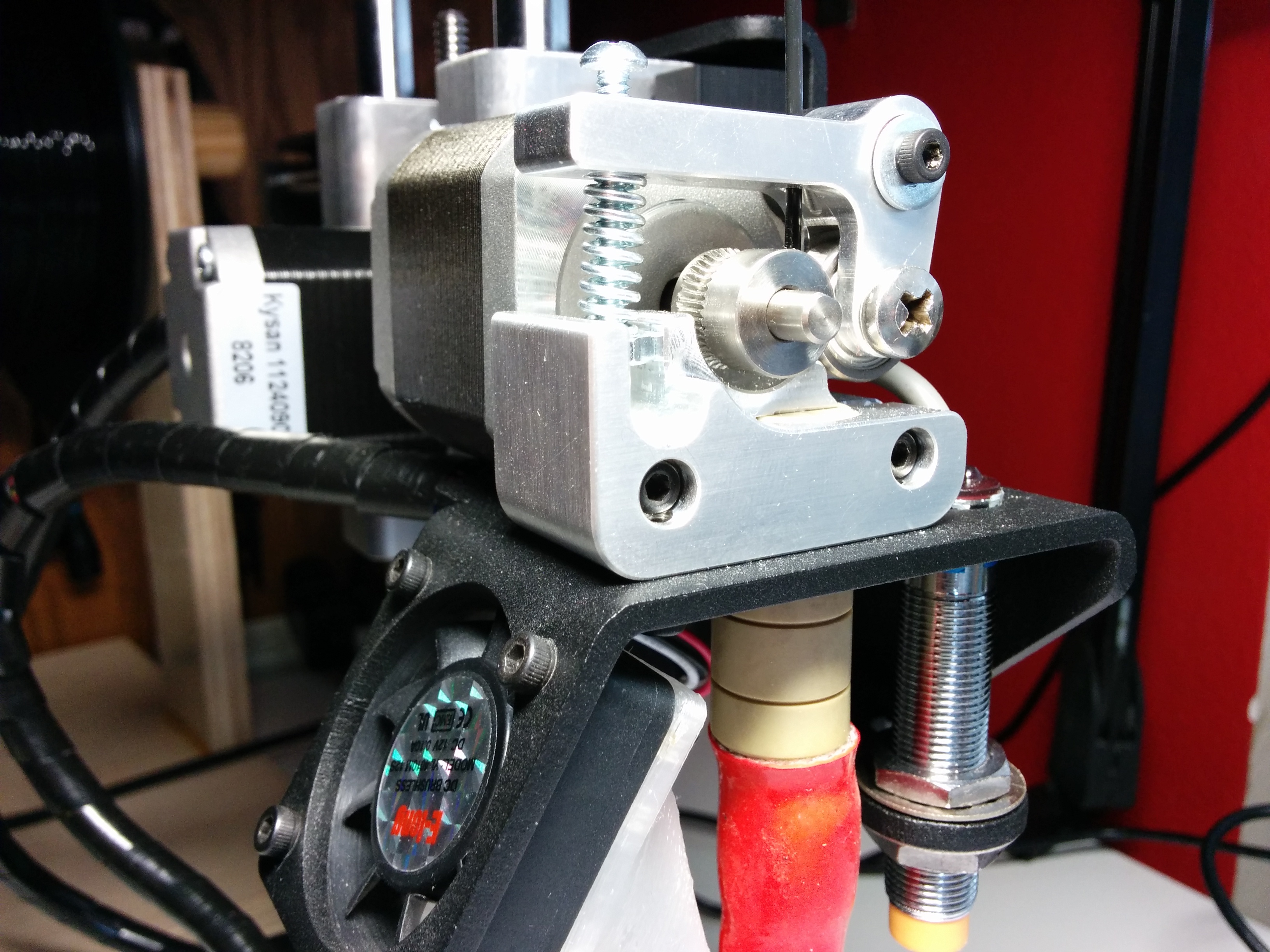

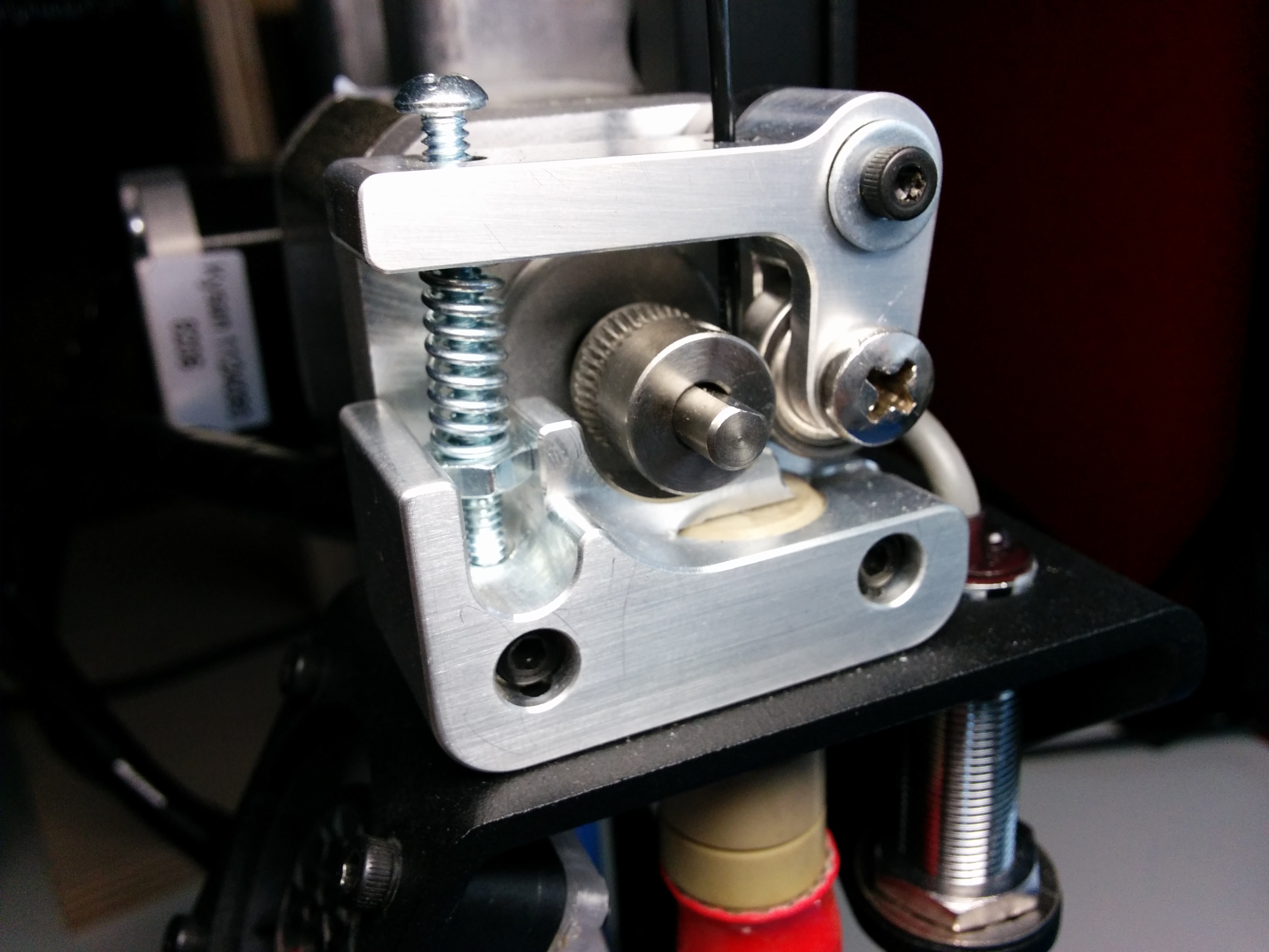

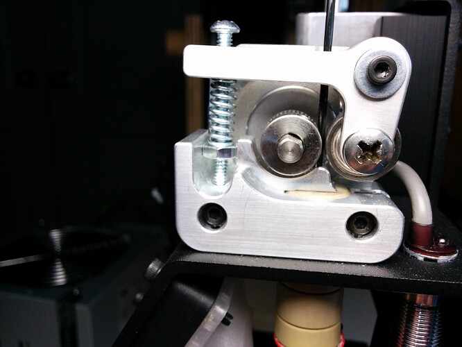

Here are a couple of pictures of my extruder motor and the extruder assembly if you want to compare it to yours.
Not sure if yours is the same design, but as you can see on mine, the top of the hot end sits flush with the extruder assembly and there is a piece underneath the motor shaft to keep the filament in check.
Maybe if yours isn’t the same design, you might contact them and see if they would ‘comp’ you one.
The motor id sticker says: Kysan11240908206

If they have made changes, I am thinking it may have been in the driver circuits on the main board, not nescessarily the motors. I do know they have recently released a new board, and don’t know if you have that versus the one I have.
Frankly, I suspect that is the big difference, since my stepper runs quite hot after a long print… It is uncomfortable to touch.
@paulstaf
Ah, mine never get that hot. I have the latest rev… Rev F. maybe? Not exactly sure. You might write them an email and see if they would work with you on replacing the board, or addressing the issue. Even in the hot garage mine didn’t get too hot while running.

It shouldn’t run hot. Have you tried turning down the current to the motor?
adjusting stepper motor potentiometers
