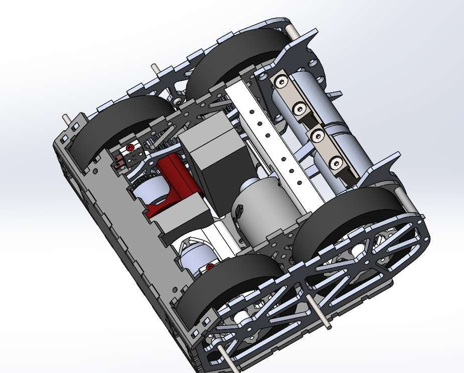

We learned quite a bit from V1 and set out to create V2. We started by changing the weapon, simplifying a number of parts and testing a bunch of different motors and ESCs.
First we built a new drivetrain:
Then we got to work making the new weapon:

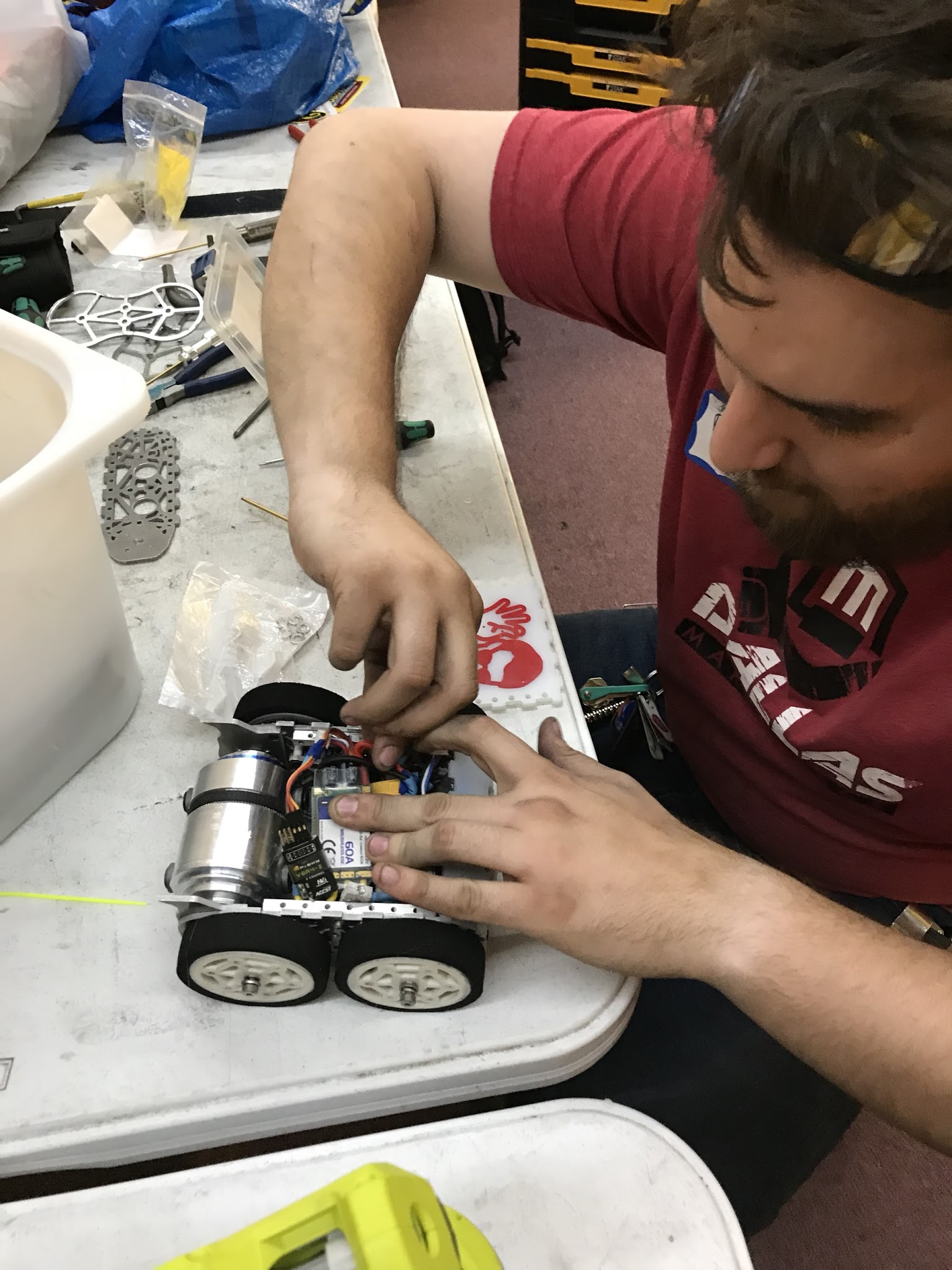

After the rebuild we thought we were close to being ready to fight:
But packing our electronics into the body proved to be rather tricky, but we managed.
Fully built our robot weighed in at 1247 grams well under the 1360 gram limit
