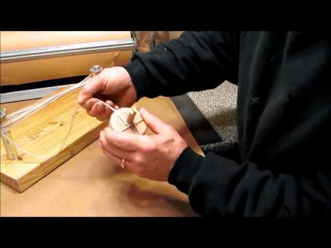

Yeah, I saw one at his booth in the Chems Building at PGI. I fiddled with it a bit, but wasn’t all that excited by it, might try making one to see how it would work in practice though. Ned just pulls his twine through a dixie cup full of glue and wraps it around 2 posts in a board.
I look at his setup and seems not messy. But, something tells me, I could still make a mess of it. :smile: You can also see his hands shaking with how much force he is pulling on the shell.
