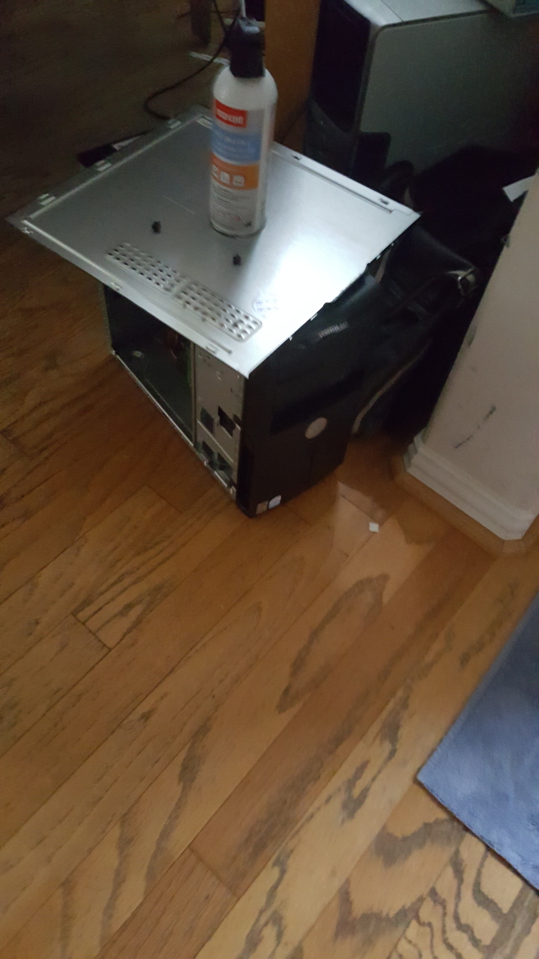

So parent’s computer broke and won’t turn on now its been dumped on me to fix it since apparently I go to Space and know how to fix computers according to their strange logic. I just went to check the outlet and wire if they’re receiving power and they are so I need to know what would be my next steps in troubleshooting? Any guides online or steps I should do next? Need to know if this is a hardware or software issue.
The only other thing done to it was a quick dust off with compressed air. Also what would be the best way to back up files from a hard drive to a chrome/dropbox/cloud based storage with just a laptop, just some files from dad’s is valuable to work/contacts. Can share details.
