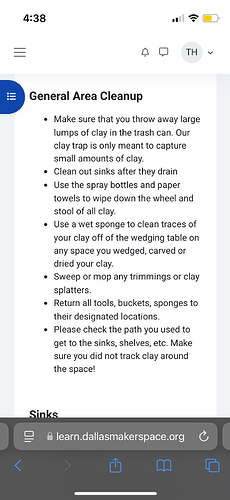

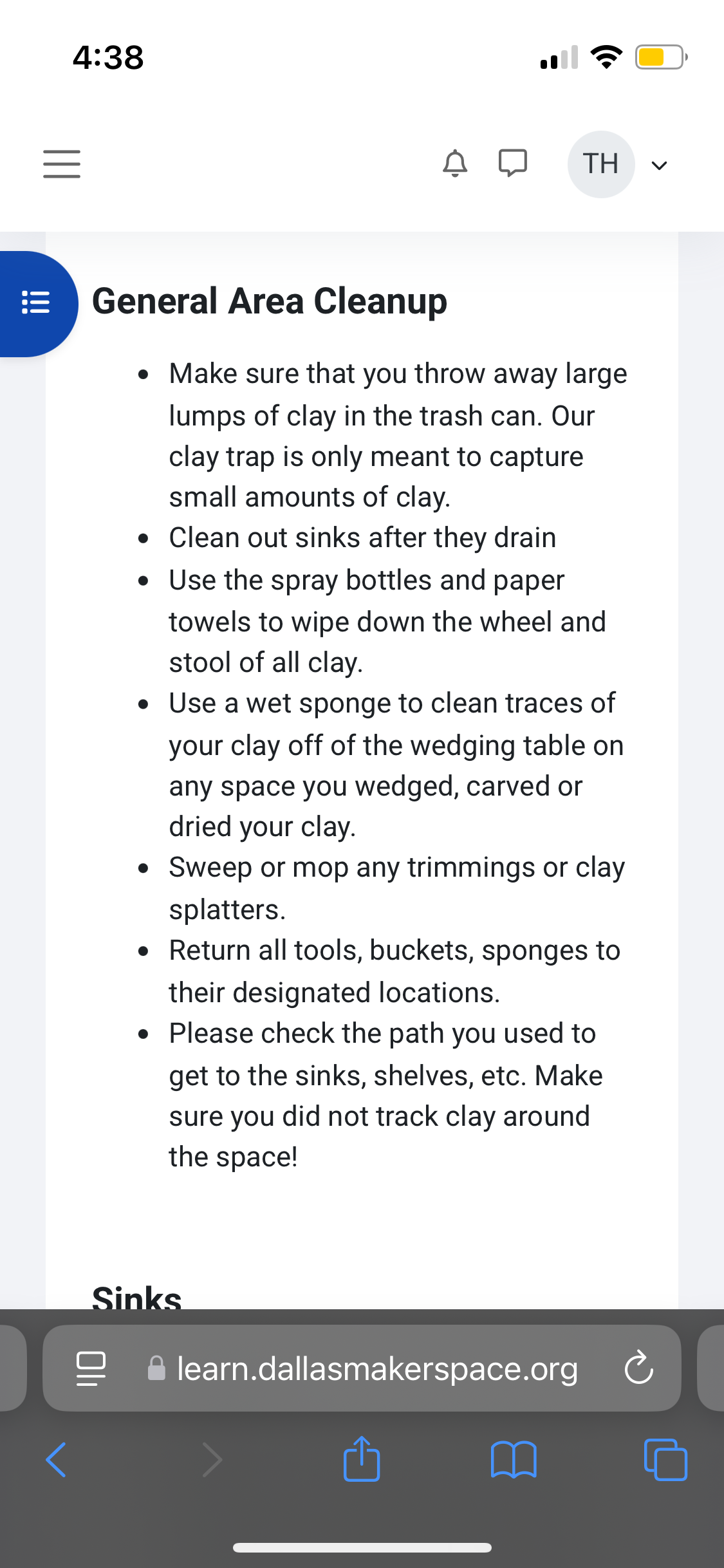

I am a new DMS member, and I’m currently reading through the online ceramics training course/orientation. In ~3 different sections regarding cleaning the studio, the training instructs members to sweep clay trimmings.
Dry clay, no matter the volume, should not be swept, dusted, sanded, etc. unless the person cleaning is wearing a mask or respirator. Repeated exposure to dry clay dust leads to silicosis. I advise removing the sweeping instruction from the training and noting the danger of inhaling dry clay particulates.

Unless you are trimming for hours, leaving your clay trimming to become bone dry on the floor, trampling it into a powder, and kicking it around, We expect member to sweep their clay trimming and throw it in the trash as soon as they finish.
That makes sense! My concern is less about what is being swept (trimmings) and more about including sweeping as a recommended way to clean a ceramics studio.
Although I have only experienced two ceramic studios before this, both studios emphasized the importance of always using water while cleaning to neutralize dust. For the safety of members, I do strongly believe that the training should mention why masks/respirators should be used when working with dry clay particles so members understand the risk.
It isn’t likely for any member to get silicosis from their time working with ceramics at DMS, but teensy glass particles aren’t healthy for the lungs at any quantity. Teaching potters to avoid clay dust in the orientation can lead to a healthier environment for all ceramicists :smiley:

I think we can cover this by just clarifying that only the wet trimmings are subject to sweeping.
Any other cleaning of an area, generally, should be just a water bucket and mop/sponge.

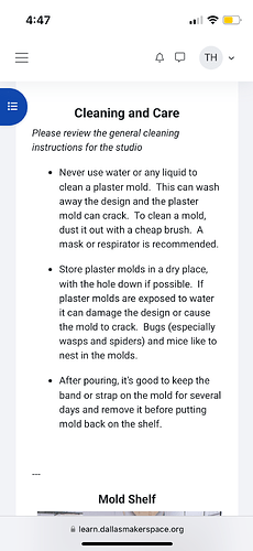

It is honestly comforting to know that ceramics dust is less of a medical concern than I believed! I think the main factor that gives me the heebie jeebies is that silica cannot be removed from your body- it just accumulates in there. Nonetheless, I do think it is a good idea to introduce beginners to the idea that ceramic dust can be dangerous so they know why they should wear masks if they ever happen to be in a dusty situation, even if it is only one sentence in the online or in-person orientation.

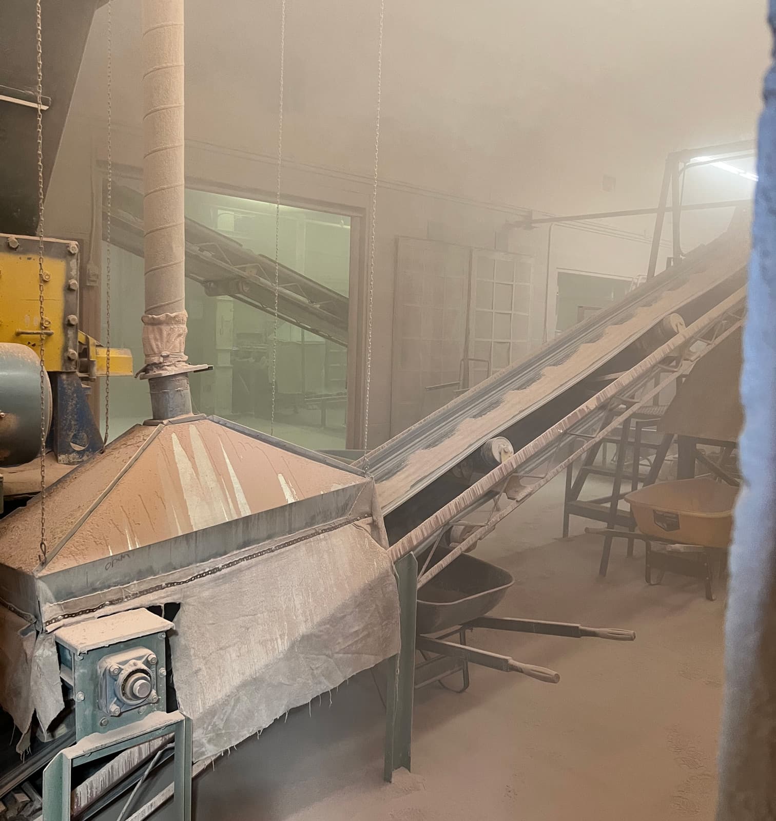

Glassworks has similar silicosis concerns but kiln dust is probably the worst thing we deal with. That and like Christy said above, glass/glaze has all sorts of heavy metals in it that are used as colorants.
The industrial concerns come from historical situations like the one I posted above. It’s considered one of the worst industrial accidents in American history.
