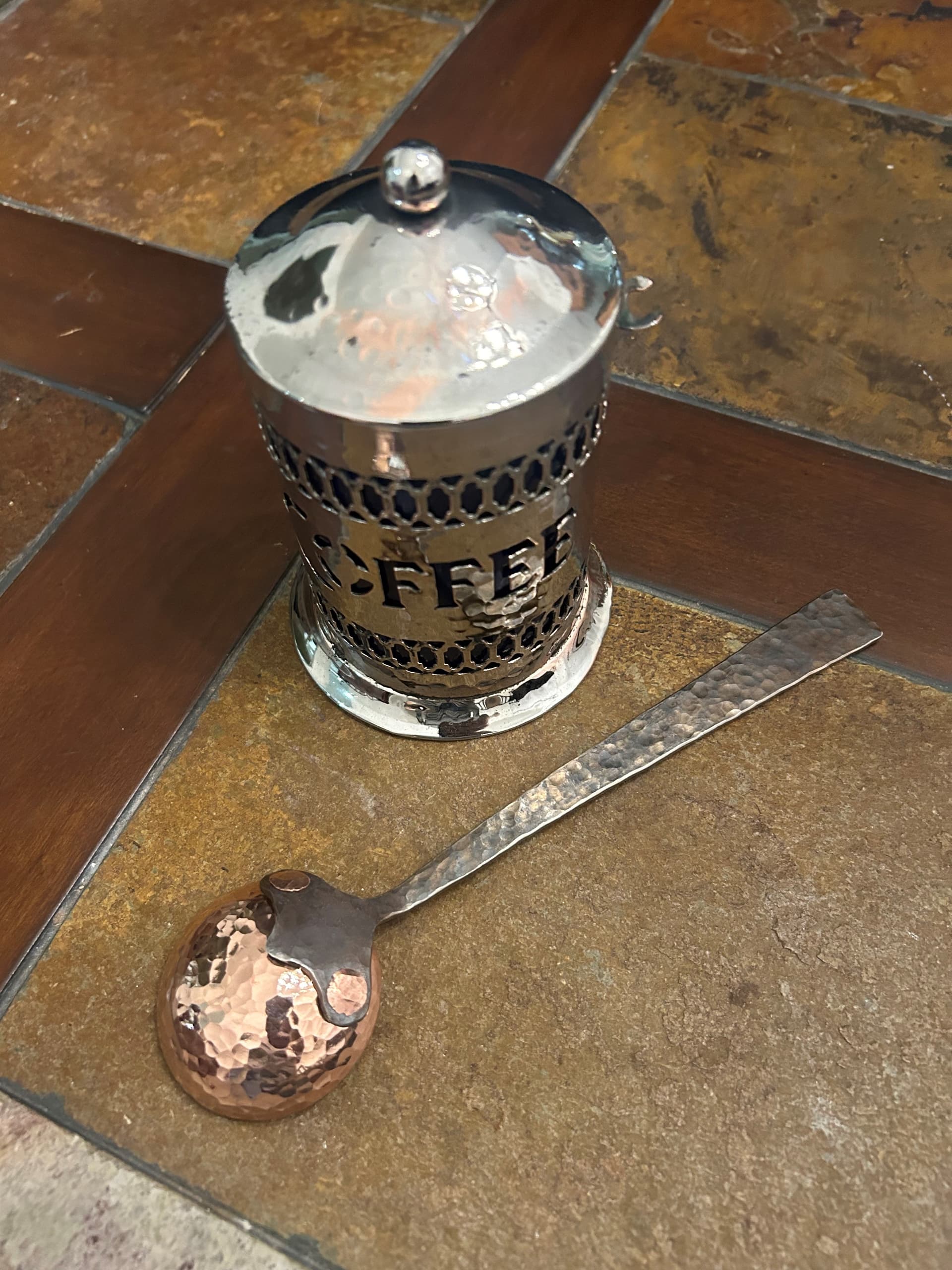

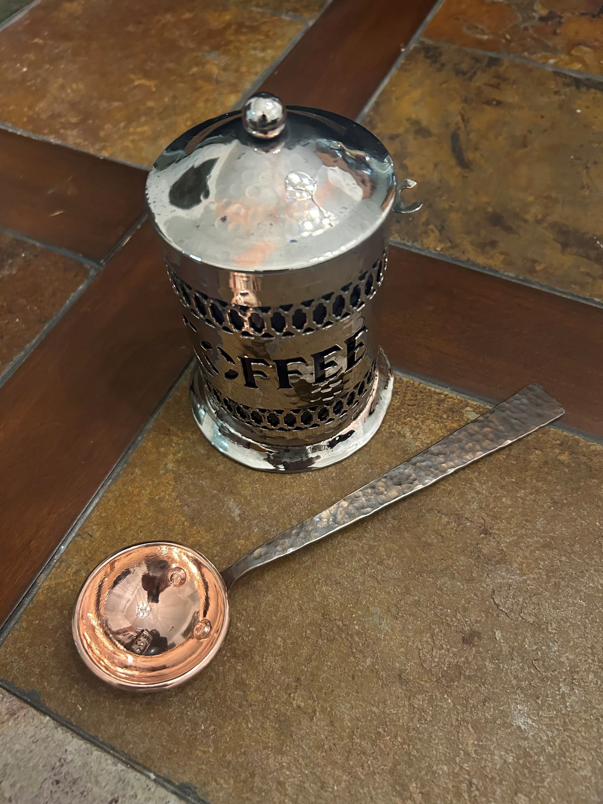

Hi I am Jeff. Made this copper and stainless steel coffee scoop doing work both at the space and at home, but all can be done at the space. Used the press, induction forge, belt sander, hammers, and anvils in the blacksmith shop. Used my buffer and jewelers tools at home to get the polished finish, but that could be done in the jewelry lab at the space. Was a kit I got online from Housemade. Mostly I make knives, some jewelry, and beginning to learn metal fabrication. I made this just because I like making things, and it was both satisfying and fun to do.

This is gorgeous!
Just a note. Jewelry has no problem with folks polishing copper or brass on our equipment, if you have been trained on it. However, STEEL IS A NO NO. Steel causes problems in many aspects of jewelry making, so we don’t want our tools used for steel, not even polishing. Thanks.
Thank you!
Yes definitely. Only the copper is polished on this project. The steel handle is just a heat patina from the induction forge and hammer texturing.

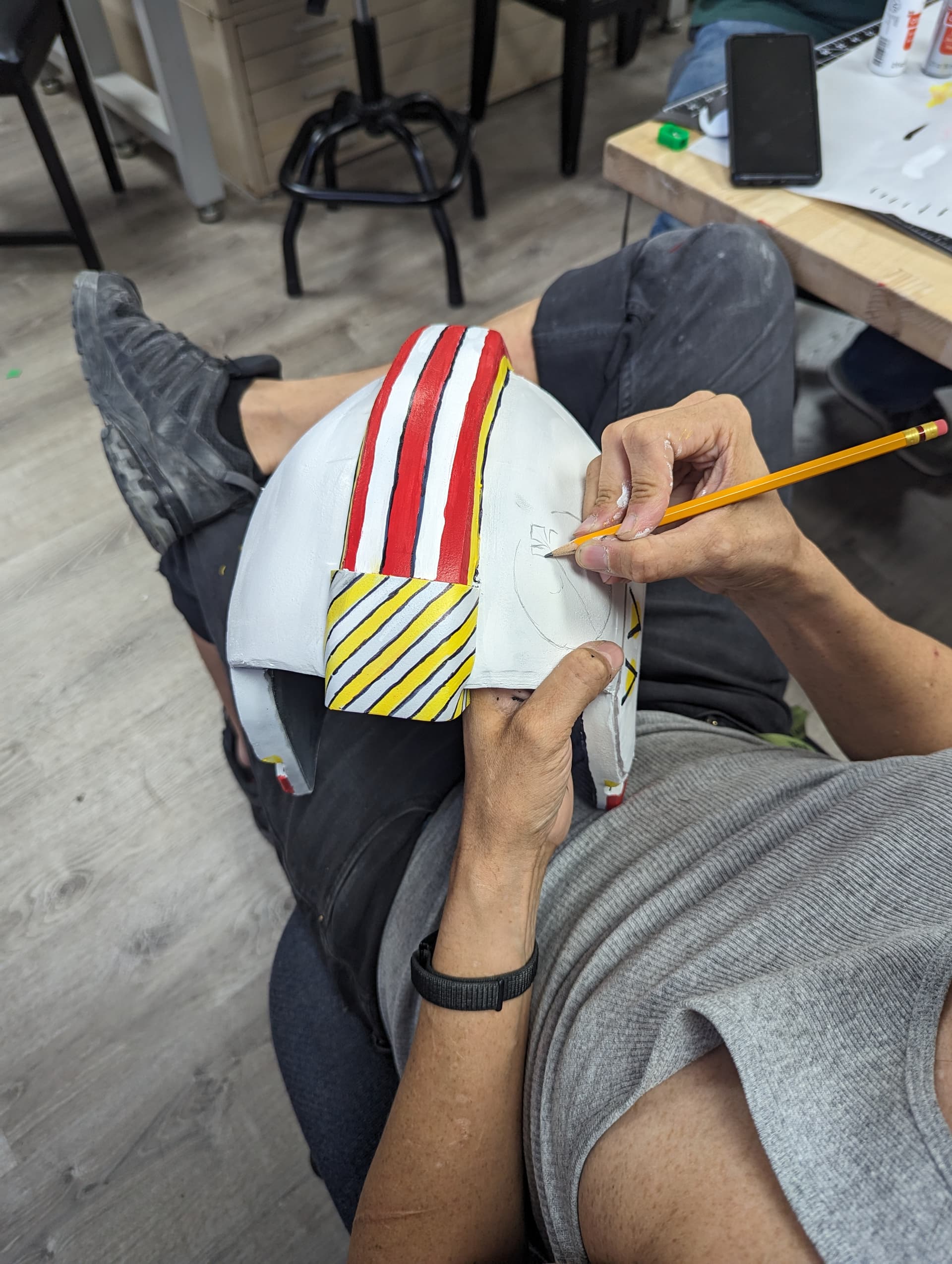

Did a group build today for star wars day. We made an X-wing pilot uniform.
Still ironing out a few details but the finished uniform will go in the lobby to show off.

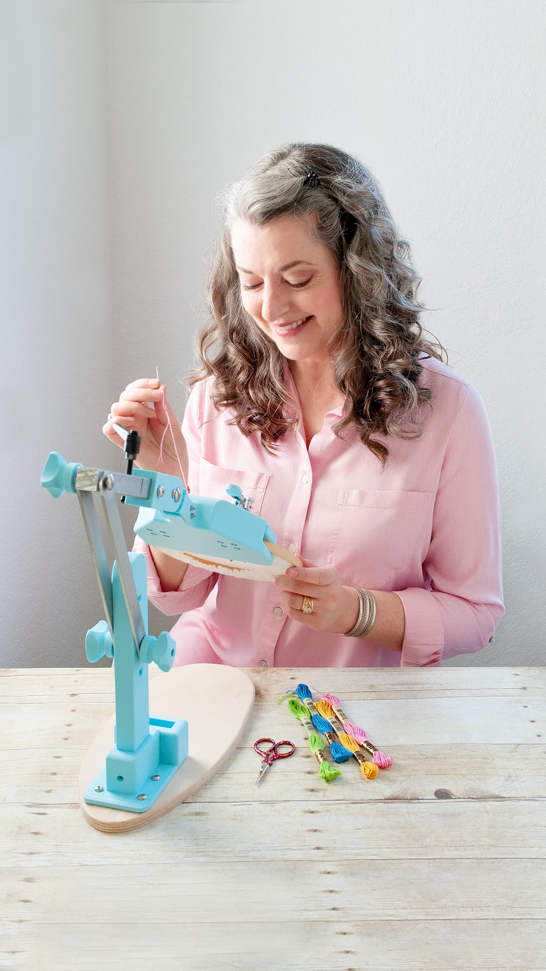

So this was partially prototyped and built at DMS. Completely Designed and modeled in Solidworks. All the metal and wood parts were cnc machined at DMS. All of the plastic parts are printed on our home Bambu x1c. It is an articulated embroidery hoop work holding stand designed for my wife’s hand embroidery company (lolli and grace) to sell. This is our original design and it has a lot of mechanical improvements over anything on the market . We could could not have prototyped it without DMS tools . We go to production this summer .

Awesome work. I love it when DMS sponsored/assisted creations eventually go to market. What an achievement. Congratulations.

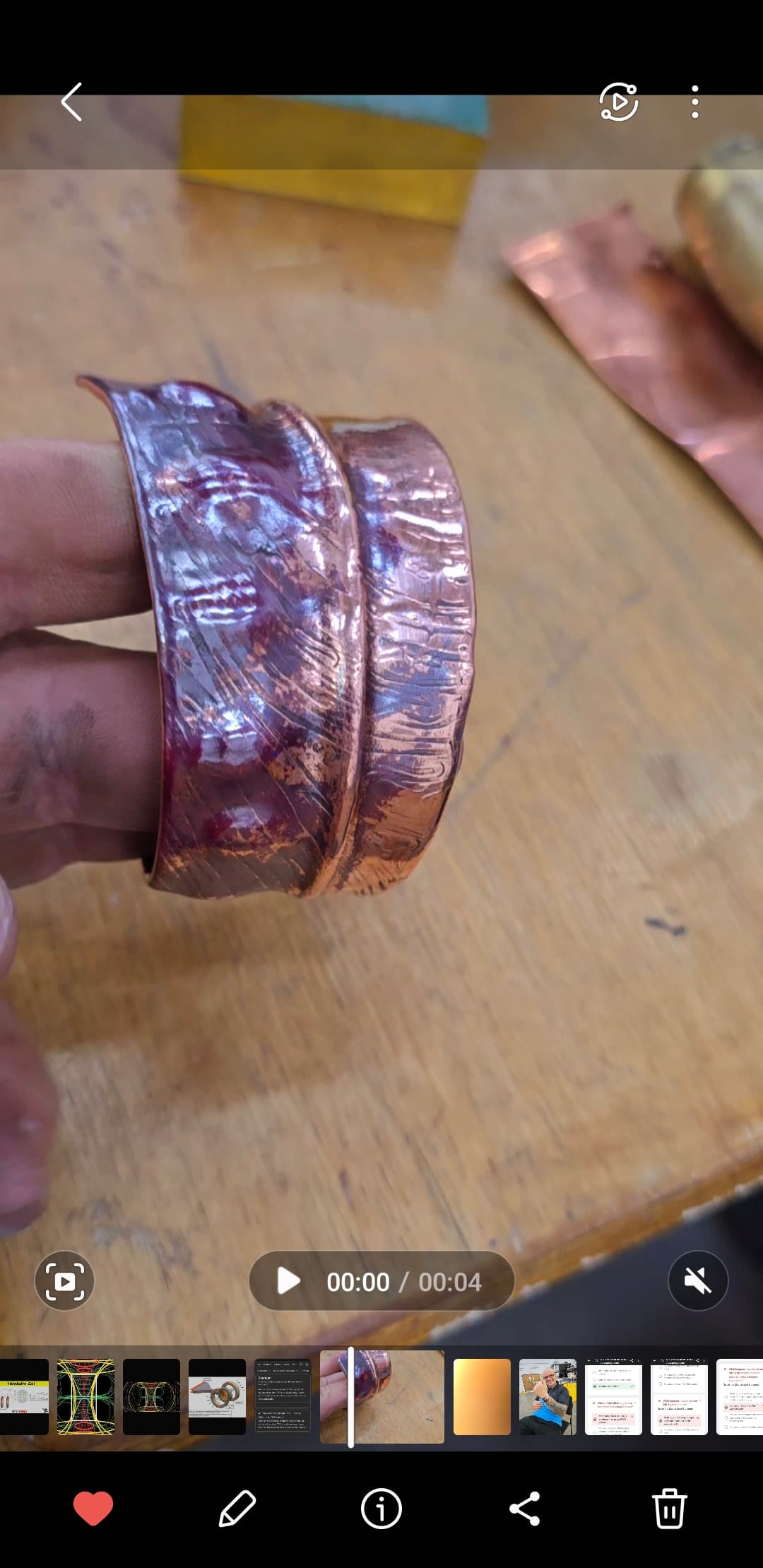

Had fun last night making this copper cuff for a friend.

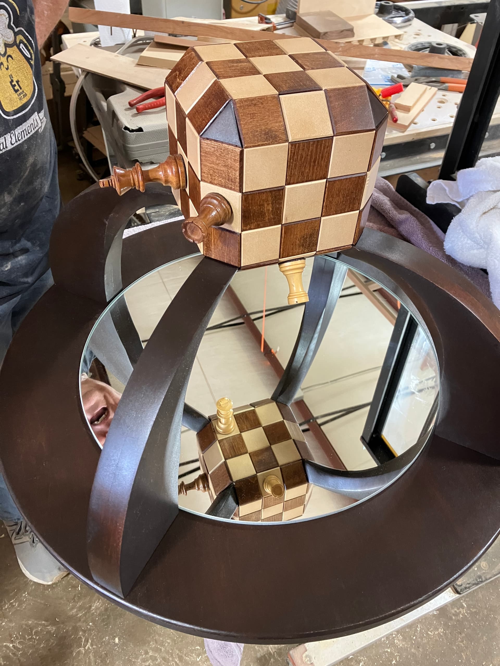

I was invited to help build a custom chess board. Playing area was to be a cube with magnets to hold playing pieces in place. Customer wanted the squares stained close to the color of his set. Inner cube built with 3/4 Baltic Birch plywood. Squares made of Soft Maple. Legs and base from Hard Maple.
My first test was to confirm joining angles and relief cut on top pieces. Thanks to @John_Marlow for mini table saw pointers.
Cube has 90 playable squares, all with 2 stacked ceramic magnets. Drilled recess in each square, but needed more space drilled into cube. Glued the stained squares a cube built and drilled by Bert Rabbe. Top corners are filled with triangles, and legs inset into bottom corners.
Shaped first four legs, and width and height needed to be increased.
New legs increase width by 4+ inches, and clearance by 1 inch.
Completed project in shop.
Game installed on custom table at customers home. The card says:
NINETY (TradeMark)
Patent Pending
© Benchmark Harris
All Rights Reserved
Rhombicuboctahedroidal Chess. Soft maple playing surface, with
hidden magnets under 90 playing squares and mirrored hard maple
support crafted by Howard Forsberg and Bert Rabbe in 2024.
