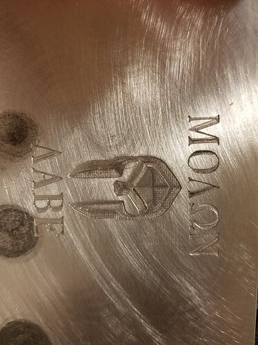

I thought I would post regarding one of the test engravings on 7075-T6 AL (ignore the black dots at the bottom and sanding marks - it was a piece of scrap) that I made after attending Jay’s Shapeoko class 11/12 - thanks Jay, great class.
I used Easel, which is the software provided by Shapeoko. It has limitations, but it is very easy to learn, so for something simple it works well.
I used a Harvey Tool Engraving Cutter # 993215-C8 ($19)
In “Bit Size”, I chose “Other Bit” and inserted .005 in. as the bit size
In “Cut Settings” I inserted 20 in/min feed rate (as a conservative rate based on chip load info from Harvey and assuming at least 10,000 rpm shaft speed of the Shapeoko), 6 in/min plunge rate, and .003 in depth per pass.
My total cut depth was .006 in.
It took about 45 minutes for it to engrave the attached. It is 1-3/16 x 1-9/16 in. in size.
