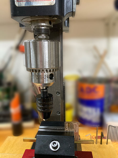

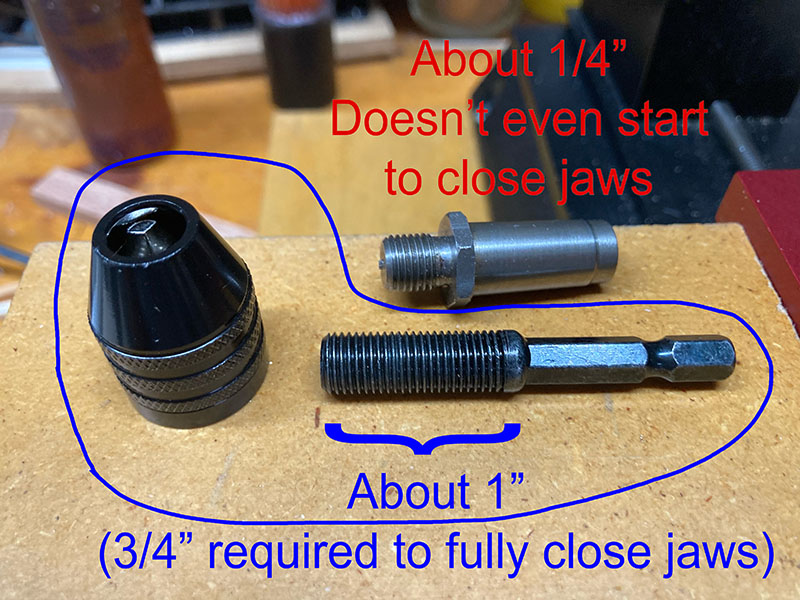

I bought this, and while it holds tiny drills, I can’t figure out how to use it.
The drill chuck has a removable hex shaft on it. The threads on the shaft open and close the jaws. About 3/4" of thread length is required to fully close the jaws. However, my morse taper arbor that attaches to my drawbar only has about 1/4" of thread so it doesn’t even begin to engage the jaws. If I put it into my drill chuck, I don’t have enough Z-height to use it.
Thoughts please?
Parts are inter-changable between all of Sherline’s products. Buy a taller z axis and lead screw. That will give you 3 more inches of clearance at least. That’s what I did on my mill at home.
OK, got it. Thanks.
As an interim hack, you could make a couple different length spacers, slightly smaller than the root diameter of the thread to insert between the chuck and taper, to cause the jaws to engage.
