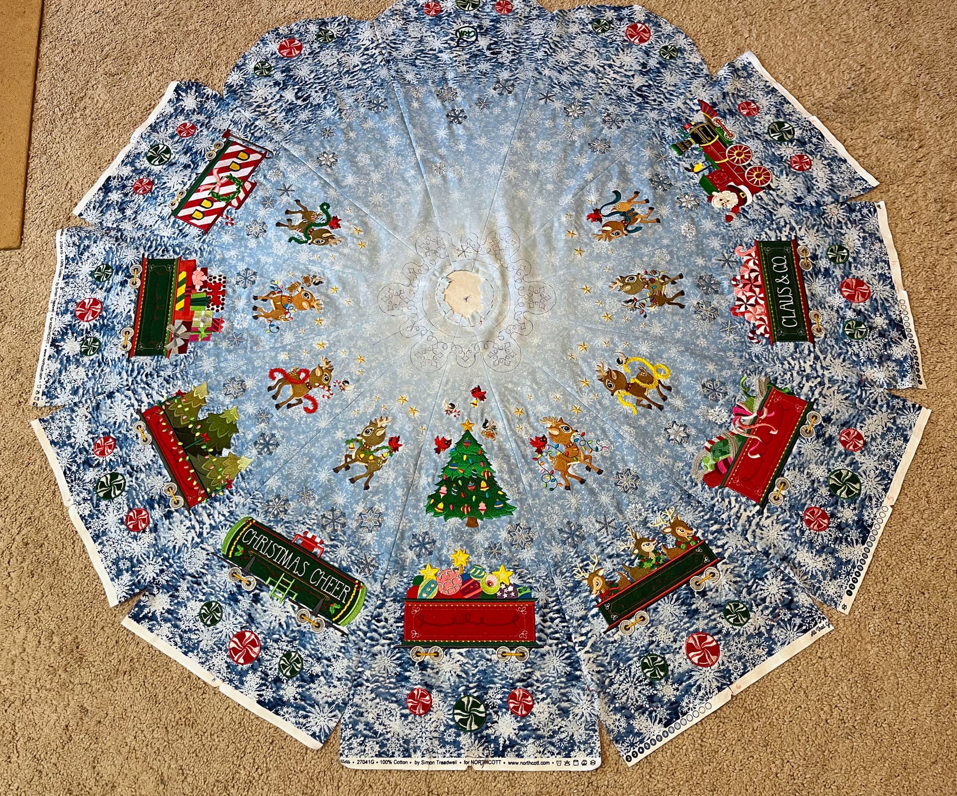

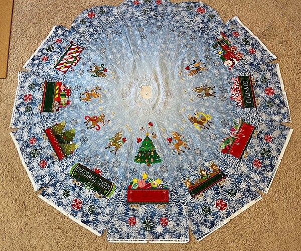

I’m making a Christmas tree skirt and stuck on the quilt stitching design. I plan to stitch a snowflake “collar” around the opening (marked in purple pen) and a feather border around the still-to-be-cut scallops. I plan to outline the major embroidery elements, and I have added extra batting shapes beneath those so they are a little puffier. I’m stuck on the rest. With the embroidered snowflakes between the train cars and the reindeer/tree there isn’t a lot of negative space to quilt.
The quilting objective is to make the embroidery elements stand out (dimensionally), so I’m considering an all-over-stipple. Or should I forego the stipple and just stitch the wedge perimeters? Or something else completely different?
Online examples were all created from embroidery design packages and not independently quilted so they don’t offer much inspiration.
I am competent enough to do a fairly complicated stitch-out if that’s the answer.

My primary objective isn’t durability, but creating a stitch pattern that suppresses the negative space and allows the major elements to (dimensionally) rise up.
I have been fiddling with it in Photoshop/Illustrator (since I have a full scale rendering) but lack suitable inspiration.
As you point out, this isn’t a project where the quilting is intended to be the focal point. I suppose I can stitch the items I know I’m going to do - major element outlines - and then see what else it needs, if anything.
What are your thoughts about stitching the lines between the wedges? I’m mixed on that. If I don’t do a stipple or other pattern then I need to define the wedges. If I stipple then it might be better to skip the wedge lines and stipple all over (through the lines). Your personal preference?

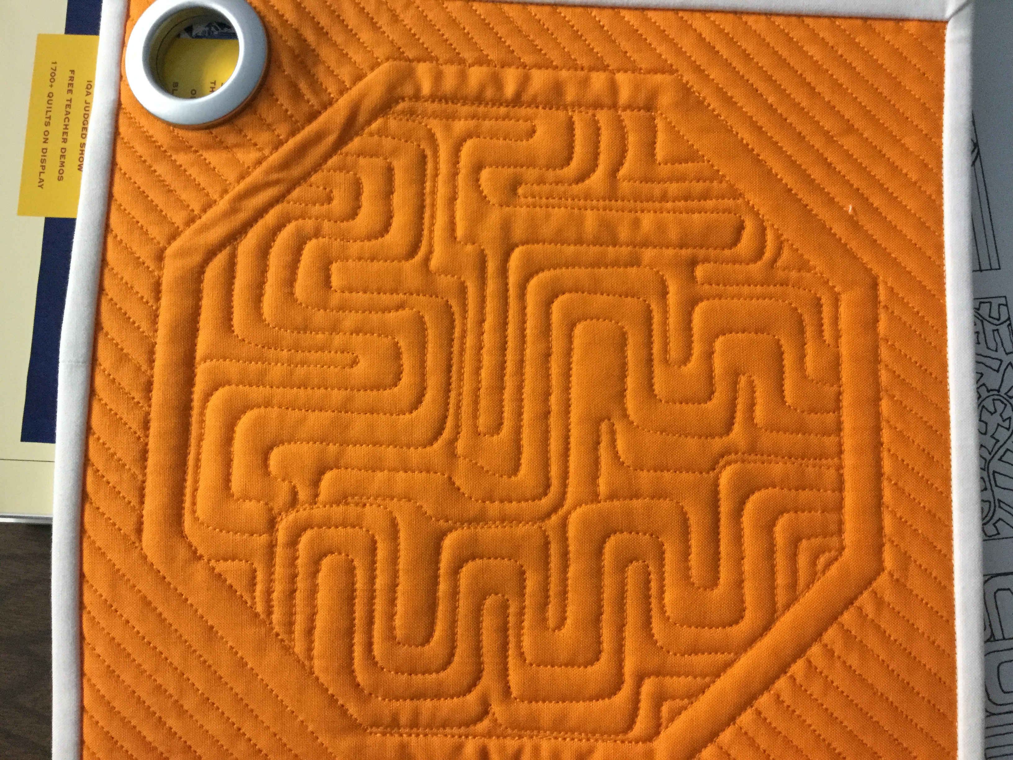

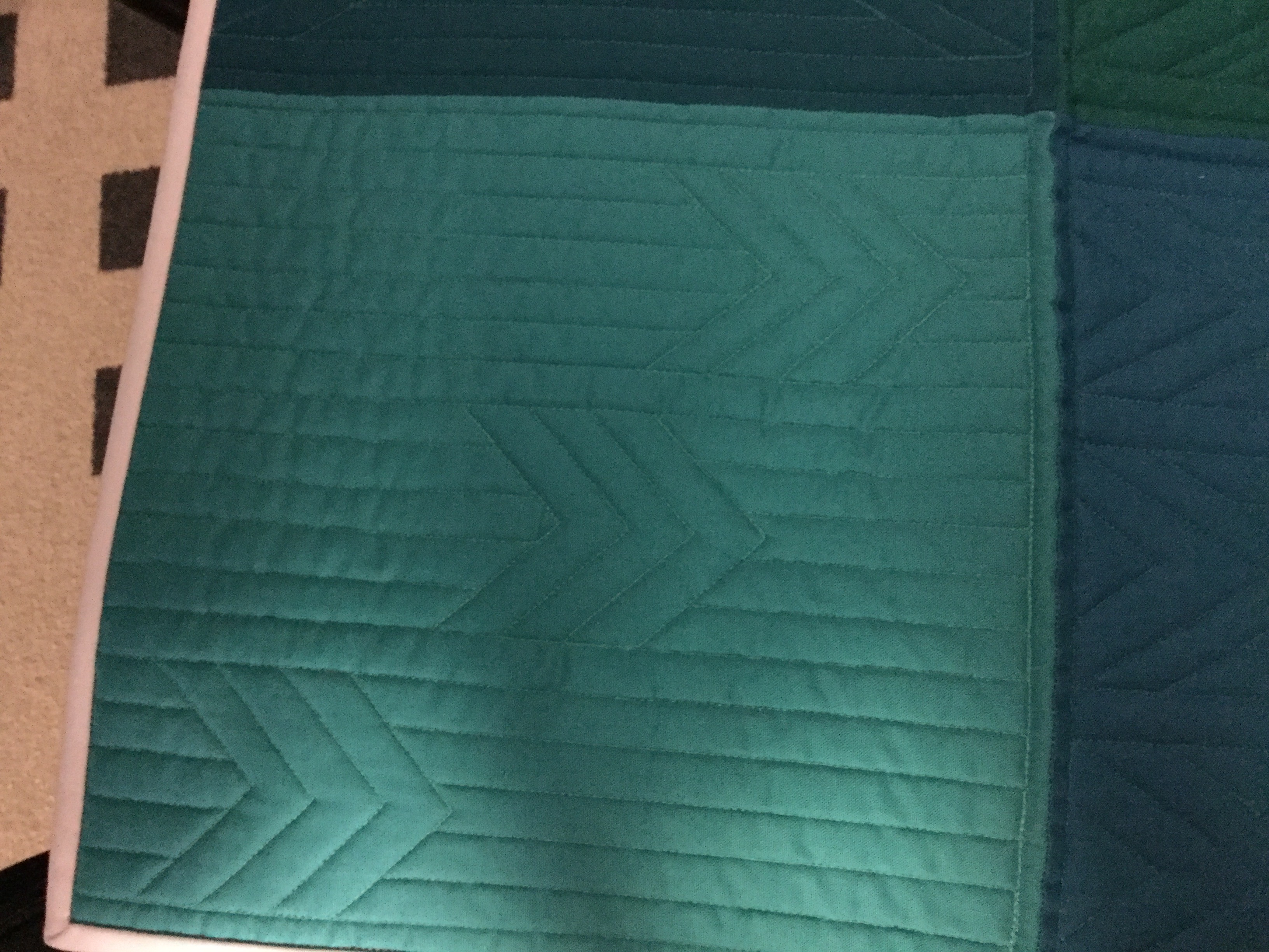

One key part of quilting is the spacing of quilting lines recommended/required by the batting used in the quilt. Some will require no more than 4 inches separation, those with scrim will allow up to 10 inches. So that consideration also comes into play. But I am thinking that if you outline the wedges, the stand out elements, and stitch the snowflakes at the central opening, you will fulfill the density requirements. I am going to attempt to send pictures from one of the classes (I was a student) from a previous quilt expo that might give you a few ideas on “fill” stitches.

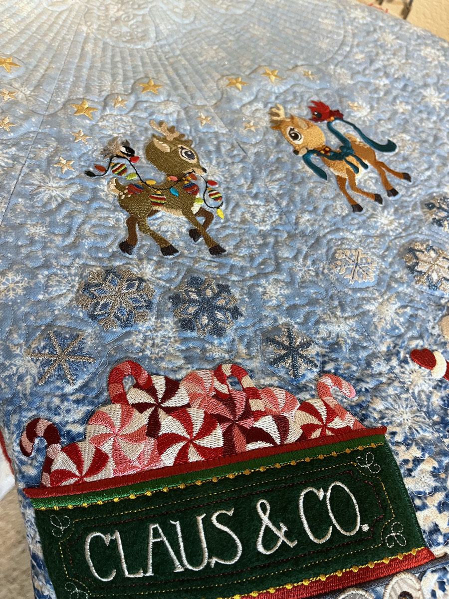

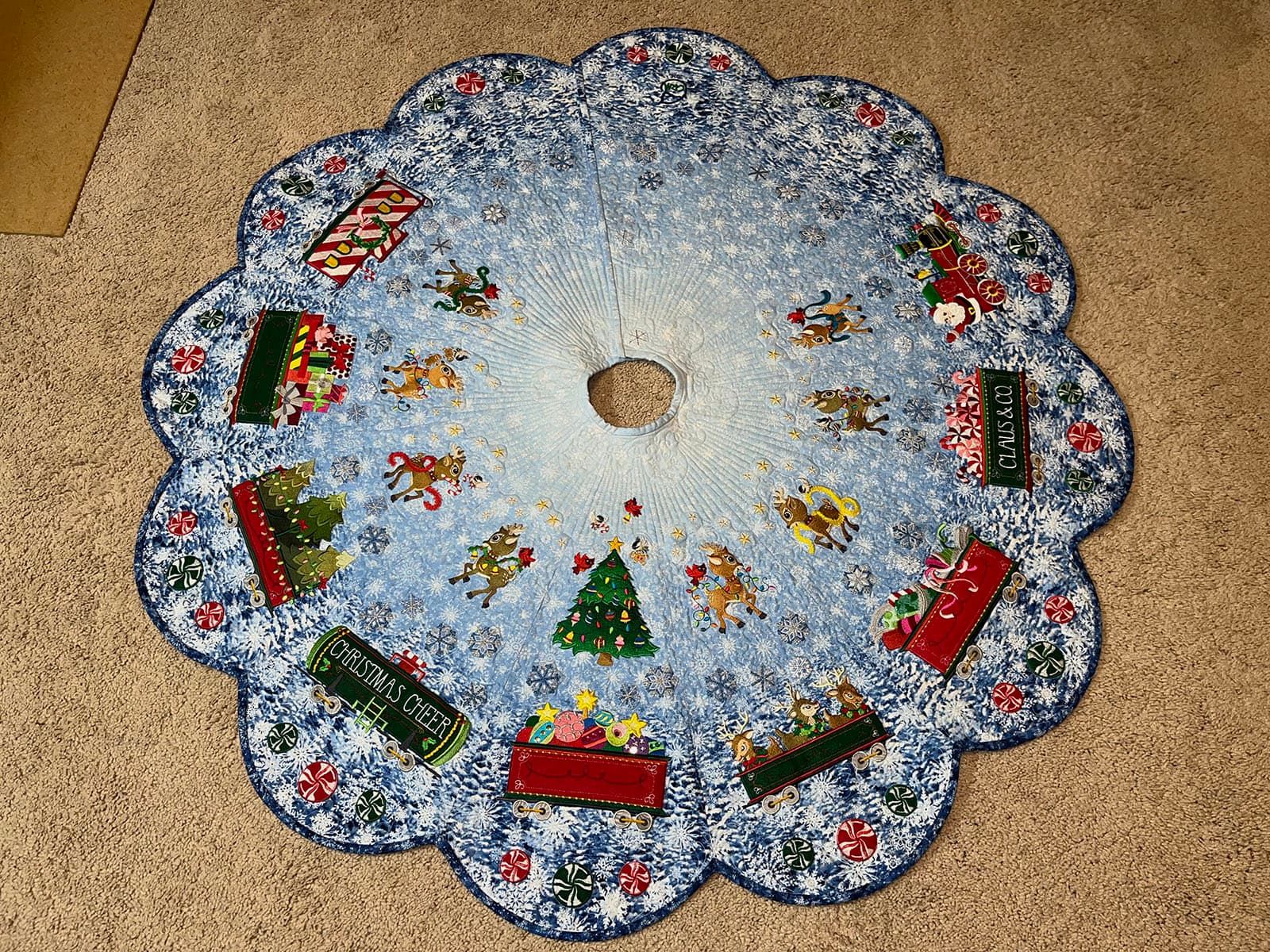

I did a (non-geometric) meandering stipple (in addition to the feathers and the snowflake collar). It nicely tightened up the look without competing with the main elements.
Greetings. That is just lovely! The stipple is absolutely perfect to unite everything without overpowering. I love the snowflakes! But then I love all the other elements, too. Beautiful design and gorgeous execution. :muscle:
