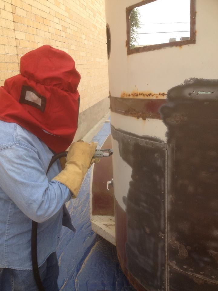

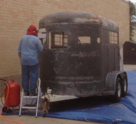

Never say never: I helped sandblast a horse trailer at the Ladybird DMS location back in the day (May 2013).
IMG_7070
