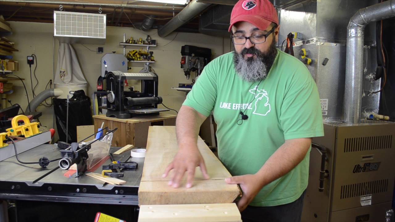

I have a sled that I made for the planer. It basically makes the planer work kind of like a jointer. It’s MDF and has a heel on one edge. You just get it as level as possible, wedge it in and hot glue it to the board then plane it. Once the top is flat you can pop it off and plane the bottom as usual. Let me know if you want to go that route and I could probably run it over to the space this week around lunch. If it wont be in the way, I’m fine with leaving it up there for anyone to use.
I’m not following. So it is basically a piece of MDF and you try to get your board adhered to the MDF where it won’t move, then send your board through? Do you use shims to get your board where it isn’t moving as the slab I am working on has some decent warping. Unfortunately my slab is about 12.5 inches wide so just too big to go through the jointer.
pretty much like this… except the back heel is just glued, not screwed. I did some pecan that was all kinds of twisted, worked great.
Love it! I think that is the easiest option. If you are willing to take it up there tomorrow I will go after work and get this slab flattened. How long is your sled? The board I’m working with is a little over 8’, so if it isn’t that long I’ll just stop by a big box store and pick up some MDF and make one myself.
It’s probably about 5’ long, it probably wouldn’t work for a slab that size. Grab some MDF and make one. It would be ideal to have some room past the end of the slab so you can wedge all around it. But it it’s not too twisted you can probably get away with an 8’ board. You might get an extra set of hands too. 8’ of slab and 8’of MDF is going to get pretty heavy. Good luck!
Any specific reason to use MDF over plywood? Just curios as I have some sheets of plywood already that I could possibly use.
Nope, anything that’s super flat should work. I’d make it at least 1/2" thick or it will bow and pop the shims off when you pick it up.
