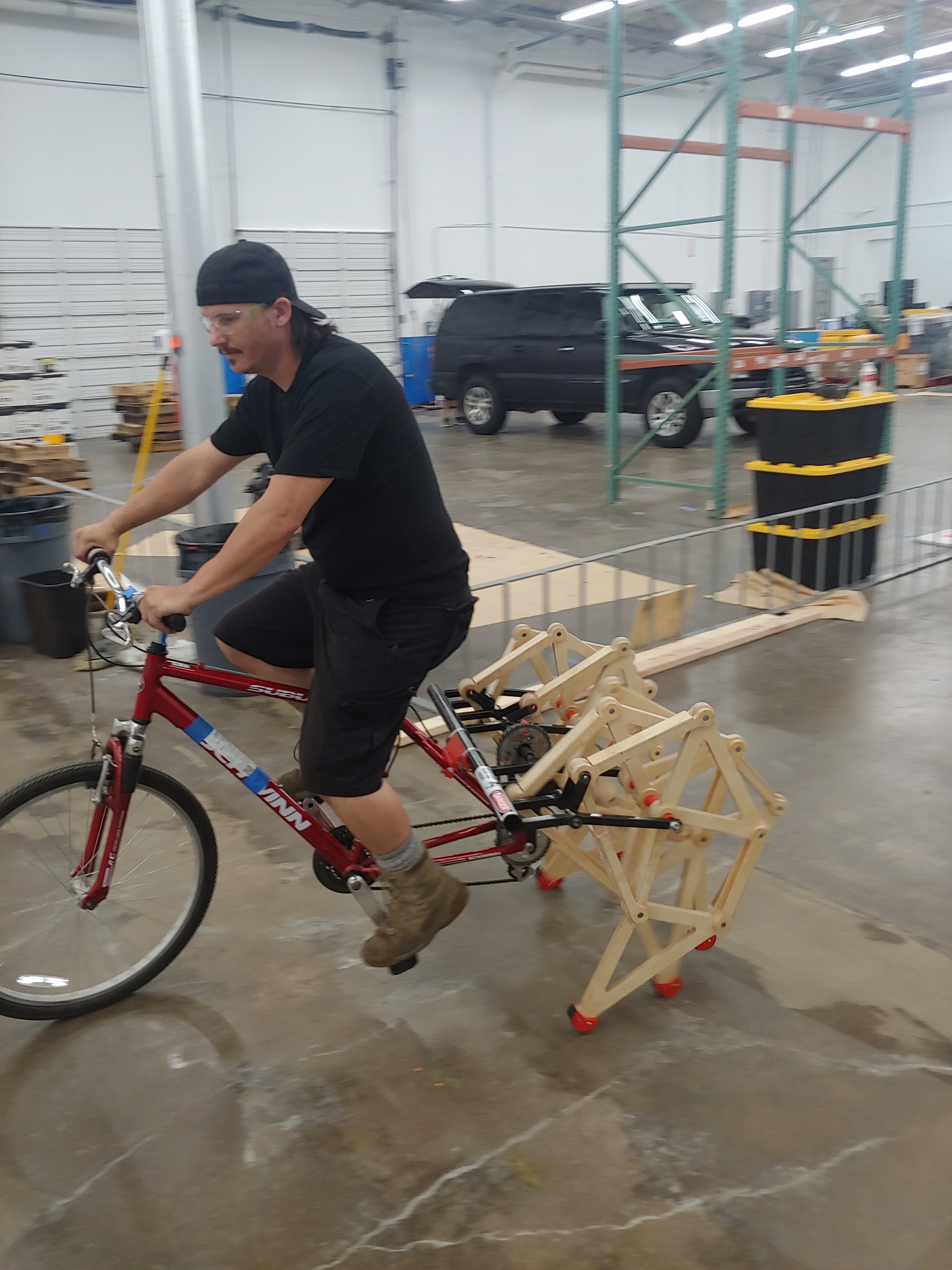

Alright I’m good to go. So cool for @Brandon_Green sharing it with everyone. Thank you sir, you are a master builder.
It’s just stored in the warehouse of 102 for now so members can access it and give it a go anytime. It’s got a sign on the handlebars saying the cost to ride is simply sharing a photo/video of your ride if you can :slight_smile: It’ll stick around until people lose interest or it becomes a problem.

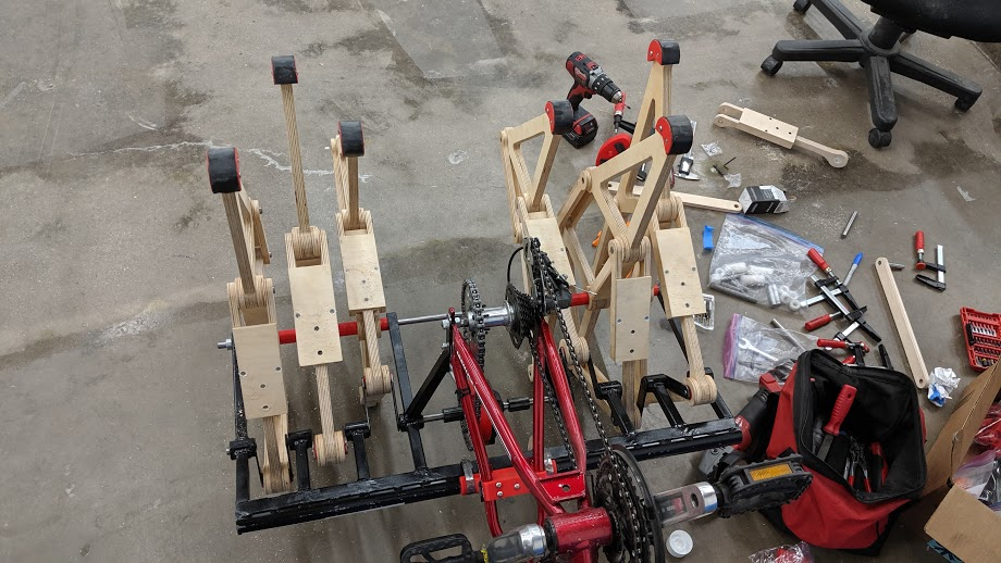

@Brandon_Green A joint on one of the legs came unglued.
Ok, thanks for the heads up Bill, I let him know. Could you put a sign on it that says out of service?

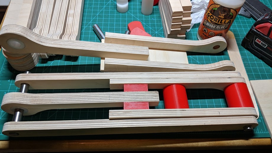

I’m going to guess it was this piece that broke, sending the entire force as just a shear load through the top veneer of the plywood probably wasn’t a great idea.
Can anyone confirm? I have a couple extra linkages I could start gluing + bolting together
This is the joint which broke. On the middle leg on BOTH sides.
So… can we rent this thing for an event?
Repaired with some screws
