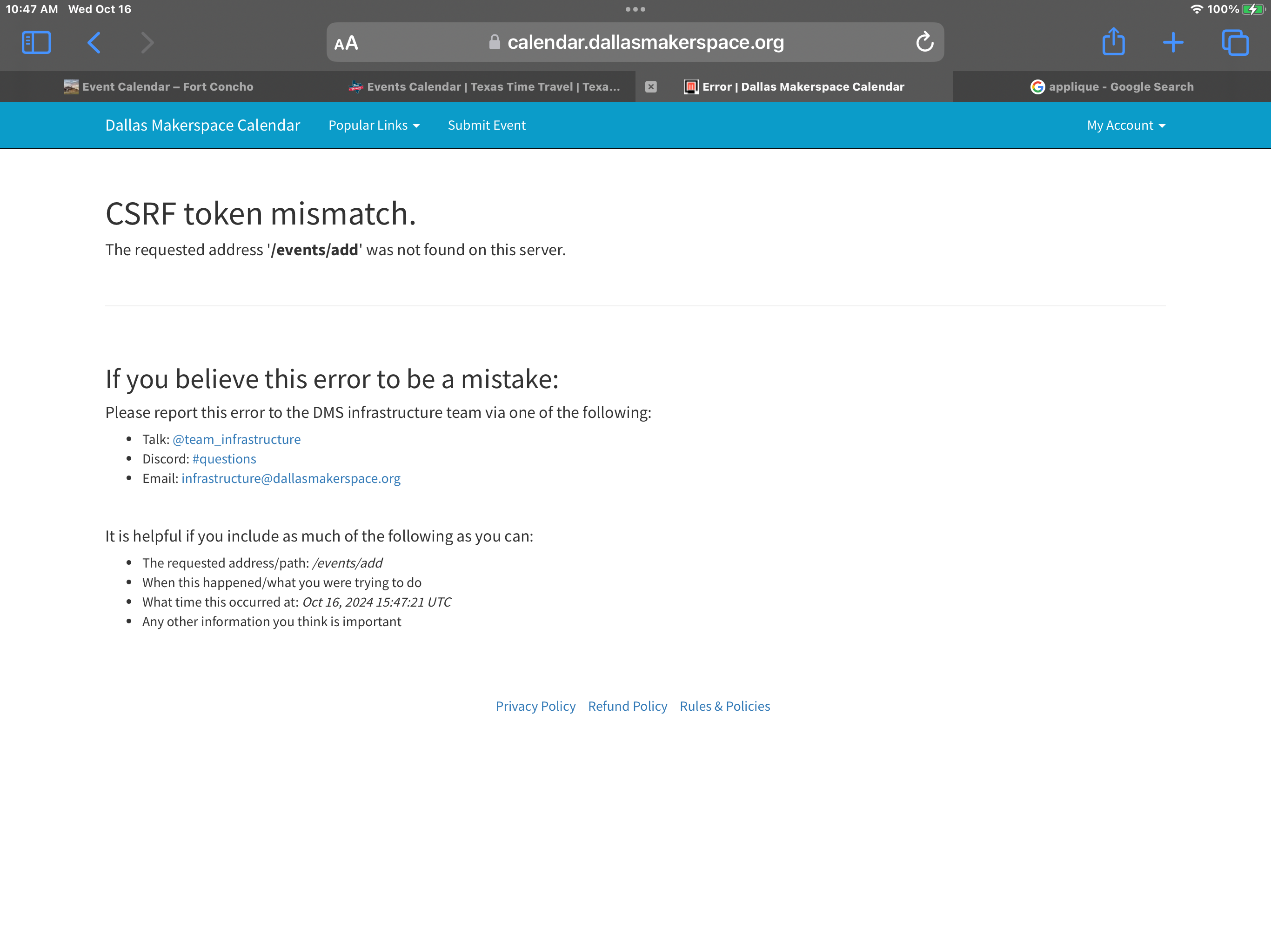

I am attempting to submit a class and after filling out all the spaces and hitting “Submit” at the bottom of the page, the program appears to be working, says”working”, and then the error code comes up. Please see photos. When I go back to look at the form, the class date/time has been deleted. Can someone who is much more knowledgeable about all these IT mysteries fix this, please. Thank you.
A CSRF mismatch on the calendar usually occurs when the back button was used during submission of an event, or if a plugin/extension removed required cookies while trying to submit. (I believe that there’s also a case where if your IP changes in the middle of the session it can occasionally cause this)
If you haven’t been able to get it to work yet, you might want to try a different browser or incognito or something and see if that fixes it.
I have closed the Events page and reopened it, changed my Google setting to “private”, and retried—all get the same error code. My husband is on his computer and has been for the previous 2 hours. We both use the same network and provider and there has been no disruption, no error codes to his work.

For future reference, this was due to the attachments (images) being too big (larger than 8MB).

Thank you for all the help. I finally got it submitted after blacking out 2 of the example photos. (:frowning:They were so pretty). Oh well, I did post them on the sewing section of discord, so all is well.
Hmmm interesting I swear that this was a bug I fixed before I left but maybe I never actually passed it through :confused:
At the very least probably needs some verbage on the file upload button about file size(s).
