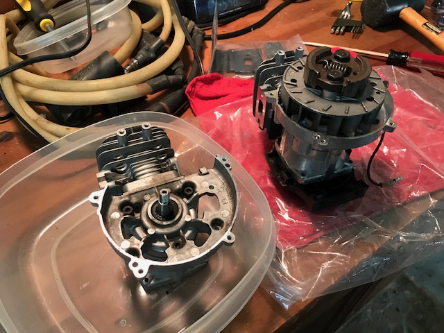

New shortbloc arrived today, and I’ll tear into it with my 8yo son tonight :blush:
Will pull the head once the swap is done. I’m realizing now this will be at least the second engine on this one…

IMG_1389
The transplant is complete and it’s running like a champ!

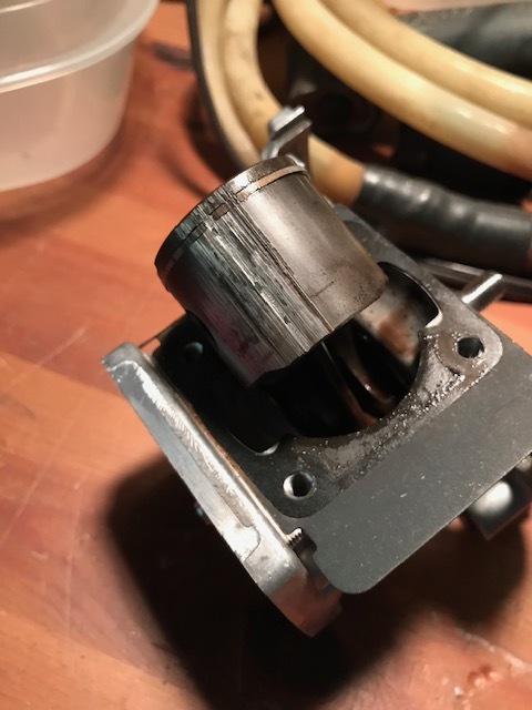

Pulled the cylinder head off the old engine and it’s obvious what caused the compression loss. Piston ring appeared to be intact, so not sure what caused the scoring on the piston. Since it was on the exhaust side, I wonder if something worked it’s way in past the muffler…
Thank you again to all who provided guidance and troubleshooting ideas. If you’re keeping score, ‘loss of compression’ was the winning answer.
Nice necrotopsy!
(and congrats on the surgery success!)
