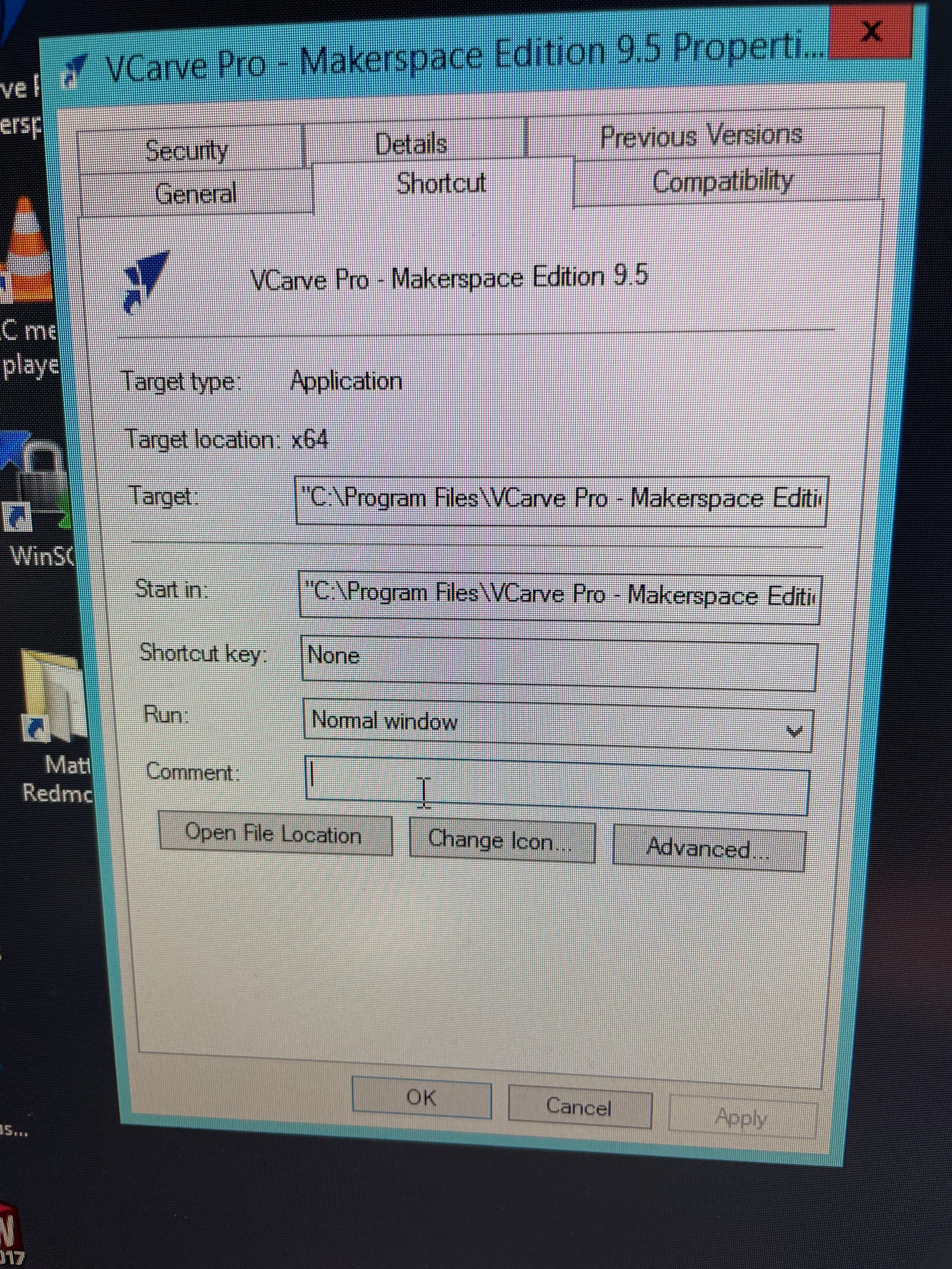

I just logged into the jump server and VCarve Pro 9.5 launches just fine.
Here is what the desktop shortcut launches:
I get this
and then it takes me to the vcarve home page
V9.x is deprecated.
