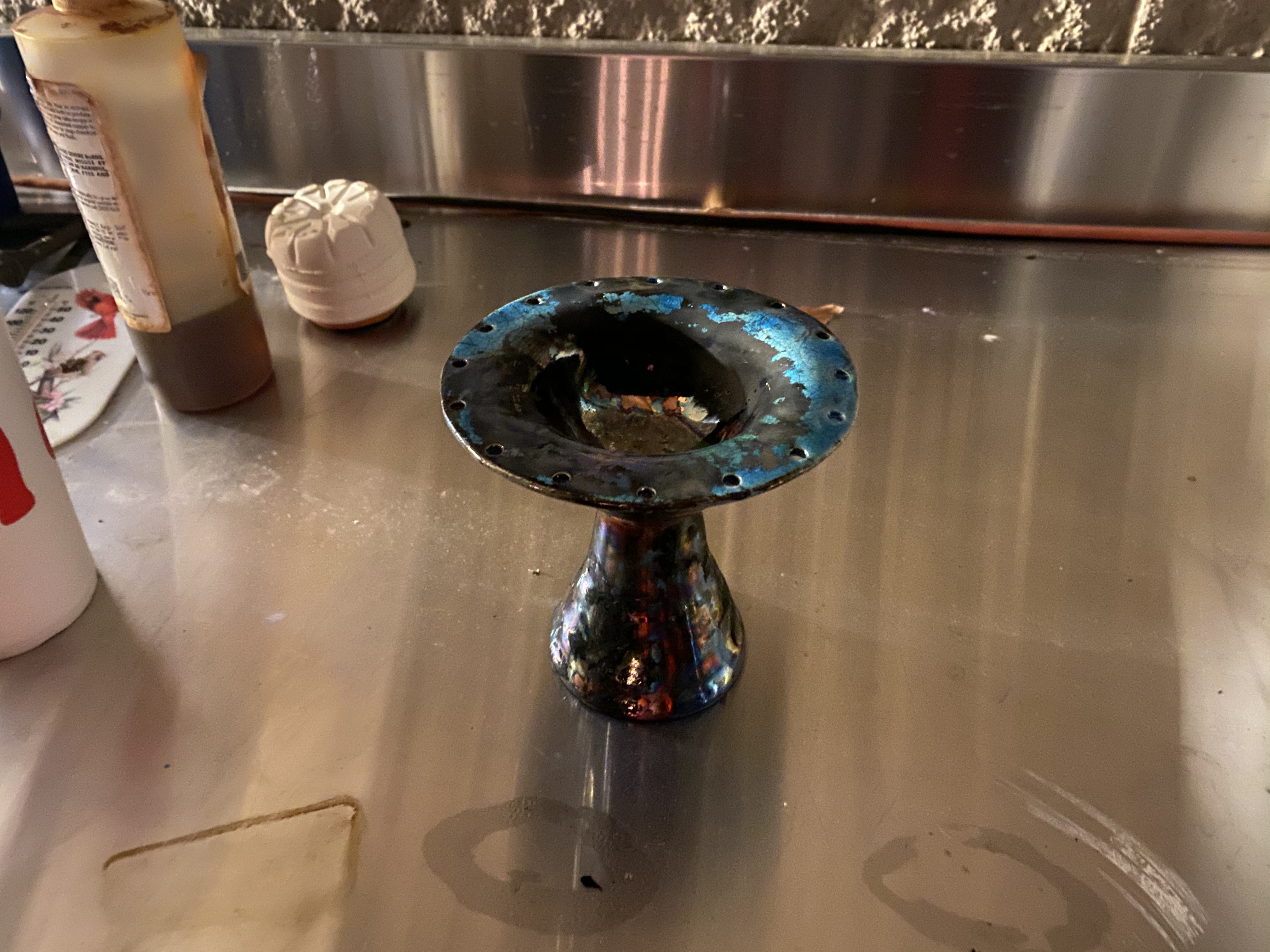

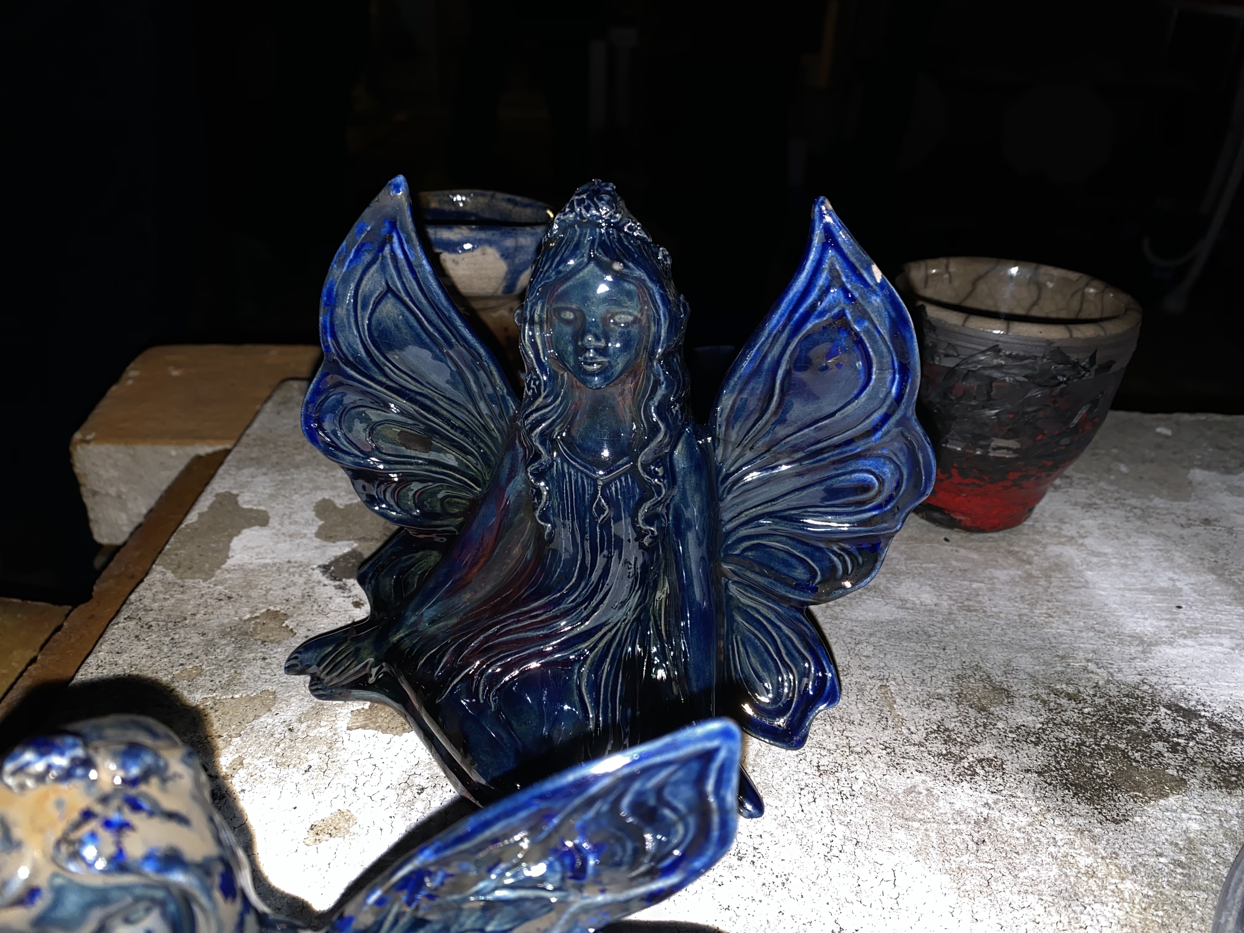

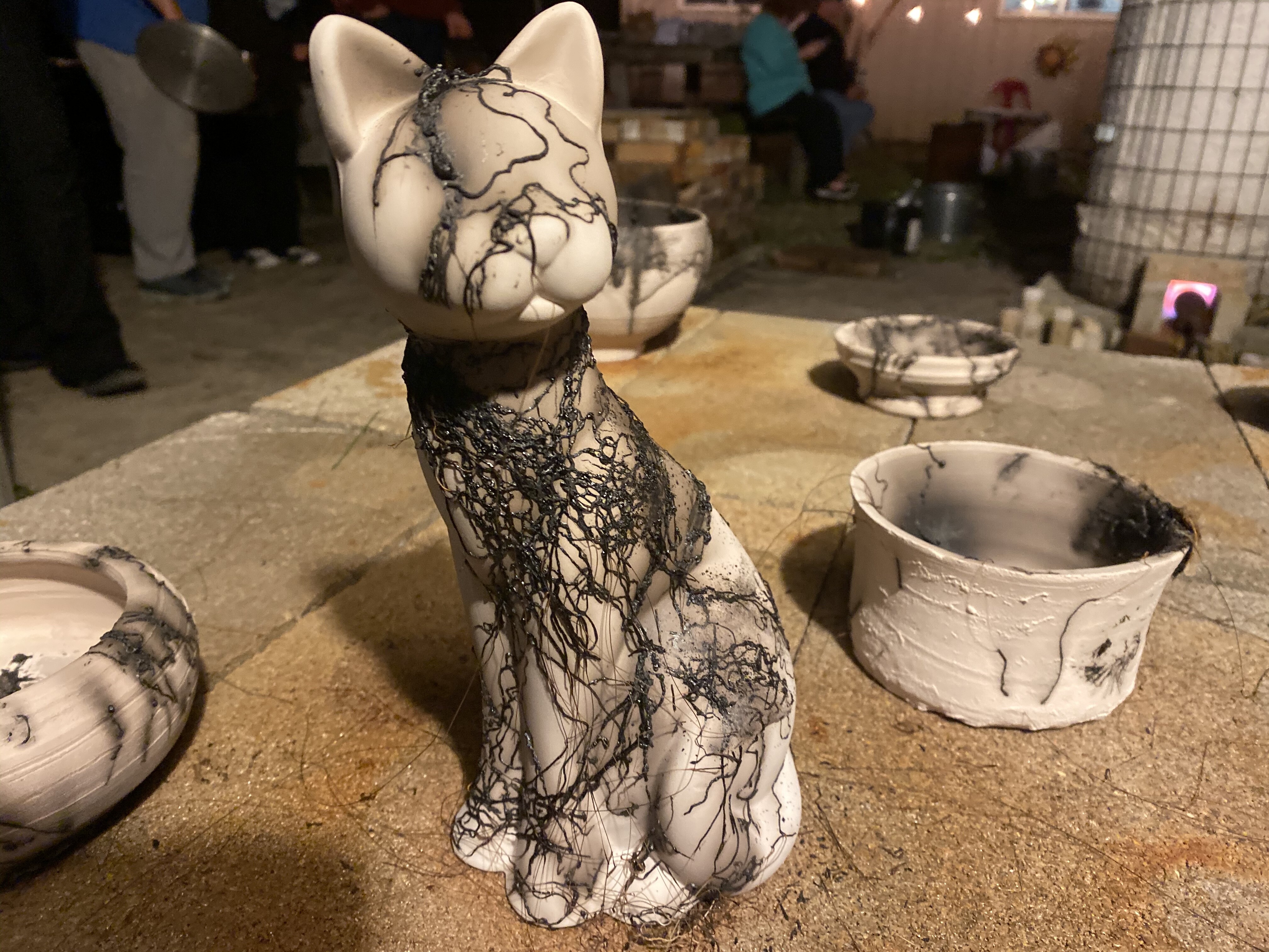

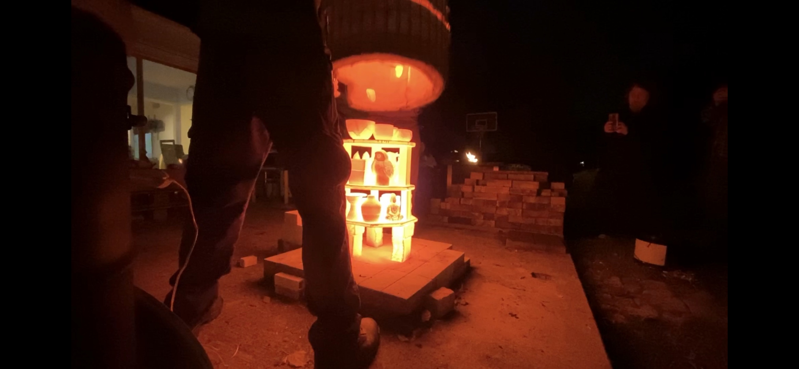

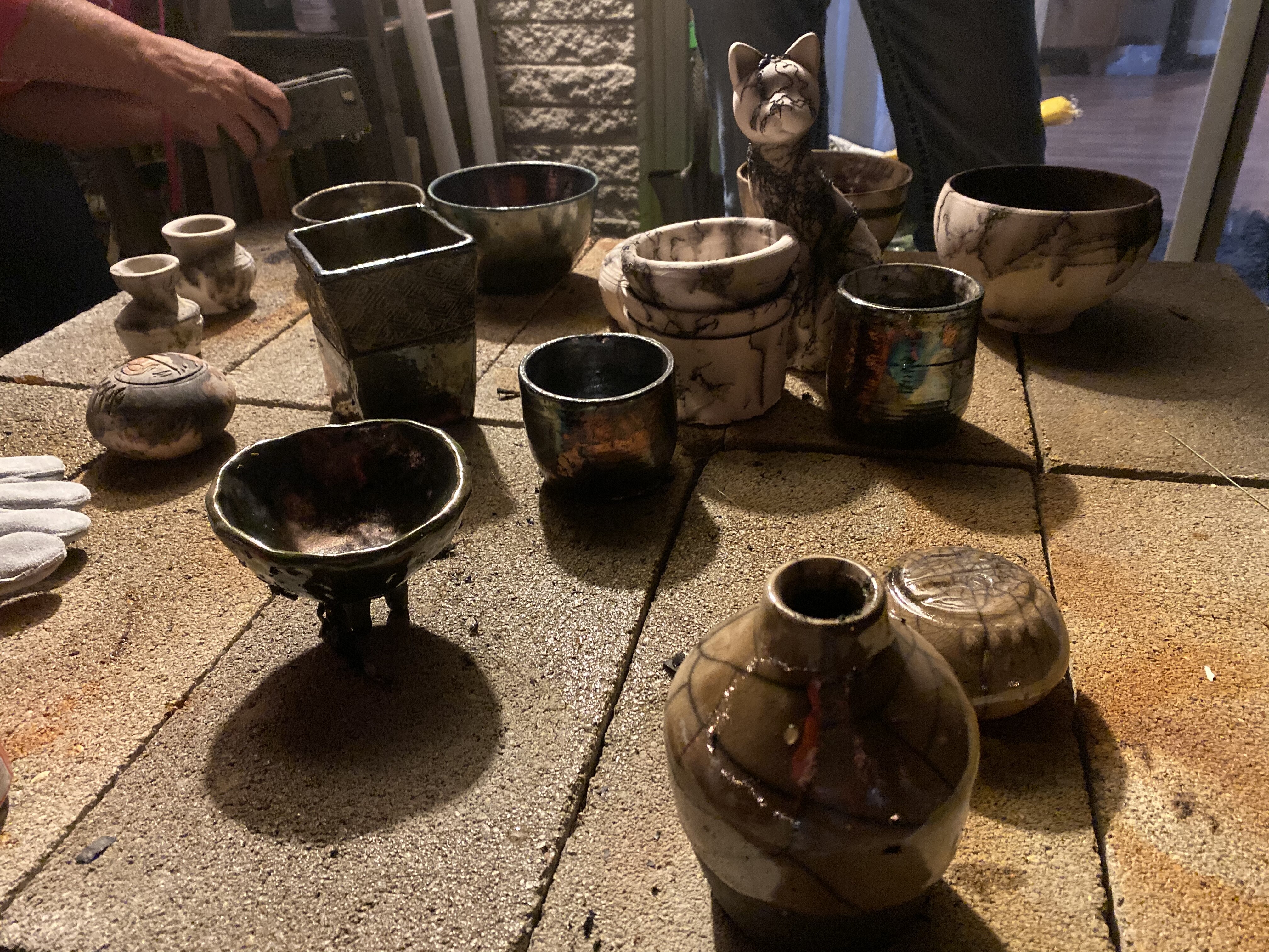

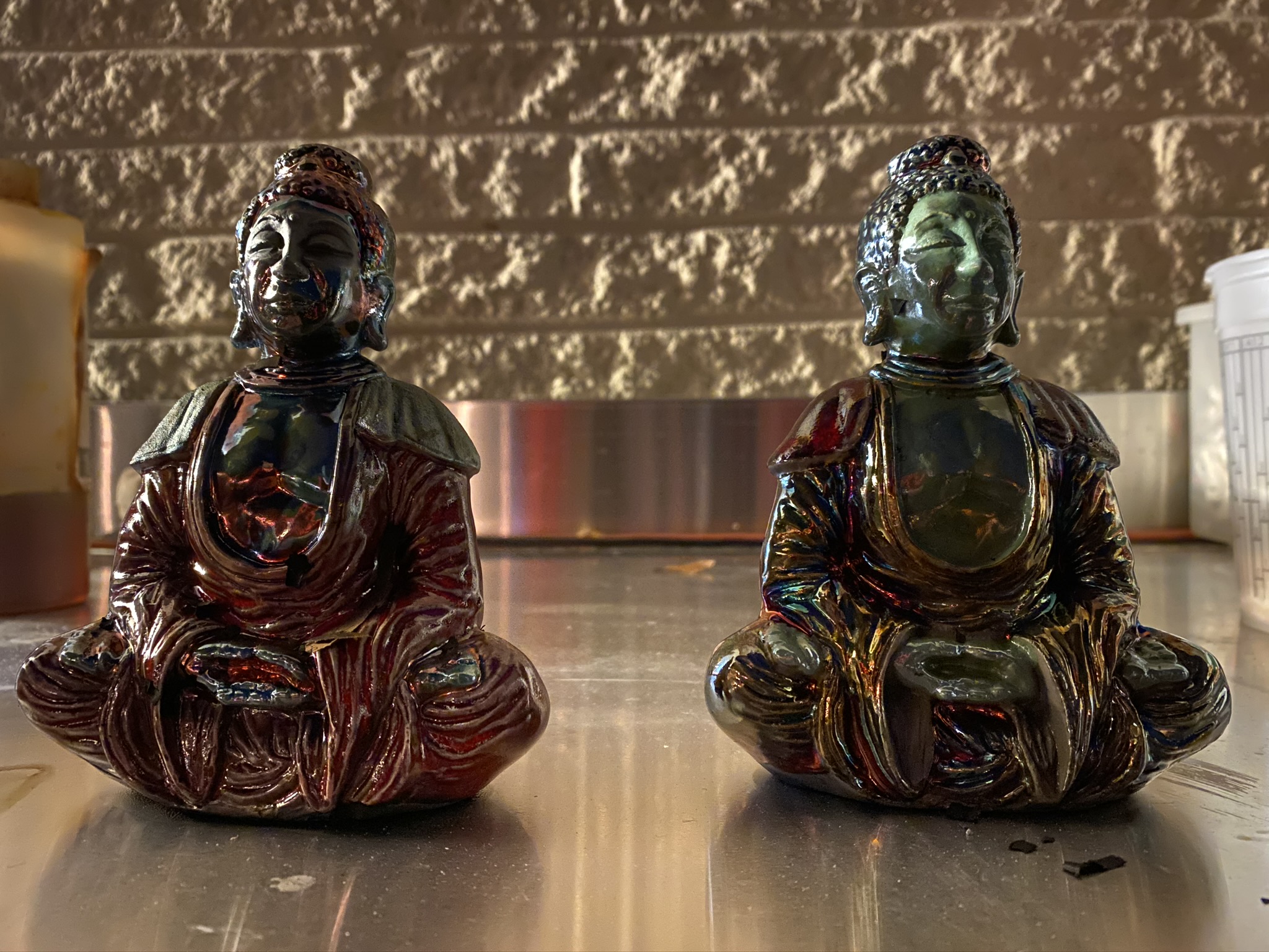

A few pictures from a past Raku event.
Gorgeous pieces!
