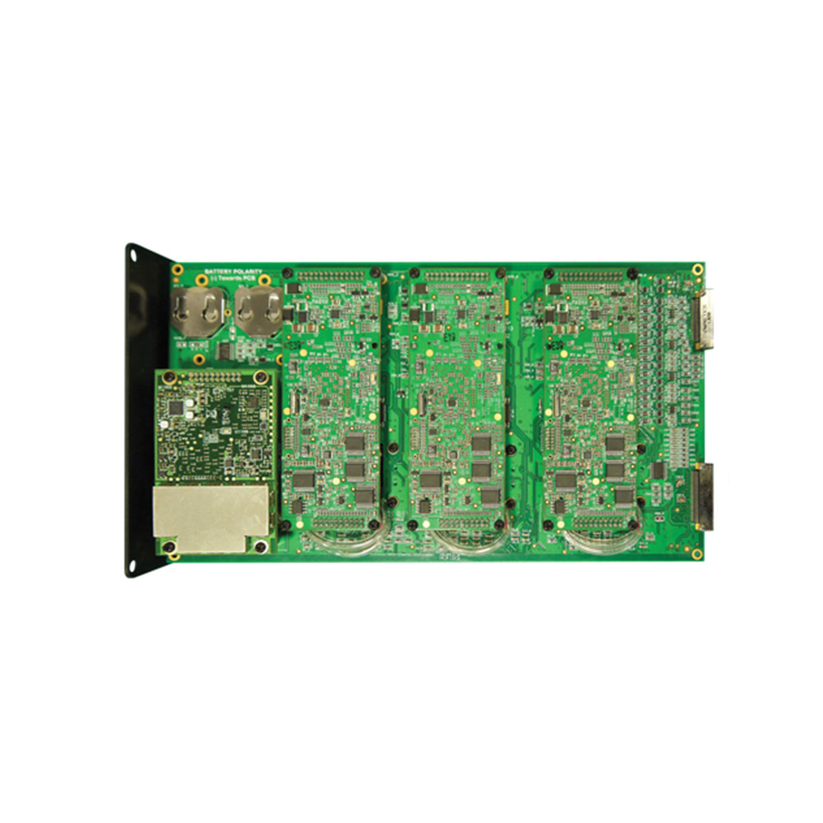

Yikes. PixHawk, DJI, and other hobbyist autopilots don’t have redundancy. Given the payload is going to be a human I think that’s an important factor. Prepare for sticker shock.

1st, I wouldn’t spec a “hexacopter”. If you have ever seen a hex try to fly with a single motor failure, you wouldn’t want to be aboard. An octocopter is the minimum config for human cargo. 2nd, @lukeiamyourfather is right about redundancy, if you ever plan to board your machine, you HAVE to have a failover system controller.
