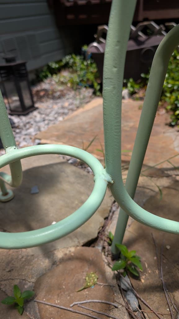

I was lazy and went over the paint/rust on this. It’s been outside for about 2 years since I coated it.
