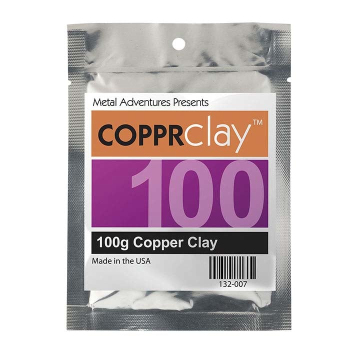

I posted a link above for 100gr pkg of copper metal clay from Riogrande.com. I love ordering from them ;). It’s fun to play with :). I’ll get back with you and we can set up a time :slight_smile: !!!
Cheers!
You can order smaller and larger pkgs of the copper metal clay also of course :wink:
